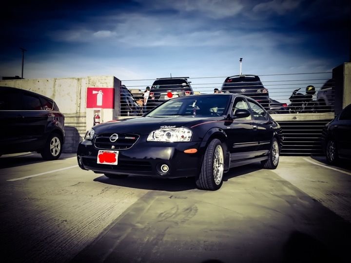

So completed a project this last weekend! I finally made a set of foglights that are projectors with halos, for a price cheaper than most OEM foglights cost you! These are specifically for the 5.5 gens, though I don't see why it wouldn't work for virtually any car ever!!

below is the picture of mine on my car!

any pics of progress? or close up?
nice work and effort. props for doin custom stuff
I will take some close ups later tonight and post them.
Unfortunately, I didn't take any pictures while I was doing them, as I was hurrying to get them together for a show last weekend!
