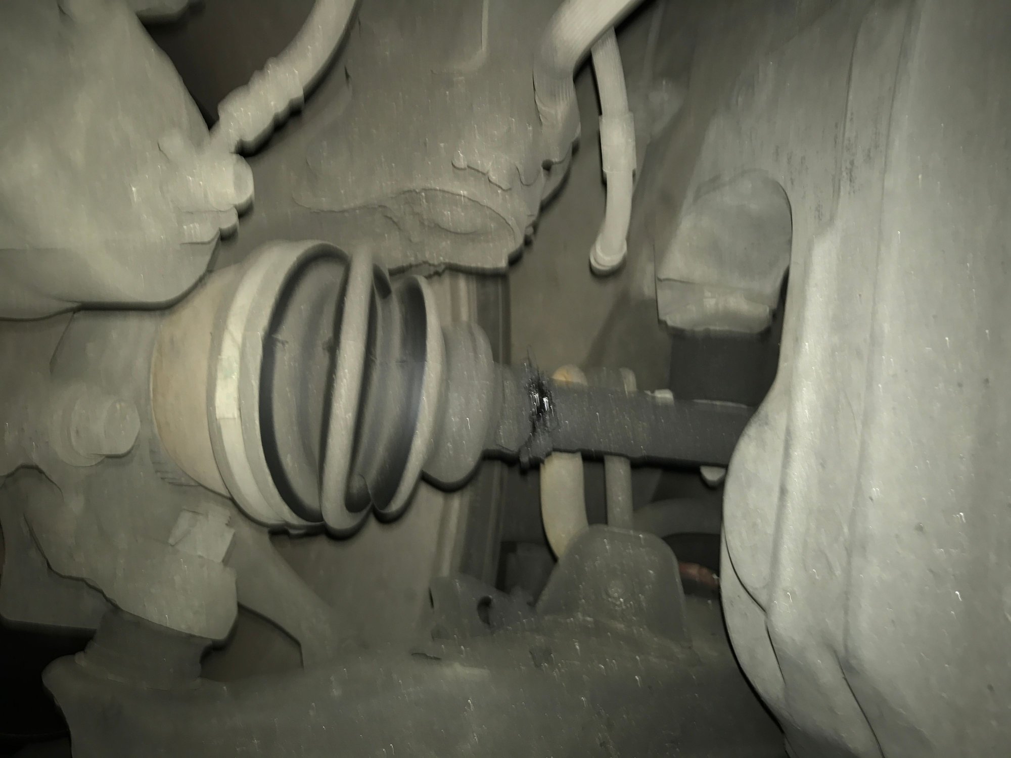

Hello,
I have been experiencing some vibration on acceleration, and a mechanic confirmed this afternoon that my front passenger side CV Shaft (is that the axle?) is wobbling, and needs to be changed for about $400 (parts=$160 & $220 labor).
Is this a DIY job. I am getting better at fixing my car, and just finished a complete brake work (calipers, rotors and pads). So, would I be be able to do this myself?

From what I've read here, aftermarket CV axles don't go so well with our cars. You end up with some kind of funky vibration.
What're you left with?
- Getting a low mileage OEM one from Ebay.
- Local rebuilder
- Raxles (which may not even be available anymore)
- Nissan Advantage axles. A guy in a recent thread said these Chinese axles from Nissan vibrated the least out of all the aftermarket ones he tried.
- Roll the dice with any of the brands you listed.
EDIT: Here's the thread https://maxima.org/forums/5th-genera...-cv-axles.html

It does seem to be a roll of the dice. In my case I replaced 4 axles on my Maximas and bought them from Napa Auto Parts. I used the Napa house brand, new, not re-manufactured.
If the axle has a split boot and isn't vibrating or making noise yet, I would buy a boot kit and replace it. It's a messy job cleaning all the old grease out, but it isn't hard.
I have cheap reman axles on mine as well. One from Autozone and one from O'reilly. I had one bad one from Advance, but it was noticeable out of the box. Aftermarket can always be a crapshoot. But it's so much cheaper.
I used Napa remans for both my axles. If you're lowered, don't even think about reman ones, they will wear out fast. If you're stock height they should last. I went with Napa because they offer a lifetime warranty (keep the receipt) and were no questions asked when I had to use that warranty.
It is a DIY job, did both of mine, take a look at some videos on youtube of it and see if you're comfortable with the process, will be a bit harder than a brake job just because of more difficult access. The hardest part of mine was removing the seized lower ball joint bolt. You might be able to do it without that but it's hard to get the axle out if you don't. You will need a 32 mm bolt to break the axle nut as well, and AutoZone has one on loaner I believe.

After a couple months with the Nissan Advantage axles, I'd recommend them over the rest of the aftermarket, but would go with the SurTrak from Rock Auto if cost is a factor as the Nissan Value Advantage aren't much better than the SurTrack, and SurTrak is half the cost. In terms of whether or not it's a DIY job for you, I'd follow the previous advice and check it out on youtube to see if it's something you are comfortable with first. It's not much harder than a complete brake job, but the passenger axle job is a little harder in that the axle nut has to be removed and reinstalled (which can be a challenge as it torqued to 250 ft/lbs) in addition to many more components being disassembled (axles nut, brakes, rotors, carrier bearing, etc..). Also, the passenger side axle carrier bearing nuts are a little hard to reach and access as space is constricted, so there may be a challenge there as well. I also found that a stubby 12mm ratchet wrench helps with removing and tightening those bolts.
The only real problem I had was the axle was rusted solid to the bearing carrier. Destroyed the axle getting it out. Luckily it was already broken and being replaced. I now have a favorite jar of anti-seize!
Ok. thanks for all your responses. Given all the caution about getting aftermarket axles, I will want to be really sure that mine is broken before I ditch it. All i have is vibration when accelerating from a stop. The mechanic showed me the movement / play / bump on the axle as the car accelerates, but I am not sure what is causing this behavior. So, I want to check if indeed the behavior signals that the axle is broken or not.
If indeed, it is broken, then I will get either the Nissan Advantage or SurTrak version. I've . been watching a lot of youtube vids and think i can handle it - I am looking for more of those done on jack stands though - since that is what I will be doing.

This is a DIY project, and out of 10 being the worse, to me it's a 6. The axle nut uses a 32 or 33 socket. Get a tube iron as leverage to loosen. By memory from doing mine on the 05 and 11 with parts from NAPA:
Remove wheel, brake calipers
Remove axle nut
Remove speed sensor
May have to remove the tie rod for axle access
Rubber hammer to tap hubboff out axle splines
Remove three 10 or 12 mm bolts where axle sits into transmission case
Use heavy duty screwdriver to pry back and release inner axle spline teeth from tranny case
Will lose about a cup of tranny fluid
Measure OEM axle against aftermarket to make sure hey line up properly
Carefully insert new axle in reverse order - a make sure axle is all the way into tranny case and should not take much effort to slide in.
This job would take me about 45 minutes
Oh, any refurbished axle will work, with preference from NAPA, Autozone, then advance auto -- in that order.
If you have to bang the crap to loosen, then double check to make sure you removed all bolts. If you are clear, spray liquid wrench around the sealed areas and let soak for about 10 minutes. Use rubber hammer to tap the sealed areas to help liquid soak into those rusted areas
Good luck and go for it. Get some good reachable tools to get the job done

If you're doing this without air tools the axle nut can be a challenge. Get a 1/2" breaker bar with a pipe to lengthen it. You can break a regular 1/2" ratchet doing this. The problem can be that pulling on it can jerk the car around and take force off the actual nut you're trying to brake free.
The trick is to remove the wheel, remove the center cap and reinstall the wheel. Set the car back down and set the e-brake or put it in park if it's auto. Now when you go to break it free you have a stable platform to pull against.
The nut will be either a 32mm or 36mm. could be either but probably 36.

I usually place a screwdriver into the gills of the rotor and have it locked against the brake caliper. A tube bar for extra leverage, and close to horizontal. Then I would have someone hold the steering wheel from turning while I stand on the pipe bar.

The vibration is probably from warped front rotors or possibly worn tie rod ends.
I don't see any reason to swap it. I'd still put a new clamp on the boot and keep going. It's very rare for an axle to fail and leave you stranded. Even one that's clicking, vibrating or has a torn boot will still work for thousands of miles.

I just replaced my CV axles. This is my 2nd time around, so here is my axle story:
- 11/23/2013, at 116,700 miles: The boots on my OEM axles were torn. No vibration, but both axles were beginning to click. Because other suspension work was being done on the car, I had both axles replaced with new SureTracks. We had big problems with one of the two new axles right out out of the gate - there was a big "clunk" when shifting (P->D, D->R, etc.). My mechanic returned and replaced the offending axle free of charge. Even after this replacement, the driver side axle always felt a bit loose, and within 3 years started vibrating badly when accelerating in left-hand turns. The boot on the passenger side axle cracked some time in mid-2016. All this lead to the current/latest replacement.
- 4/25/2017, at 141,200 miles. Replaced both SureTracks with new FEQs. I just got the car back, and at this time, there is an amazing difference: no vibration, the car drives smooth and tight, and it feels like a new car.

Not sure where my mechanic got them; perhaps from Advanced Auto Parts, but that's just a guess. Charged me ~ $770.- for parts, labor, and alignment. He guarantees his work and the parts he provides for a year, so I took him up on it rather than buying parts myself and having him install them (there would be no warranty then). Besides, after doing a lot of research here and elsewhere, I could not come to any conclusion re. which axles to buy.
One more thing re. my new axles: No more clunking when downshifting 3->2.
I was getting afraid that my transmission is getting sick, but all those issues are now gone. Smooth as butter - so I can only conclude that all the clunks were caused by my axles.
