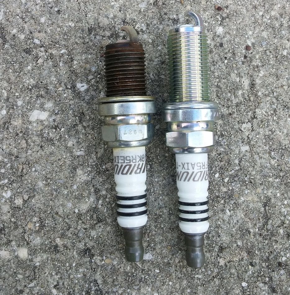

So what kind of damage could putting the wrong spark plugs in do? I accidentally grabbed the spares for our 3.5 and put them in the 3.0. It crushed the electrodes down but not far enough to crush the insulators. I tested it with an extra plug and it probably took a pretty solid 20-30 pounds of force to smash them like so. Here's a pic of one of the plugs that came out.
I sent a scope down the cylinder and checked the pistons. Just a little nick of carbon off the top.
comparison of 3.0 and 3.5 plugs
electrode smashed by piston
Stupid mistake on my part. Was rushing to get it done before work and screwed it up. I'll jump on the laptop and upload pics of the pistons if I still have them on there.
EDIT: Negative on the pics of pistons. Only saved pics of the 3.5
