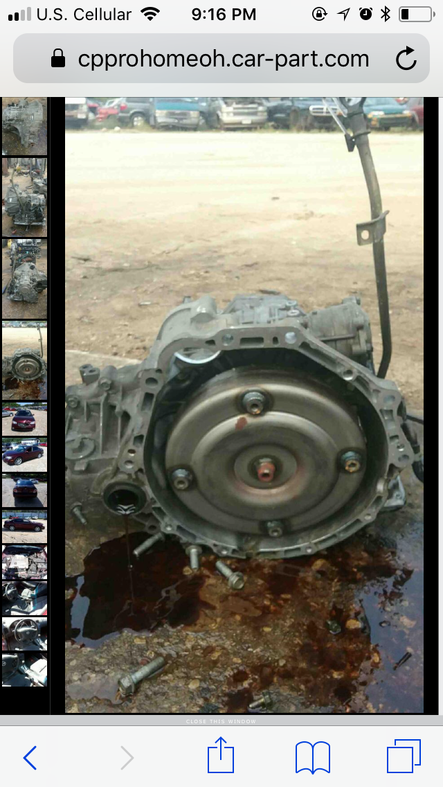

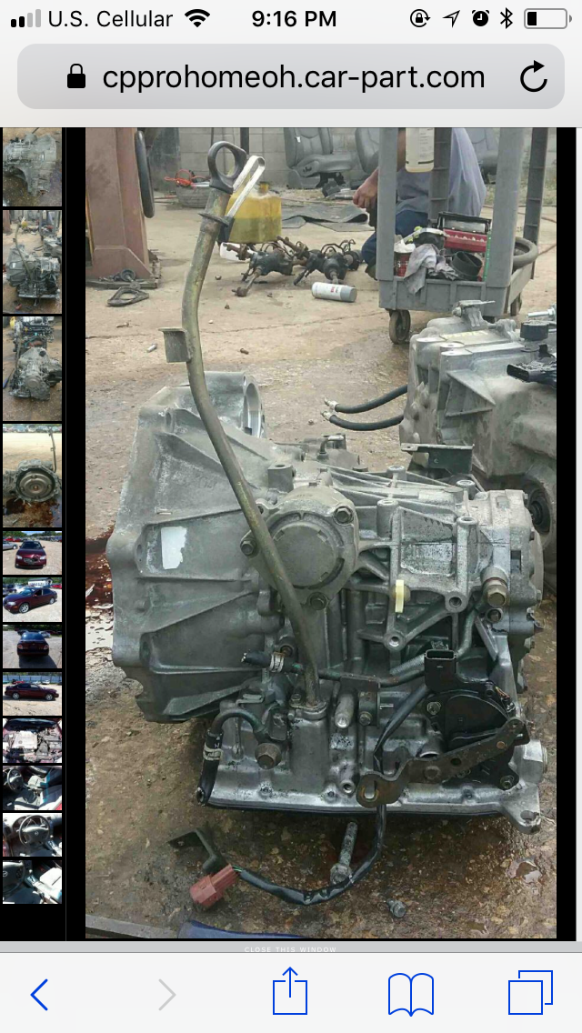

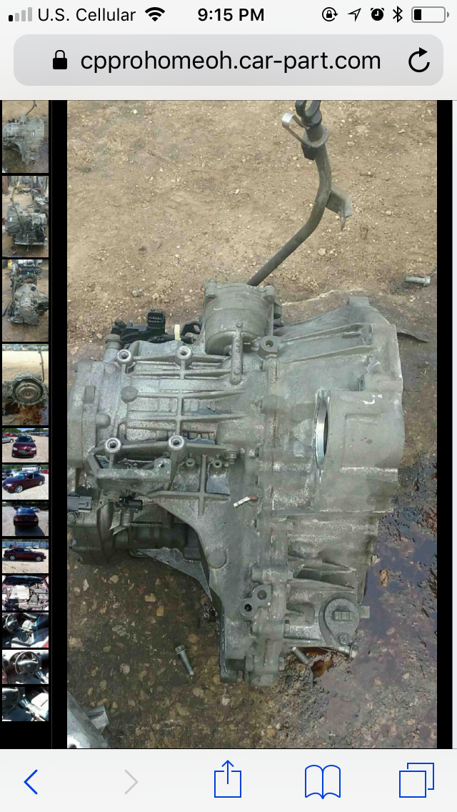

I have found a transmission 42 miles from me, 87000 miles, does NOT have traction control (neither does mine), and only $175. It couldn't be more perfect. I plan on buying it next time I come home from college and then keep it in the basement until January when I won't need the car and can have it swapped in. Here are some pics of it:
