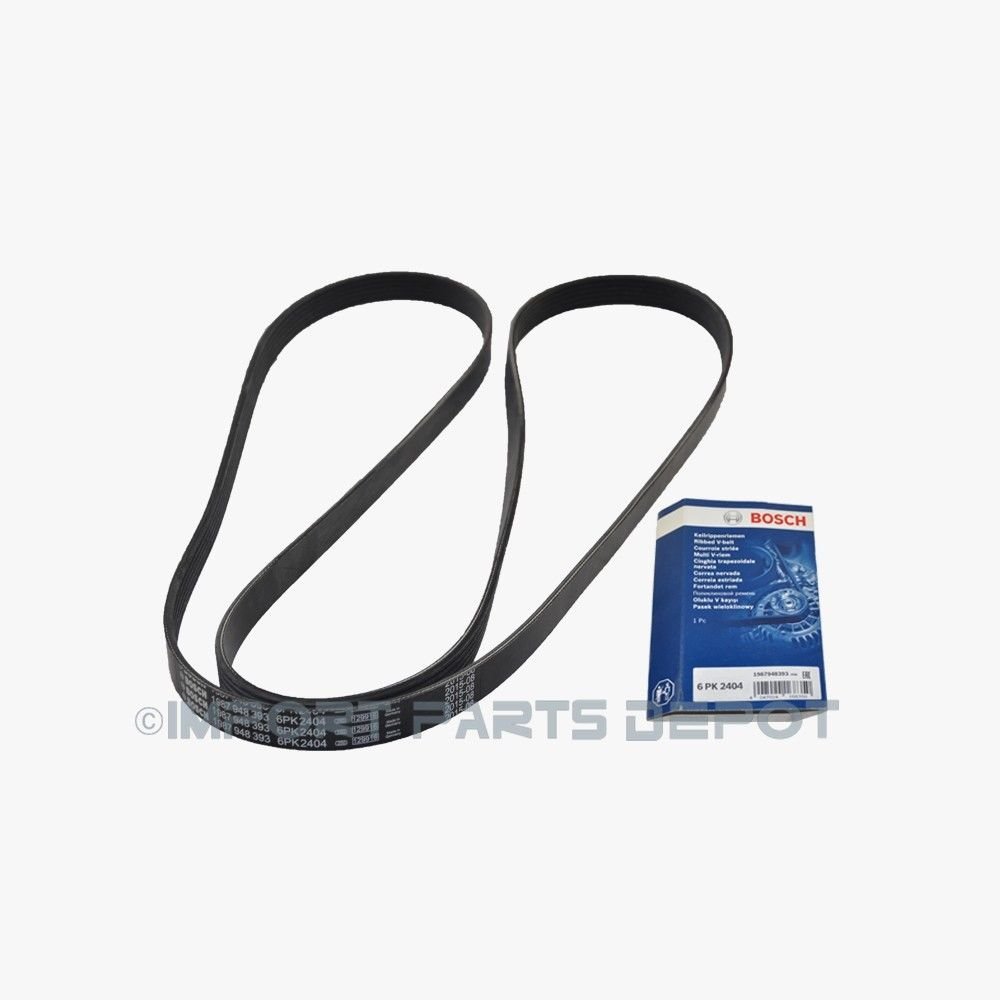

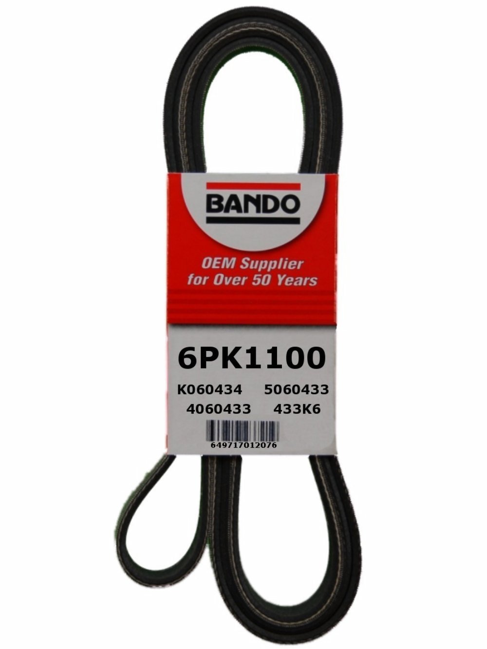

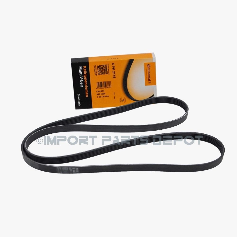

With all due respects, I don't believe that they get their belts from the dealer. Did the little cardboard holder piece say Nissan on it? And did they ever measure the belt or offer to?
Is there another parts store near you other than Canadian tire? I think you ought to try them.
There are a lot of 3rd party belt manufacturers and many of them print the size of the belt on the cardboard holder. There is a standard for expressing the size. For example, the belt the Maxima should use is 6PK1100. The 6 means how many ribs are in the belt and the 1100 is the length in mm. I forget what the PK stands for. Other sizes include 6PK0900, 6PK0920, 6PK0960

Hey, I really appreciate the help I honestly never knew that about belts must have skipped that class that day. I assume it might be a 6pk0950 I know theres a part source some where around. I'm starting to assume the alternator has the wrong pulley. when I get my car situated I'm gonna get one of those high amp ones or a Nissan quest alternator. I'll keep you guys posted on Wednesday I'm off work.

Hey guys, sorry for the wait It took me been real busy.It took me four trips, and plenty of bus fair but I finally got the belt on with aboslutly no squeaking, the car runs super quite. Thanks for all you help, it turns out the belt size I needed was a 6pk1085. I learned that you can't always take someones word for things when you see, and know with your own two eyes something is wrong. shout outs to @DennisMik he knows his stuff.
