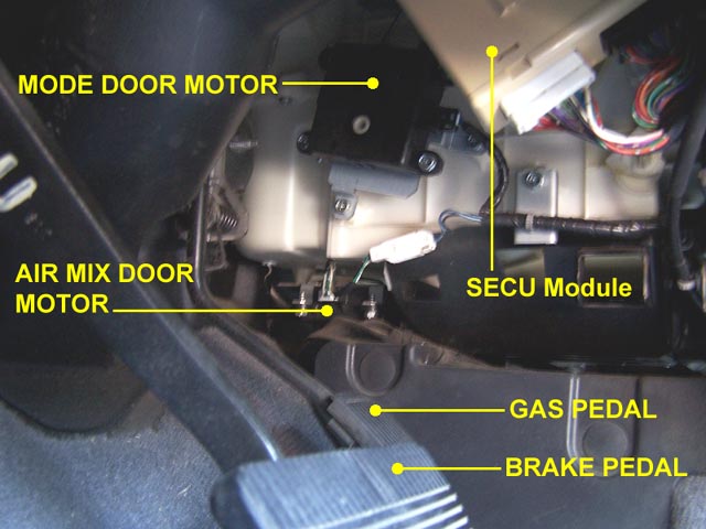

Nissan does not use the term "blend door". The Nissan equivalent is the AIR MIX DOOR, which is responsible for the air temperature.
Your problem is with the MODE DOOR motor or the control panel itself. There is a troubleshooting guide in the service manual, section HA, to figure out if the motor or the control panel is at fault.
Link to service manual - http://boredmder.com/FSMs/Nissan/Maxima/

Thanks for the link and the advice. I checked the mode door motor and noticed that the arm that regulates the vents does not move at all when I change the button modes on the climate control. I'll change that piece this weekend and see how it goes. Thanks for the help!

So I went to the local junkyard and got the mode door actuator. Of course it not guaranteed to work so disconnected the old one( still mounted) on the the new one and the arm moved to the same spot as the old one as if the computer knows when it needs to be. Good news: it works, bad news: still in the same spot(blows top and bottom). Last resort was to disassemble the center console and check connections to the climate control. I disconnected all the connector of the climate control and turned the car on. Reconnected the climate control and now it works. Tried it a few times before I re assemble the center console. Somehow I was able to troubleshoot it so that the modes work.
Wrote this info in case anyone is in the same situation.
