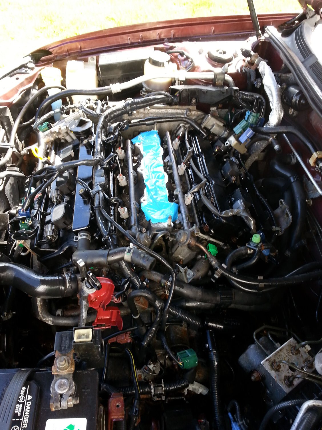

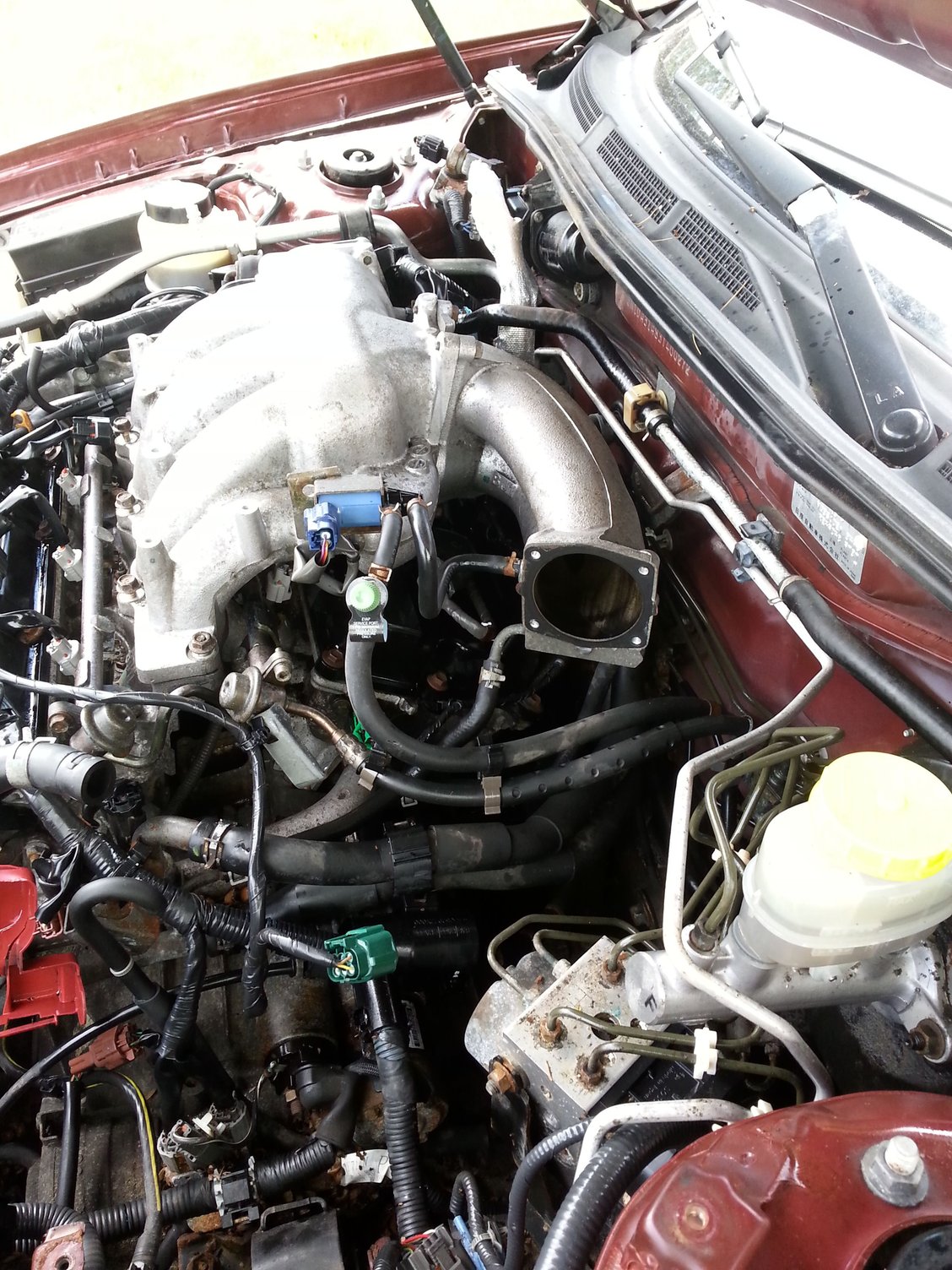

First, I'm not a mechanic. Have no history with Nissan. And I was able to replace the lower and upper intake manifold gaskets. I did it in a few hours with basic tools. Not expensive. I would begin replacing them. Get that ruled out. And it gives you a chance to inspect all hoses, plugs, coils, see in back. Soak the piston tops and spray the ports with some type of spray cleaner. Also, any type of water issues getting on the knock sensor will definitely cause issues with ticking. You get a chance to see whats in the middle. After doing that I found out it was a bad friggin coil causing my P0300. Turns out depending on its location, it can appear as a P0300, or the actual cylinder. I bought the Hitachi off Amazon, recommend you get one anyways. These coils are 2 piece. The top, and the extension that goes down to the plug. So just pulling them off can damage them. Use plenty of bulb grease thats for sure.
Took the TB off to clean properly. Check the coolant lines connected to it. Nasty oil burner. Look at the oil backed up in the intake.
Upper/plenum off. Not hard at all. Need this steps for plugs, anything in back of engine. Some pics for you to see back of engine.
Upper/plenum and lower off. Down in the center is the knock sensor. It was flooded out, full of debris. No doubt that was a source of problems for pinging, ticking, etc.
Anyone that tells you oil burning long term is not a problem are lying to you. No doubt this engine was misfiring on all cyls. Imagine the catalyst on this car is bad as well.
