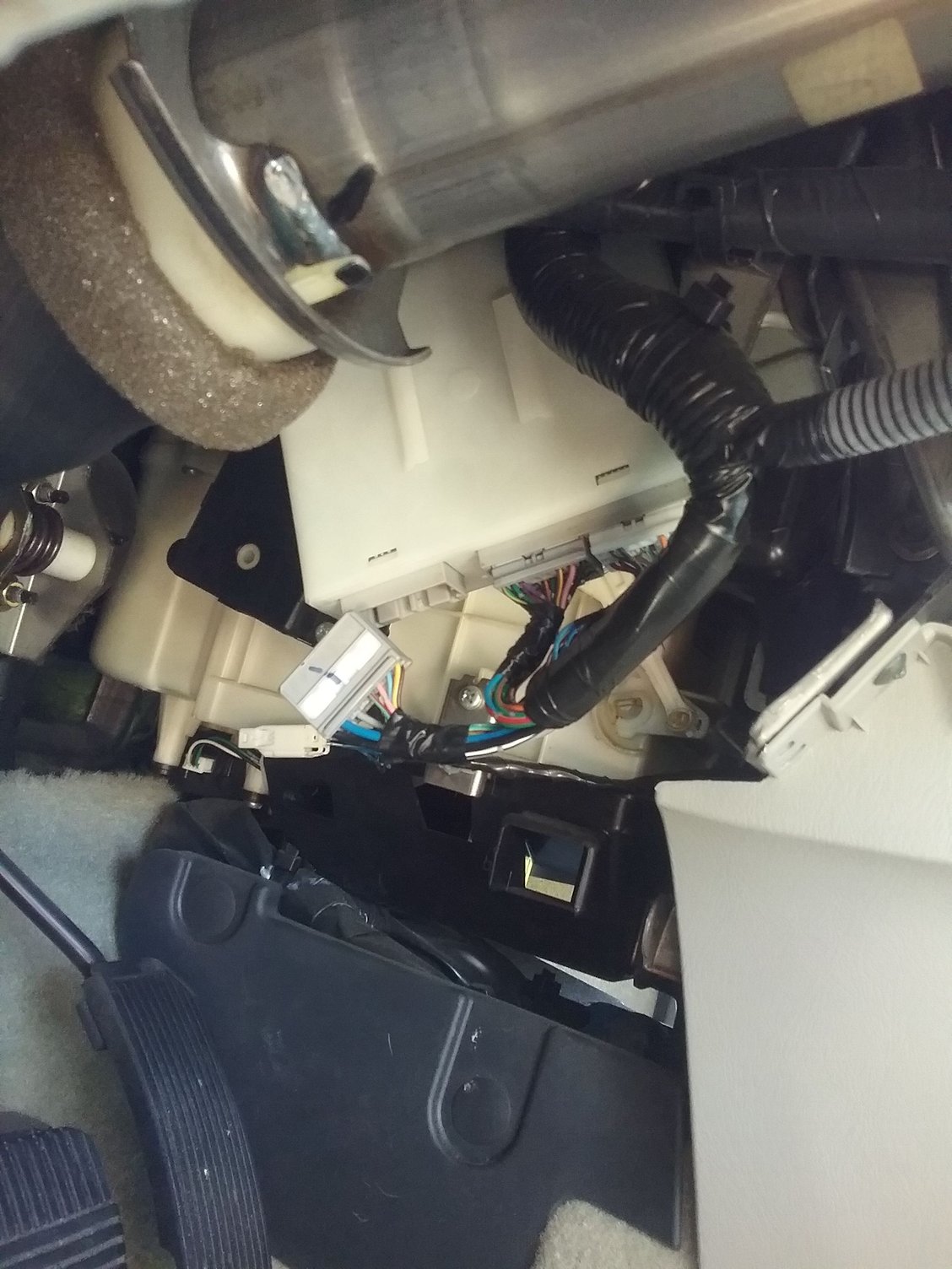

Well I'm not sure if I have struck gold or found something really bad. Started right up and move it outside, turned off, back on and turned off. Went for third time and same no power issue. Only this time about 30 seconds later I heard a clicking noise that just kept ticking and determined it was this box. Felt it clicking and then pulled that wire cluster out......ticking noise gone. No power at all to the inside of car still with the exception of security light blinking. Also I have heard this noise in past but very, very faint and it went away fast. Any thoughts? And the gizmo thing is being delivered today.

This looks like you may have a problem with your NATS/NVIS (the Nissan Security System and Immobilizer).
Is the red security light on when the "no power/no start" issue occurs? If it is, you definitely do. Also, are you always starting the car with same key, or do you have and use multiple keys?
In either case, read the description in the FSM, it starts on page EL-321.

For anyone researching this problem. Maxima's are prone to grounding issues because the size of ground cables and the location of various attachment points. Intermittent problems, and a number of common faults indicate a possible bad ground. If faults occur during cold or damp conditions and go away when car warms up, makes grounding even more suspect.
My own issues started with P303 code. I also had a rough and high (1000 rpm) idle. Compression was good, so I replaced plug, coil pack, and eventually fuel injector. Intermittent faults still occurred. While researching, I saw many threads on Maxima grounding kits and had an AHA! moment.
I removed the battery and the battery tray to access the ground cable on my 07 Maxima. Both terminals were slightly corroded. I removed the negative cable and observed the all the attachment points were to painted metal surfaces and the bolts had an anodized finish which would not make for good grounding. I cleaned the battery posts and terminals, and took abrasive cloth to the painted metal surfaces. I also added a cheap pre made negative battery cable, 19 inch, from the transmission attachment point to one of the bolts on the coolant crossover pipe to ensure good ground to block and heads.
Happy to report that the intermittent problems I was having went away. Idle went back to 750 rpm and steady. No more missing, and car was noticeably smoother and quieter. Other problems, such as seat adjustment periodically not working and one headlight going out when raining, also solved. Hope this helps someone, I could never find a complete answer in other threads.
