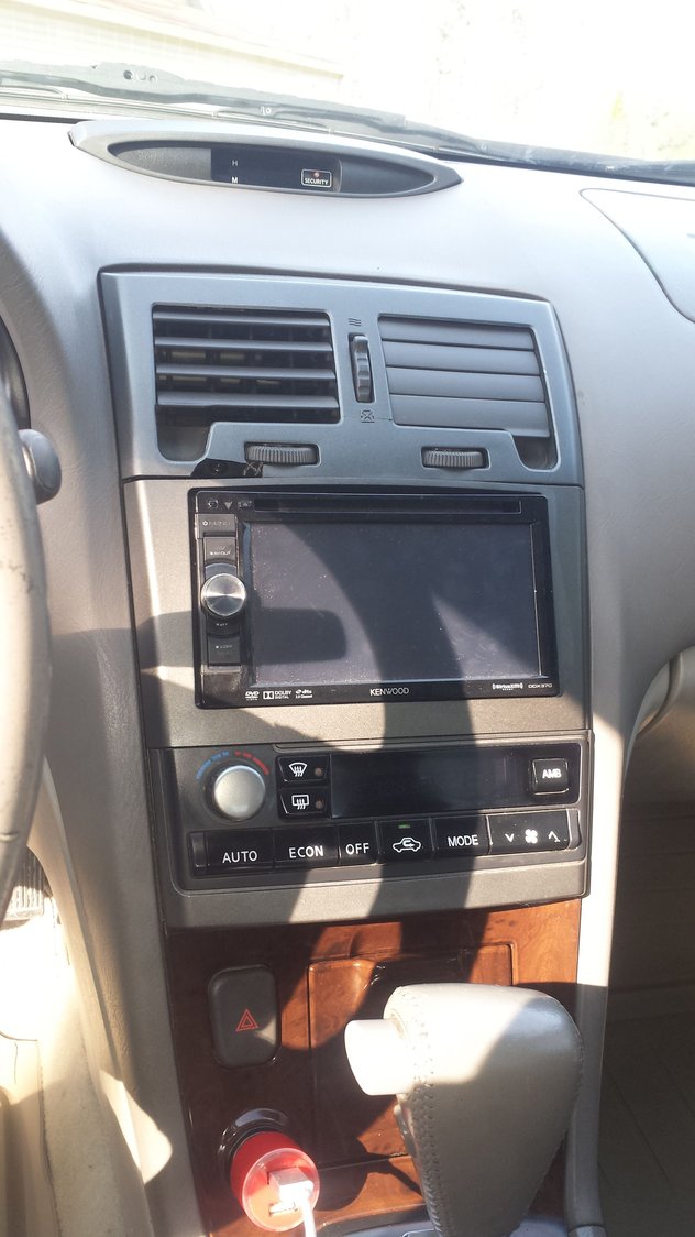

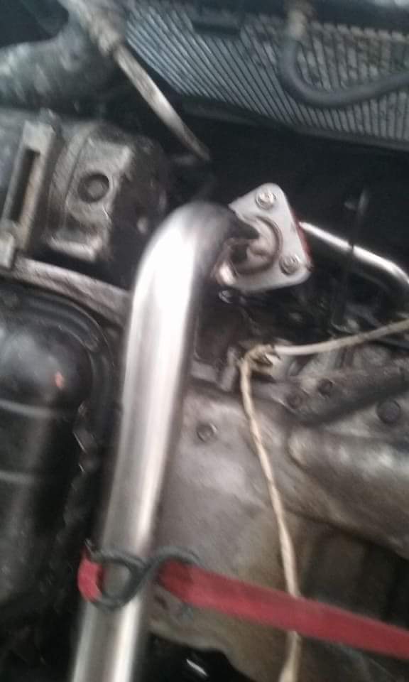

The auto we have grown to call Glee and the fed spec 5 speed. I have big plans for both, compiled a mind boggling amount of research, already accomplished quite a bit, am always willing to help out with cut to the chase advise, and always open to information I'm not aware of. Was glad to see some locals so I decided to pause further research. Just so it's known yes I have vq30 dek 3.0 cars. Did this on purpose for several reasons... Affordability, reliability, and other than the fed spec trans easy to find parts... Not knocking the 3.5 guys but Renault can bite it. I have just ascertained my USB cable for data scan 2 as well and will have it going in a day or so. If they're correct I'll be able to program blank keys, relearn idle, and blah blah. Only have 1 problem with data scan 2 so far. It connects to Glee fine and relearned idle yadda yadda. It won't connect to the 2000 5 speed ecm. Keeps saying failed to connect. The progress bar keeps loading like it's receiving data though. Open to input. Recently been working on Glee. I have installed eBay headers (for cat removal not worried about gains with her), inner, outer tie rods, lower ball joints, complete strut kit all around, lower control arm bushings (pressed myself even with a press it's a nightmare), new hub bearings (spindle was fine but I work in a fab shop and have a press at home), new axles both sides, rebuilding the old ones boots weren't torn (they bear the Nissan stamp too), it received a new alternator as well as a new Nissan battery upon my receiving Glee (family heirloom), new fan assembly, stereo tied into Bose correctly along with the solder repair on the factory sub board, k&n drop in, and I'm sure more to come... The five speed is a victim of accidental threw key away taking trash out but it's ok. Trans needs rebuilt (input shaft bearing), iacv (ecu still good), and it needed a 5th coil pack when I bought it. Having a mechanic acquaintence I work with rebuild the trans for me actually cancelled plans with a well recommended transmision guy my work buddy is that level of mechanic... Want to do straight cut gears with the syncro mesh. Don't know if money and my willing to wait will permit. Made a shift console for my five speed I hope y'all like...
