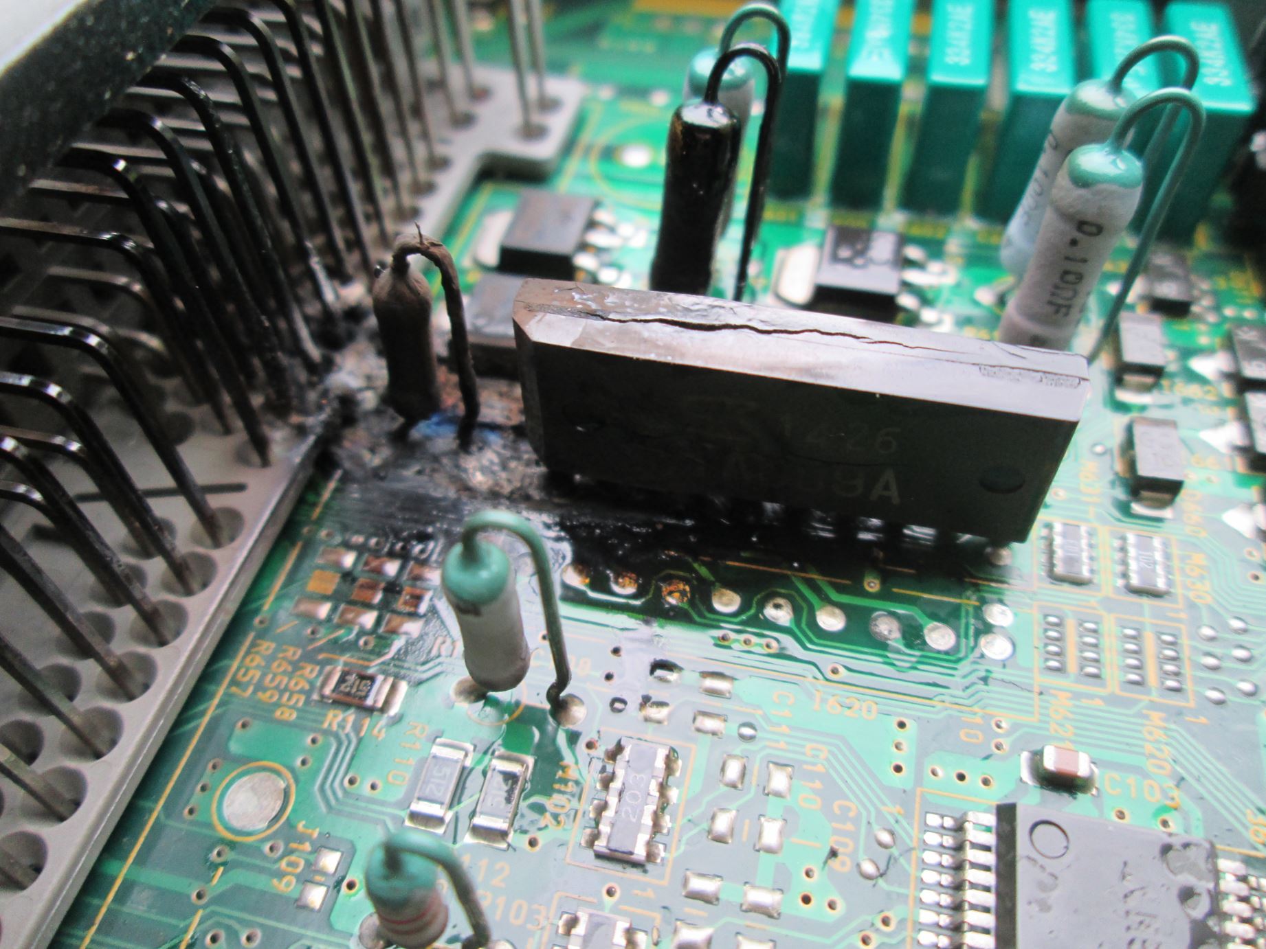

well got the brakes fixed finally..now it's a new disaster . Took it for a 70 mile drive. car didn't feel that peppy but anyways .
Had my craftsman scan tool with me. First code popped up early in the drive P0110 is this a air temp sensor or IACV code?
Then at about the 30 mile mark got a P0160,one of my O2's has a disconected wire,it's probably that.
Then at about 60 miles i started getting a terrible ammonia,plastic like, burning in the cabin. Then it was the P0505 code And service engine light was flashing. A few miles later. Car died about 600 feet from home and i coasted in.
Any advice with be great ,i already ordered these.2001 NISSAN MAXIMA 3.0L V6

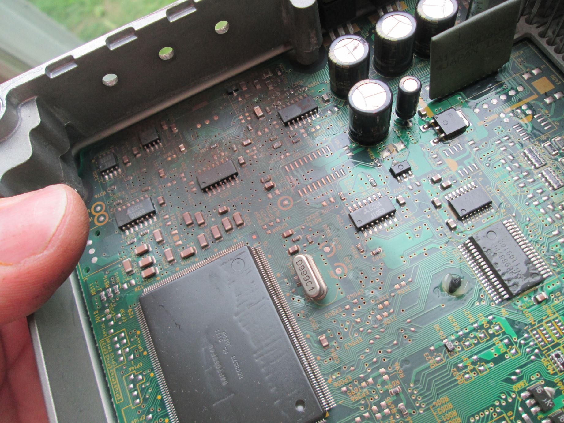

I am thinking of sending my ECU to here.I havent checked it yet to see how bad the burn is.And i don't even know what caused it . They say replace the IACV and TPS? Does the TPS get set like the 4th gen ?

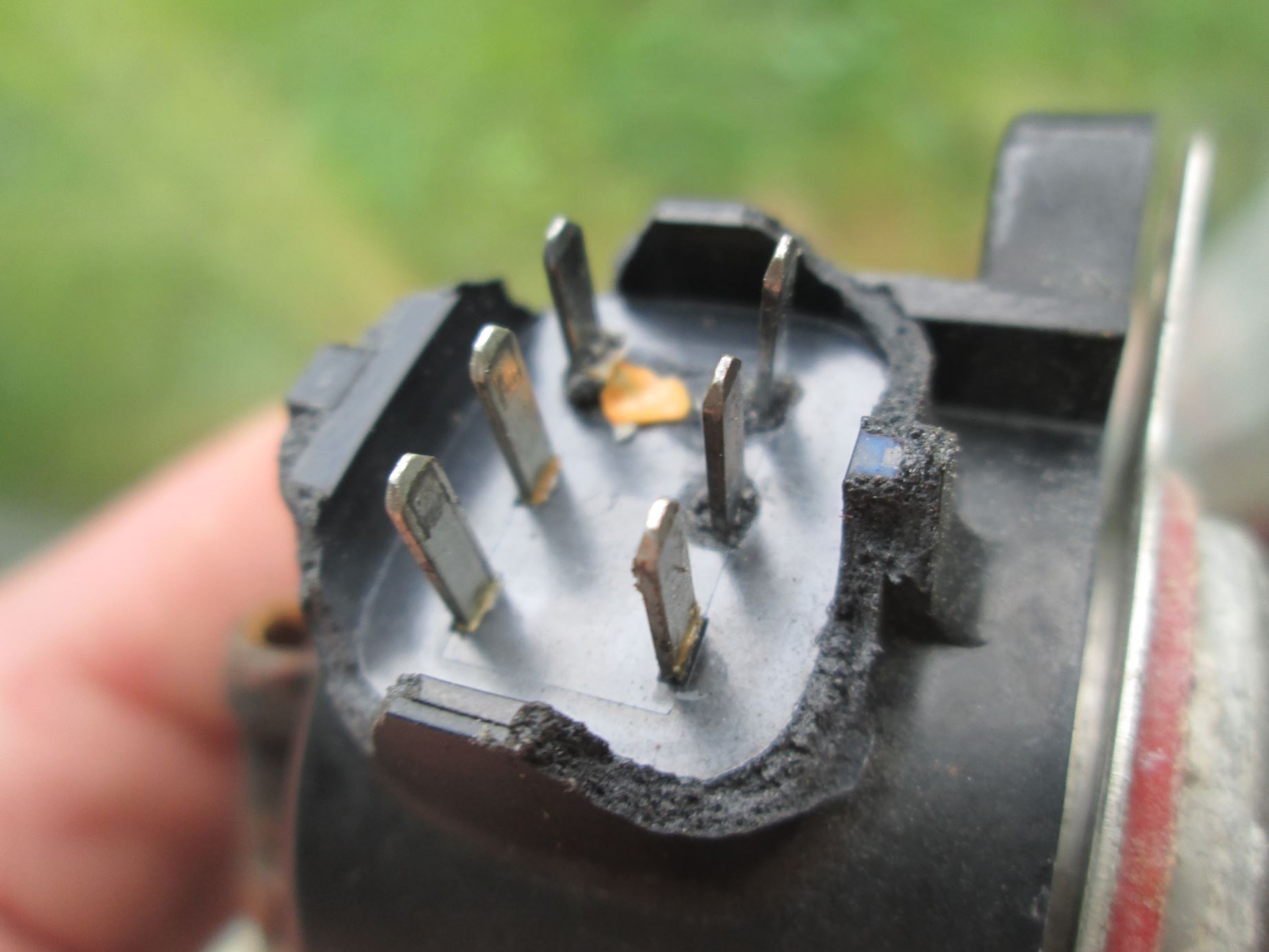

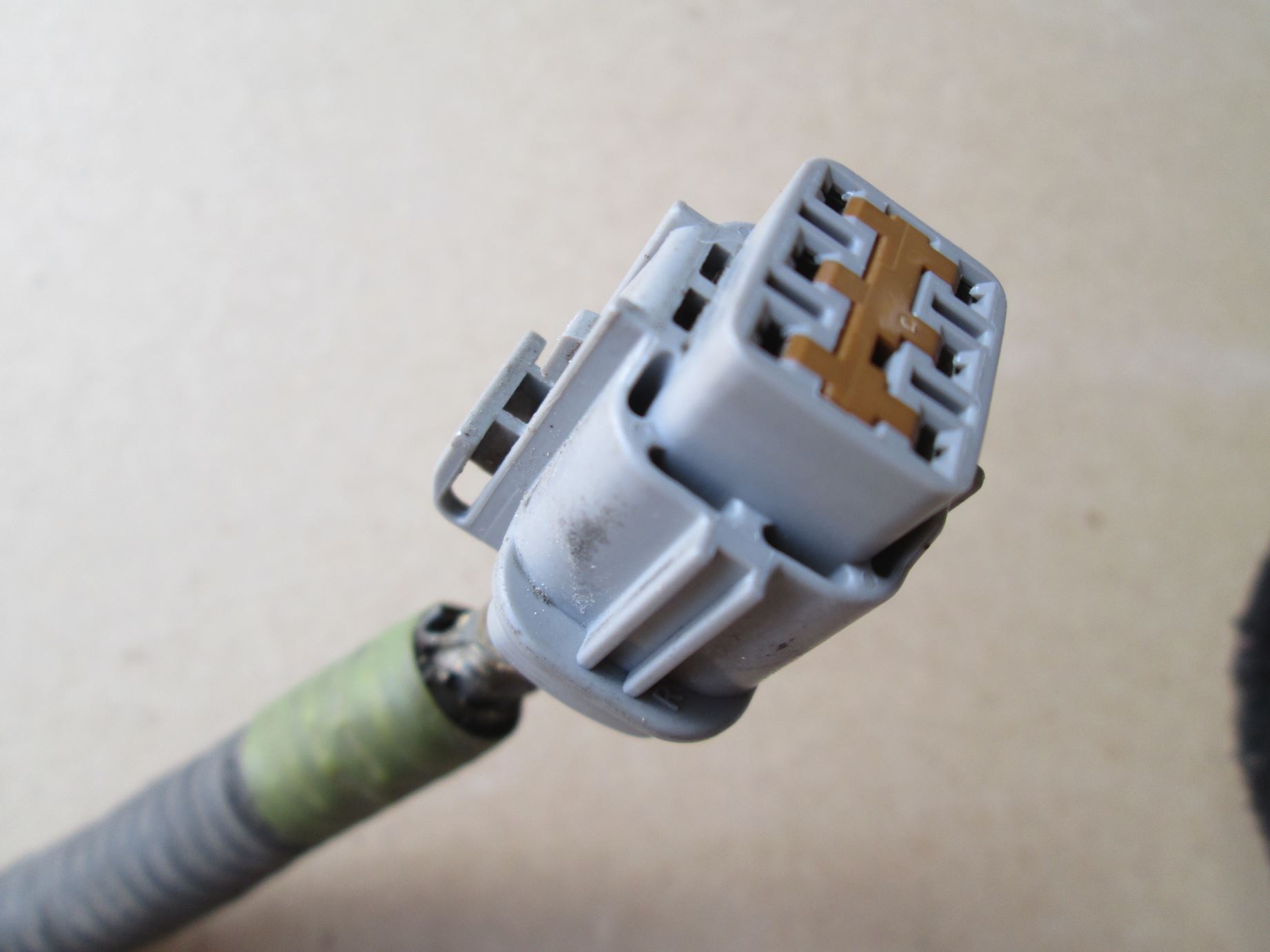

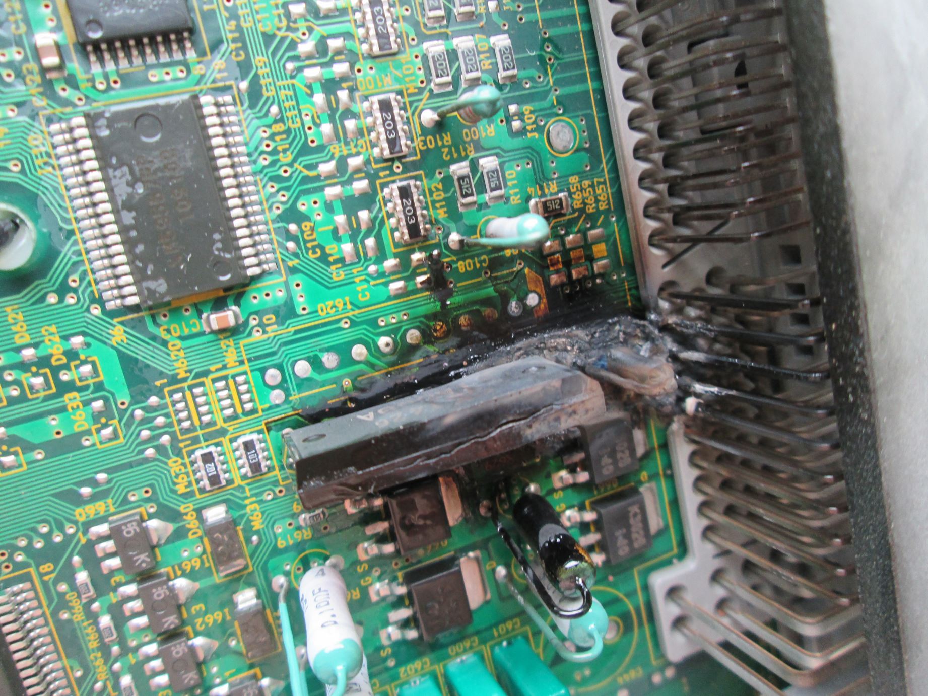

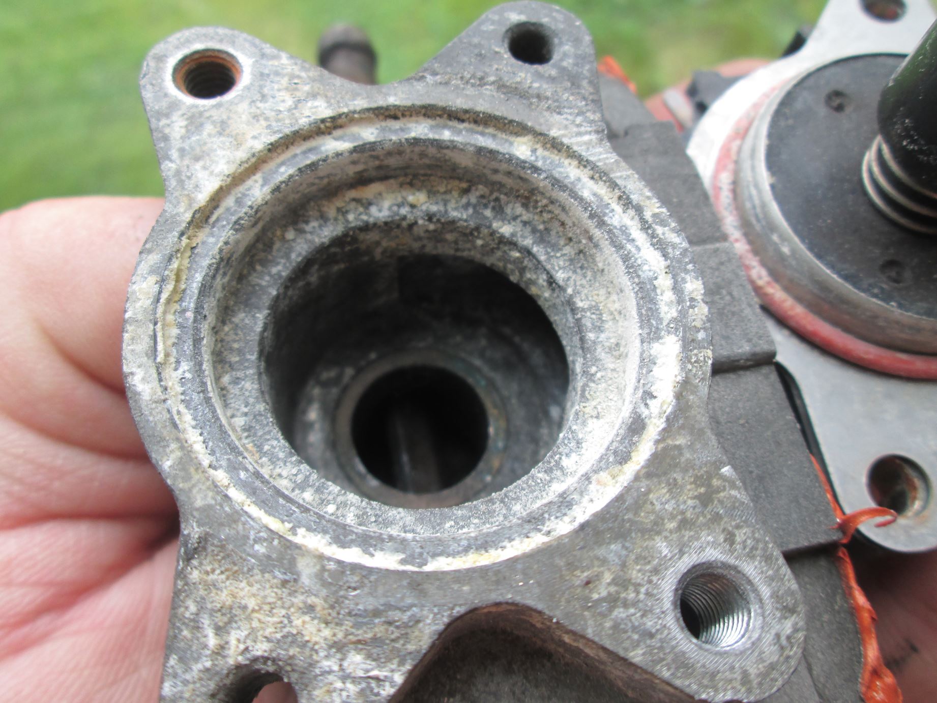

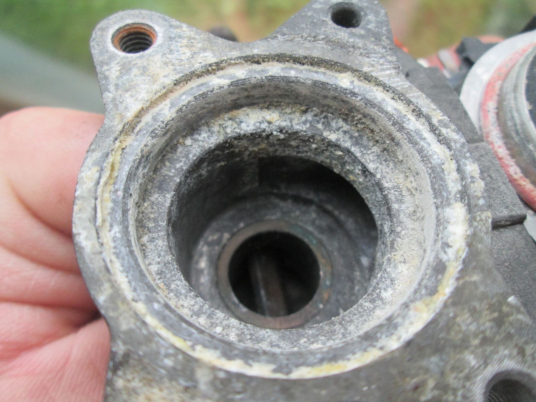

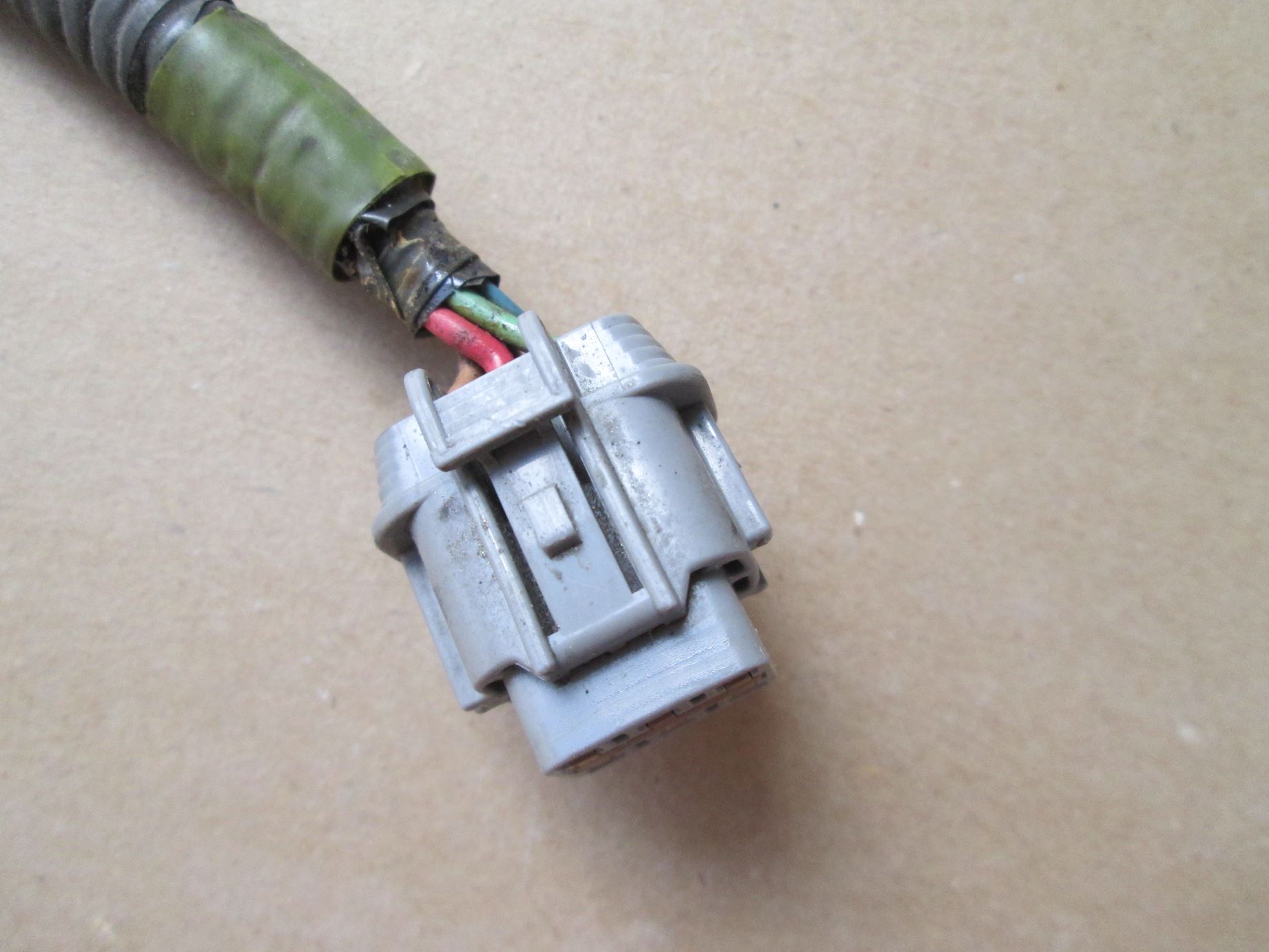

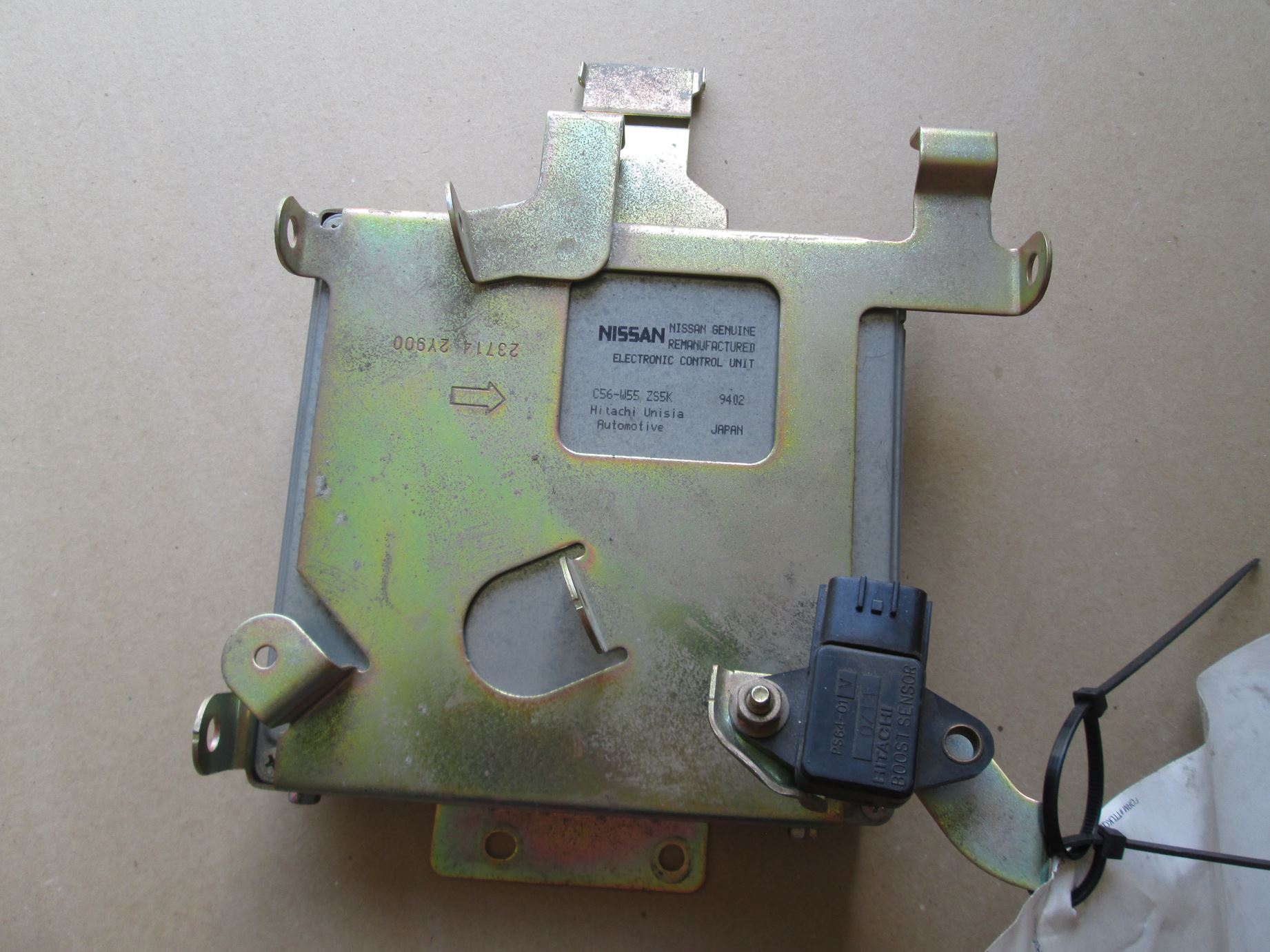

As a service to others,even if you bypass your coolant for the IACV. If it had a leak in the past the resistance,will overcome the IACV and ECU over time .As you can see the amount of coolant that leaked into the air chamber is substantial . The person who owned this must have been burning antifreeze over the years.
I should have changed the IACV with a new one.
The plug that goes into the IACV was melted in . I had to break the plastic around the IACV to get it out. I will have to get a male pigtail ,because mine is shot.

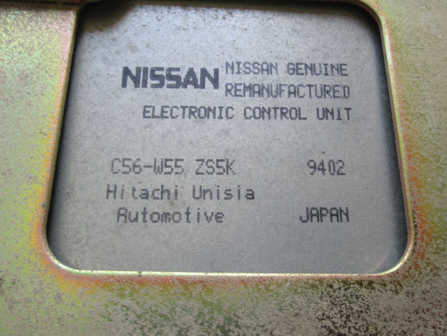

Ordered a ECU ,there's no way this one can be repaired.

Very common, it will happen to all of them over time.Not only does the IACV do it the electronic motor mounts do it also.

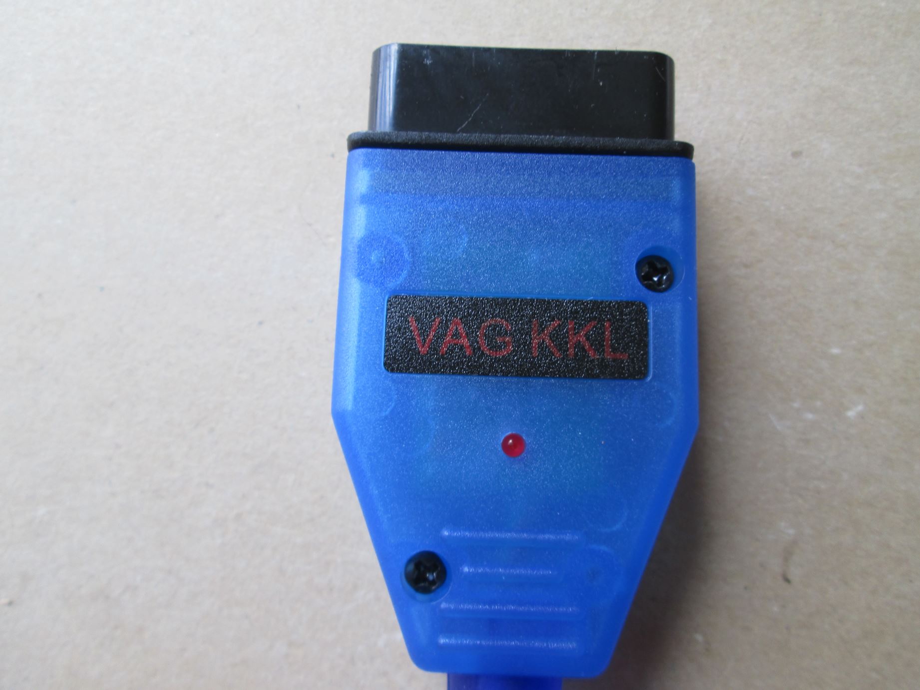

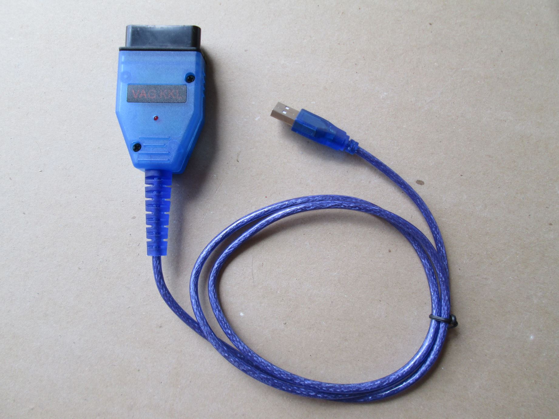

picked up this cable for the NDS2. Researched a bit and found many cannot connect because of wrong cable. Used the first off the list they recommended.
https://www.obdinnovations.com/kkl-o...n-datascan-ii/

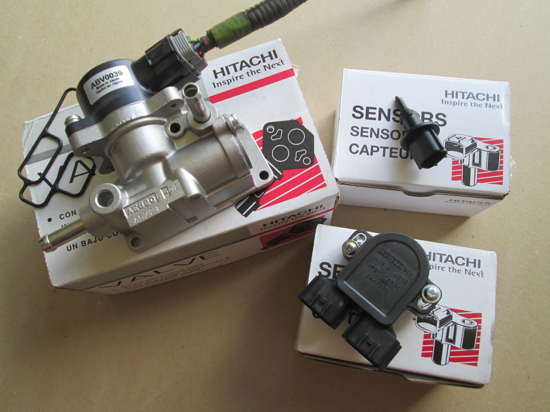

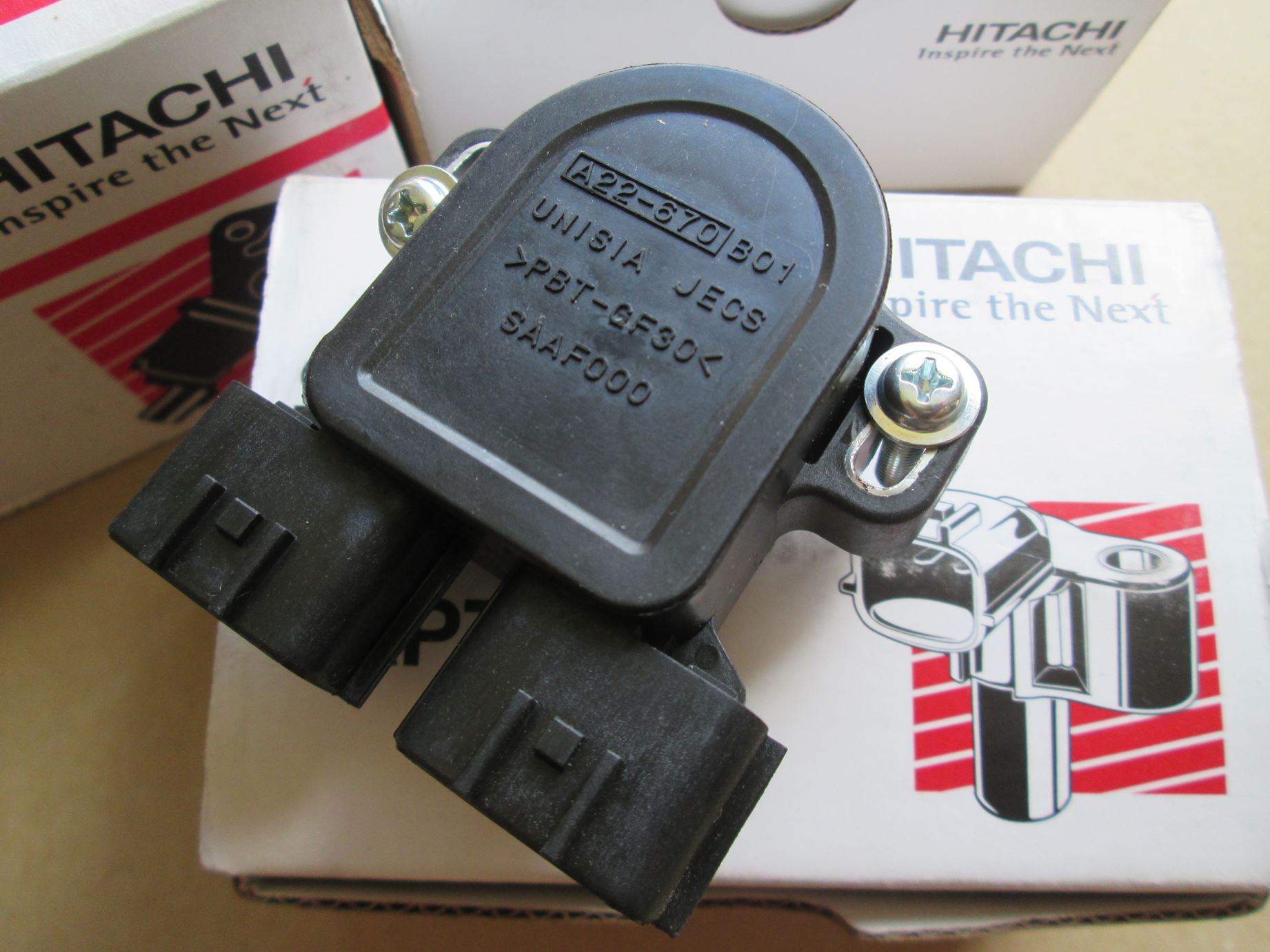

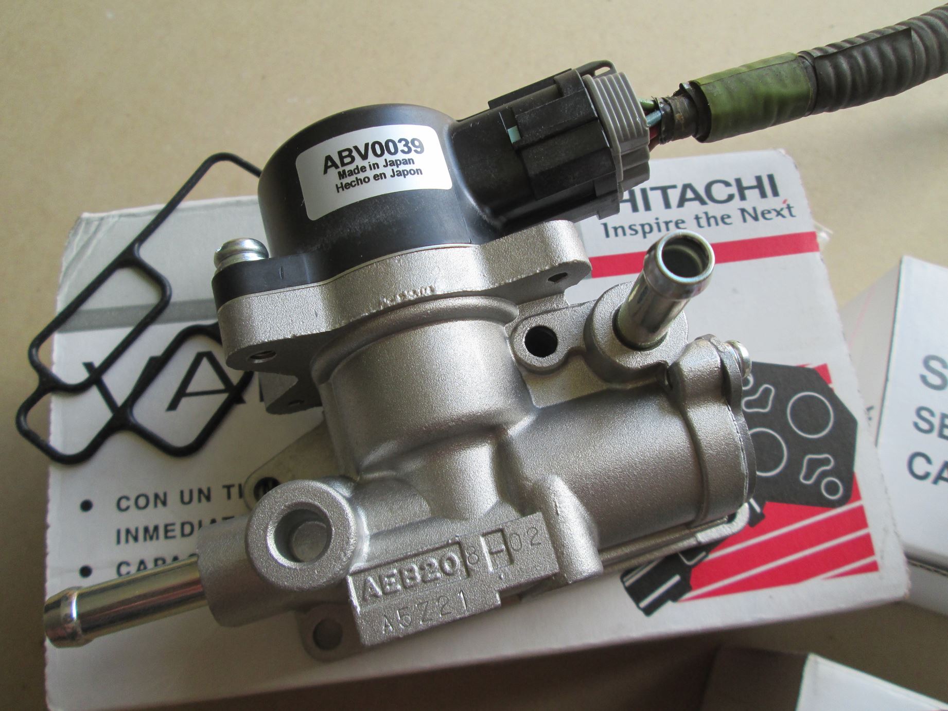

These are the things i am replacing all OEM parts IAVC ,TPS and air intake sensor all Hitachi . Got a ECU from LKQ says re manufactured ?! don't know what that entails?
Also picked up a pigtail for the IACV in excellent shape (mine was melted).
All the 00-01 i see in the yards have coolant leaking in the IACV...........

OK got the TPS on and i used this ,from a nissan manual . Very nice and clear from nissan.
I see many do not know this ,but this is how it is set. Shows other nissans use this too.
I have the 4th gen one and it is the same.
I did it off the car ,on my 01 but i think the 4th gens need to be on the car. Never done a 4th gen one but did a pathy TB 01 with the 01 maxima procedure and it worked perfect.
The beginning is just describing with the TB on the car how to make sure the throttle isn't being held open by anything .
Best way to ensure this is to remove the TB from the car.
http://askatech.com/AskATechLive/for...er.ashx?a=5638

There is a memory re-set for the TPS. It involved hooking an ohms meter up to the two of the 6 pins and twisting the sensor until the no continuity.

sorry if I didn't search or understand this, but whats the idea behind the coolant bypass for the IACV? is it a performance mod? or practical kinda mod? like upgrading to 6th gen Valve covers?
It keeps the coolant from leaking into the IACV ,where it is not suppose to be.This is what fried my ECU. 3.5 doesn't have an external IACV.
I think the previous owner fried his ECU. Then had it replaced but he and the one who replaced it wasn't smart enough to fix the problem that fried it.

Changed the TPS ,intake sensor and IACV.
Finally today it is done the ECU is in, i programed 3 keys with no problem .
The NDS 2 is super nice!!!! Took me about 4-6 minutes to program the keys. NO DEALERSHIP is needed with ECU change. Just wanted to let people know this.
I had a locksmith arguing with me,about the fact he says the vin needs to be programed to the ECU. And he says you shouldn't have changed the ECU...wow really.
So that's all wrong.
The NDS 2 will program no problem. I think the problem people have with the NDS2 is they buy cheap cables. This connected to my laptop instantly.

Out of curiousity where did you get the cable? Luckily i found one from walmart online that has the chipset mentioned on obd2innovations’ website (people who sell NDS2) but beyond that they all seem to be in china. Did you manage to make it work with a cable without that specific chipset?
also did you already have the PIN for programming the keys? I read all maximas use the same pin regardless but figured id ask someone who has it very fresh in their memory lol. about to purchase NDS2 myself once my cable arrives, hoping it can shed some light on my current engines woes.

As far as those with questions regarding the interface cable: The cable interface has one job, to convert serial data to USB. This conversion occurs within the FTDI Chipset
https://en.wikipedia.org/wiki/FTDI
There are a million +1 applications as well as huge support for this chipset, along with a million different manufacturers of countless cable types. For our application, one simply needs an OBDII plug type on one end and a USB (2, 3, C, etc.) on the other end with an FTDI chipset in between. There is no need to be concerned with cable manufacturer, cable quality, etc., and in theory, with a little bit of technical savvy one could build his own cable with the relevant plugs and an FTDI board:
https://www.ebay.com/itm/FTDI-Basic-...-/230820610037
Here are a couple just for fun:
https://advrider.com/index.php?threa...-cable.921377/
https://forum.arduino.cc/index.php?topic=95037.0
Not trying to hijack your thread, but it is pretty popular right now and I see a lot of threads with questions about this cable and not a lot of clarifying responses. Was hoping the info would be helpful. Again, great work! Let us know how it runs and/or any bugs with the new ECU!
Cable info post #5 . OBDinnovations . But DO NOT buy the NDS 2 program off them. Get it from the main NDS 2 site. I don't feel like getting into but i will say they wasted days of mine and i am trying to get money back.
User1
Yes as for the cable its not "dumb" I did hook the cable up make sure it's drivers were up to date(they already were) and i set the COM port to #1
NATS program video 1 min 11 seconds that's how fast one key can be done.

i had my IAC aluminum body and the throttle body surfaced so they were as flat as possible for a good seal. so as to prevent another coolant leak.
That's a great idea but i can't risk it. I completely bypassed the coolant away from there.
I literally didn't add any hose or clamps . I just pulled the too hose side off and put on the return. And threw away other hose. I'll take a picture of it later.
I really do not think the coolant does anything. I have been bypassing the TB's for 20 years . My weather is below zero for days. It takes 10-15 minutes for my car to warm up in that weather and most of the time i am at my destination anyways. I do not warm up my car.
I am glad you replied because it reminds me. The NDS2 has idle relearn. But i did not do it.
Even after all the things i changed the idle is smooth low and beautiful. After a few minutes just sitting it was perfect. 750-800.
I would love to leave the coolant in the Throttle body but Nissan failed and i had to save there failed design for my car. My car has 40k on the engine ,can probably last another 10-12 years. I can't risk loosing these parts again. At one point NONE will be available,anywhere to purchase. It's already nearly impossible to find a 01 ECU . No other year will work,for a 01 5 speed.

As for how it is running i had a P0110 before this incident and after . I couldn't get rid of the Intake Air temp code .Even though i just put a new Hitachi one on.
I should have know that when you clear the code and it doesn't go off even for a few seconds ...it has to be a short.
Well i looked at the Factory manual EC-173
"Check the following. I Harness connectors E8, F17 I Harness for open or short between ECM and intake air temperature sensor."
Well it was F17 ,i didn't plug it back in after i put everything together. it is one of the two plugs behind the fuse box ,by the driver strut tower.
I peeked in between there, i was so happy. Today was the day to tackle it and after 2 hours researching playing around,it was a easy fix.
Car idles lower low about 650-700rpm, smooth.car would stumble a little after giving it gas now that is gone.

supposedly the coolant helps warm up the throttle body or something like that. The IAC basically dumps fuel in until it's warmed up? it sucks the 5 th gens especially the 3.0 ECUs don't get any love. you have to wonder what it would really take to program out, disable or bypass all that, or maybe my memory fails me and that's exactly what you coolant bypass does.
