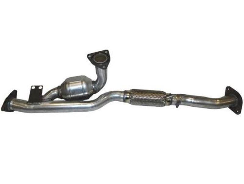

Old Jan 11, 2019 | 07:05 AM
Mike88SE's Avatar
Joined: Nov 2018
Posts: 94
From: Houston
I need to find my emissions sticker and see if my car is epa or cali. The y pipe assy's look the same for both specs in pics but have different part numbers.
Old Jan 11, 2019 | 01:09 PM
DennisMik's Avatar
Posts: 10,644
From: Plano, TX
The photo in post # 6 is for a Cali spec car.
Look at the outlet end of the main catalytic converter (beneath the passenger seat). Look from the driver's side and if you see an O2 sensor, you have a Fed spec car. No O2 sensor means you have a Cali car.
