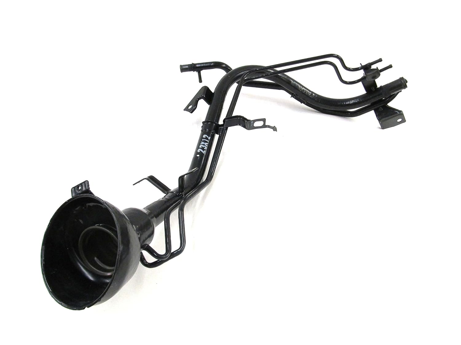

My 03 is leaking fuel if i over fill the gas tank. How can i fix this. Its leaking on the driver side back door and finder.

The filler pipe between the gas cap and the fuel tank (or one of the 3 vent pipes attached to it) could have a hole in it. These pipes can corrode and rot out in northern climates from the salt used in winter.
