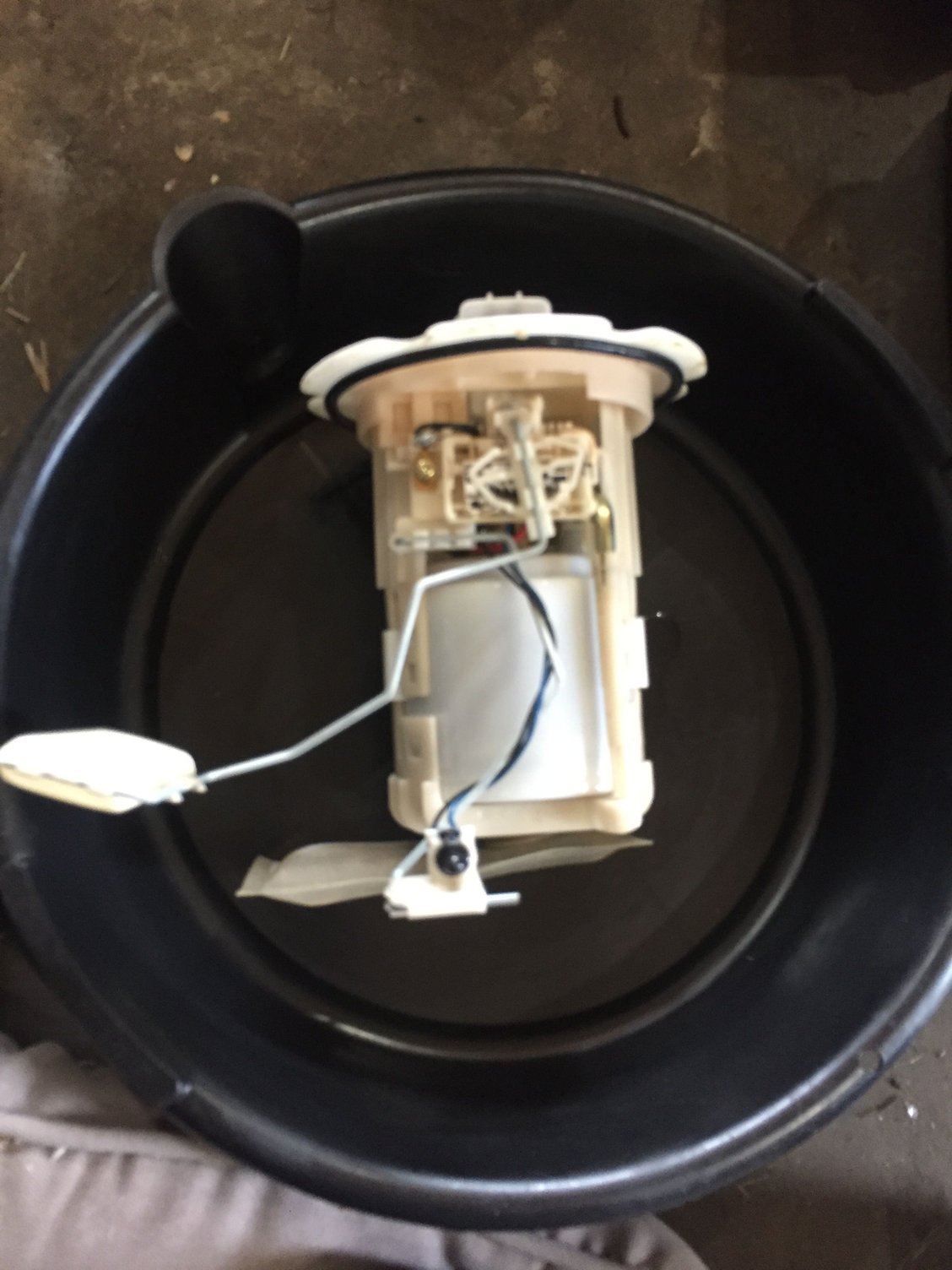

Yeah your welcome anything to help someone else experiencing the same issues it was driving me crazy . What led me to change the fuel filter was reading another thread guy said he did pcv valve and fuel filter and his went away. So I was changing my pcv valve and left a vacuum line unplugged on accident when I was smoke testing for vacuum leaks. (lol how ironic I’m testing for leaks and accidentally create one) I noticed it made it LOT worse especially going up hills with this lean condition . So I found a few videos what pinging actually sounds like, reconnected it and looked at my fuel system. Obviously something was causing it to be starved of fuel under hard acceleration or under load. Even in my YouTube video I posted the link of the other Maxima with the same issue and his MAF sensor ended up causing a lean condition not dumping enough fuel and the sound was identical.
My fuel filter wasn’t even the original one as you can see in the pic on top how much brighter it is than my sending unit and yet still it was very dirty. I could see this filter clogging up as every 60000 miles or 90 000 kms some have said there’s was black at 30 000 miles.

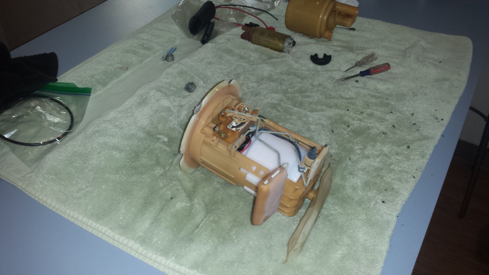

Got the fuel pump and filter replaced today. Did a couple of WOT test runs. My rattle has seemingly improved, but still exists. So I'm not sure if a lazy fuel pump or lean condition was my culprit. I really need to get the car out on the open road and just stomp on the throttle a few times and dust it out. I haven't really mashed on this car yet as I'm doing my best to get everything as mechanically sound as possible before opening it up. It seems that each time I run it to redline through the gears though the rattle becomes less and less. So who knows. I'm at a complete loss.

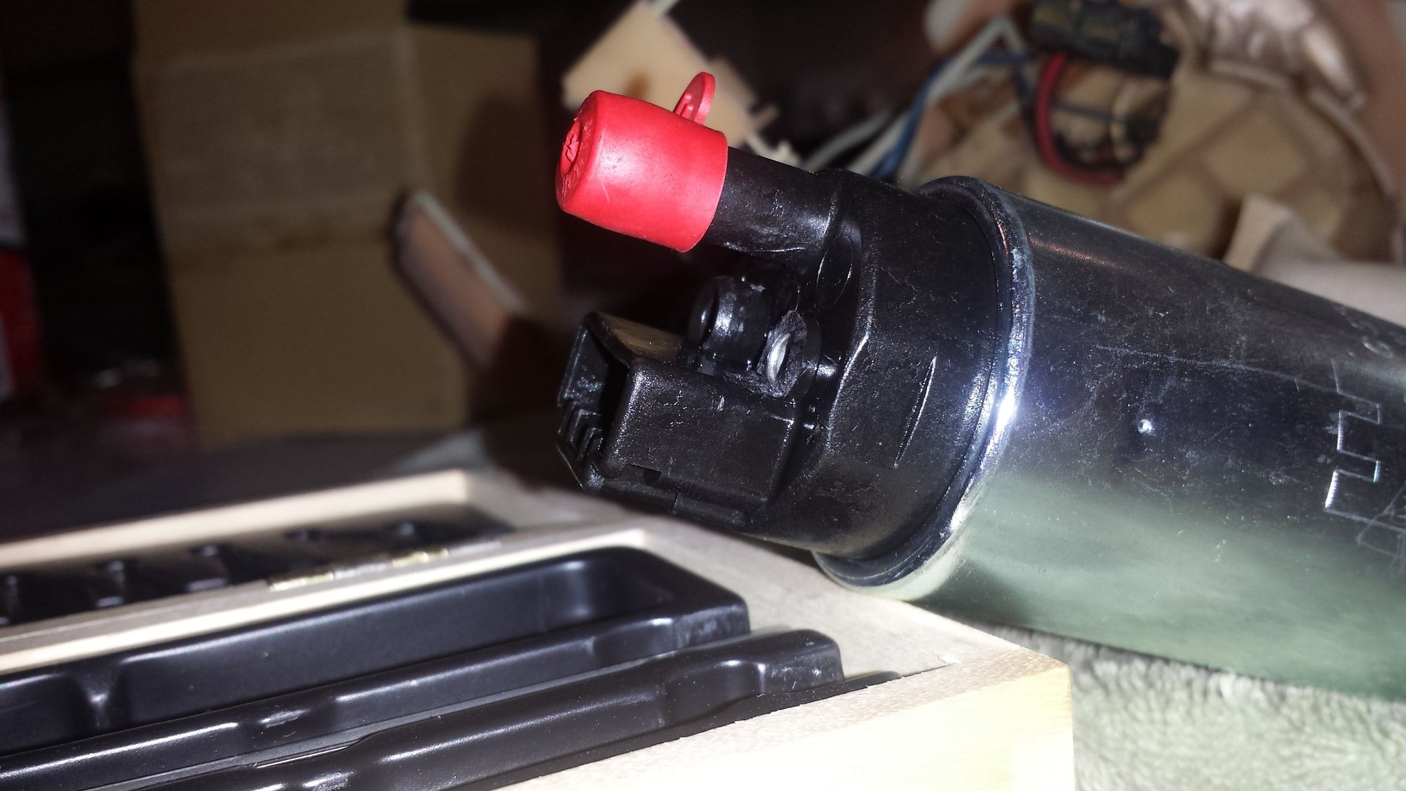

For anyone considering a Walbro GSS342, 255LPH fuel pump:
The pump body itself is about 9mm longer than the stock pump. You will not be able to snap the assembly back together without some kind of modification. Below is what I did. I used an X-acto knife and shaved both circular protrusions directly above the electrical connection as low as I could. This, along with discarding the half-moon shaped rubber bushing in the lower picture gave me enough clearance to snap the entire assembly together with a very tight fit. Pump fired right up and car started right away. No issues thus far after 30mi. Also, you don't need the Walbro 400-858 accessory hook-up kit that comes with it. I used nothing from it. Re-use old strainer and clean if necessary.

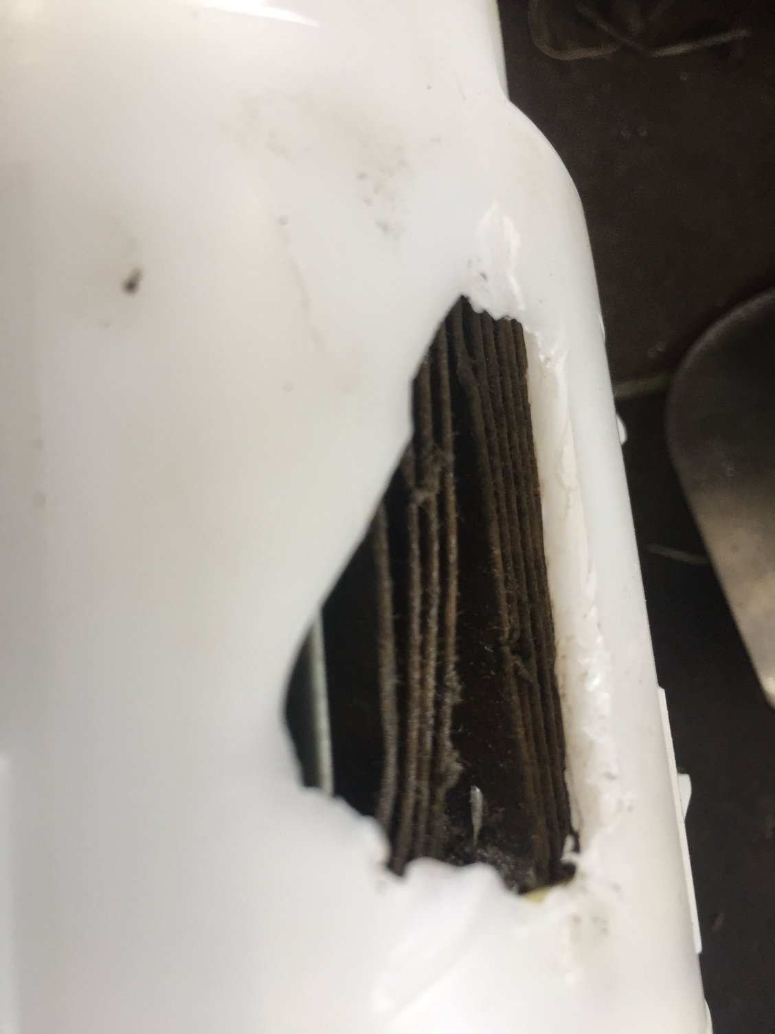

Also, I forgot to bust my old filter up to examine the filter substrate and it's out with the trash and I'm at work. Maybe I'll see if my neighbor can pull the bag out of the can before the trash monkeys haul it off early in the morning.
Edit: Neighbor came through and pulled my trash back up to my garage! I'll get old fuel filter opened up tomorrow and update. One of these days I'll just get an actual fuel rail pressure gauge

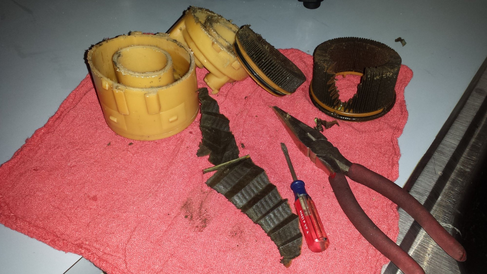

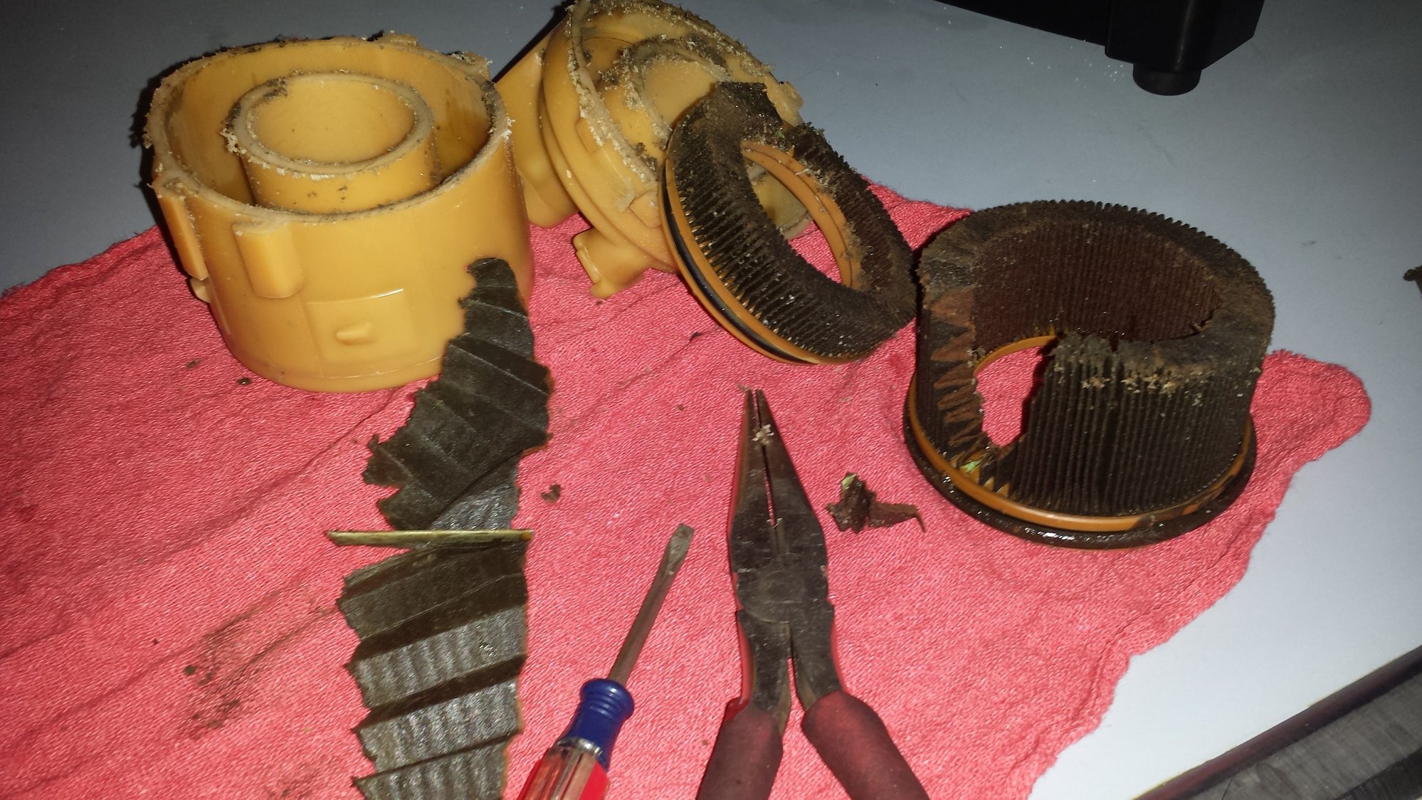

Just to follow up:
Well, I'm glad I did the filter and pump job! It's amazing I was getting any fuel at all! Not sure what color the filter substrate is brand new, but this filter was sticky/greasy to the touch and left black residue on my hands and rag when I handled it.
I feel much better now knowing that I have clean fuel going to my new engine. Which also raises the question, would now be a good time to toss in a bottle of injector cleaner? I've never used any magical, fix-in-a-bottle type products before because I'm not that stupid, and I know that the gasoline itself will dissolve any petroleum based chemicals/material in the system, but I'm at half a tank and figured, why not? It would be more of an impulse buy.
