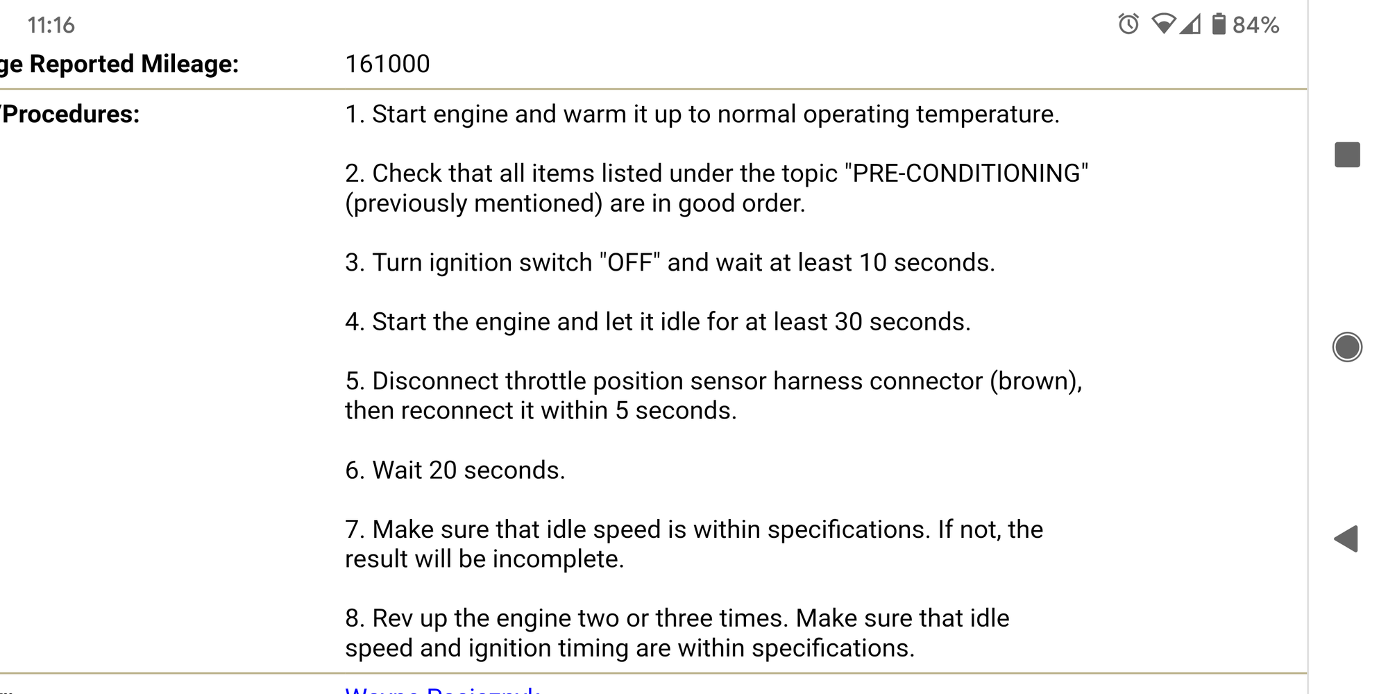

Guy's not sure this is a factor in your MAF decision but I failed to tell you of one thing. In addition to replacing the IACV, cutting motor mounts , sending computer out and doing coolant bypass, I replaced the TPS . I did the TPS because the guy that fixed my computer said it was a good idea. Im ordering the MAF today from rock auto. While Im waiting for the MAF to come in Ill pull the old one and clean it. That may help.
Old Dec 29, 2019 | 10:32 AM
User1's Avatar
Joined: Jun 2018
Posts: 2,493
Yours being an '00 or '01, I'm not sure about TPS or any relearn procedure. I replaced the engine in my '03 with a newer engine that has a TPS built into it's throttle body. I've pulled my ECU, replaced my accelerator pedal, DC'd my battery and TB multiple times and never did a relearn of any kind either manually or with NDSII and never had any issues, but I'm not sure about yours as the equipment really isn't the same.
You're on the right path with the MAF, though. I would pull it, spray it down and see if it had any effect. If so, then you found your culprit.

idle relearn procedure for a 00/01.
It may take a few attempts for it to take. Even on my 02 it took me 8 tries to get it to take using a snap on modis.

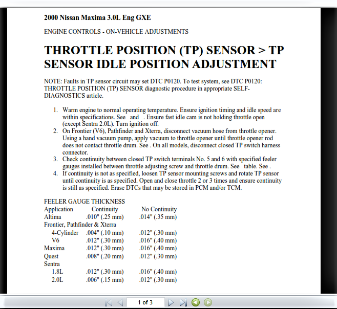

It needs to be set with a feeler gauge. You did this right?
I do this with the TB off the car much easier. Get someone to help you. If you do not do this the car will never run right. 95-01 maxima's have do do this when TPS is changed.

It's very simple i am not surprised dealer could not do it . MOST are just a step up from Walmart service guys.
And NO that is not gonna work. How you were gonna do it.
What you do is put a gauge where the TB makes contact with the set screw. (if the set screw is moved in any way or touched the TB is no good) So leave that alone.
Put a .012" feeler gauge in where that set screw is,then hook a multimeter up to term 5 and 6.(use two people)
Screws on the TPS should be loose enough to move it but tight enough to stay where they are. Then turn the TPS until continuity shows on Multimeter.
Next put the .016" feeler gauge in that spot (take the .012" out) and no continuity should then show. These are slight adjustments to the TPS. Then tighten the two screws down.
Then check it over to make sure it's done right . Do the .012" and the .016" again.
Again this can be done in your house in comfortable atmosphere.

This is where you put the feeler gauges ,where red arrow is. Between throttle stop and set screw. (green arrow shows set screw, do not adjust !)
Once you take the TPS out or change to a new one it messes up the setting. many people change tps and have problems,that's because they can't just bolt things on and think it will work.
I wish you would have told me you were buying TPS ,i would have said don't bother.

I listened to the guy that sold me the computer and bought TPS. If I had listened to you and the good guys on here I would be rolling down the road P0505 free a week ago. Thanks for the picture. Got my feeler gauges and buying a multimeter tomorrow. If I do the .012 and .016 on the bench. will I have to do the TPS Idle position adjustment on the car?

No you can do it in your house.
get someone that knows how to use a multimeter,to help you. The full procedure is explained also, in a Haynes manual, with diagrams.
