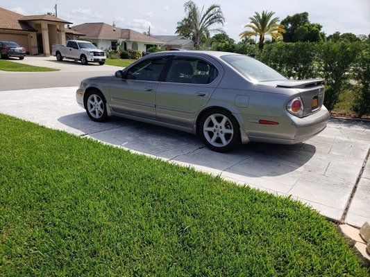

I took the family from NYC to Naples, FL and back in August with a day trip to Legoland and the car ran great the whole time. The roads and speed limits do open up a bit from NC and south which helped pass the time of the 19+ hour trip. The car has a 6spd MT but I rarely had to downshift to 5th to pass during my above posted speed limit traveling. For grins and giggles I did look on autotrader to see what options were around Naples if I wanted to trade it in. The only thing I remotely liked was a gold 2009 G37 with 75K for $10k. One owner and no accidents on carfax so you know it was driven by some retiree.

looks great man

Nice Altima rims. I got those same ones.

Thanks, they are the factory Maxima wheels for the 2k2.
