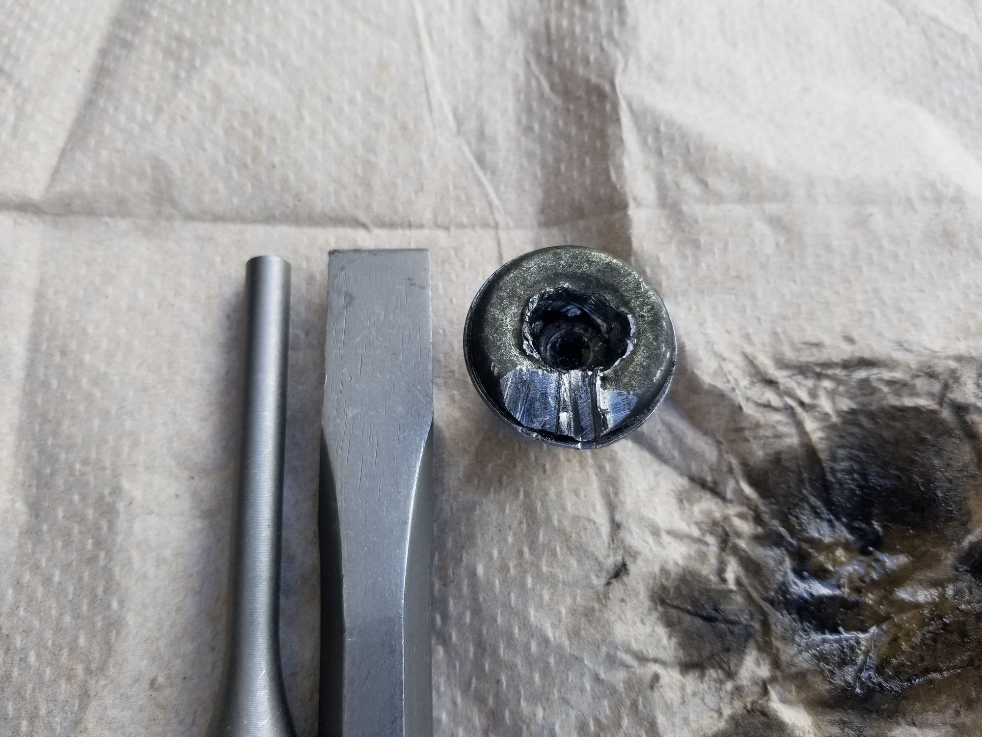

I started pulling my tranny today so I can change the throwout bearing and I stripped the drain bolt. luckily I found a video on Youtube on how to remove it with a chisel and punch.

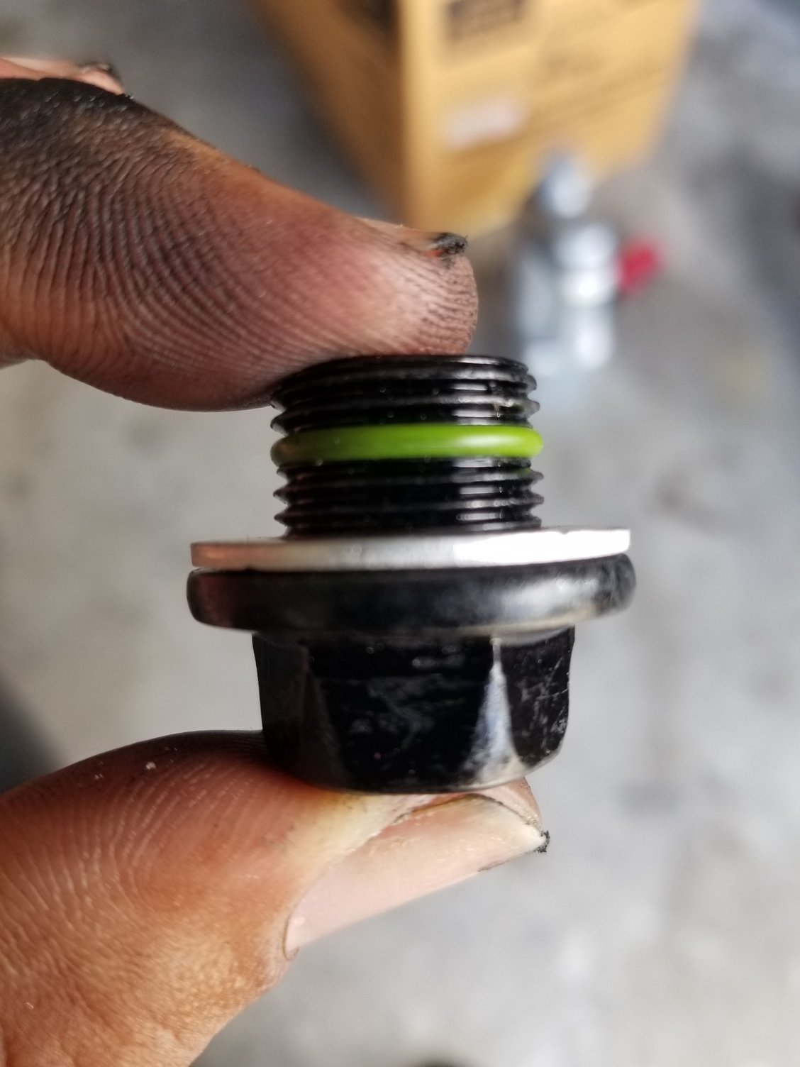

I had ordered 2 new Smart-O R23 M18x1.5 drain plugs ahead of time for whenever I was going to need to change the gear oil in my transmission, the plug uses a 19mm wrench instead of a 10mm Allen bit.
