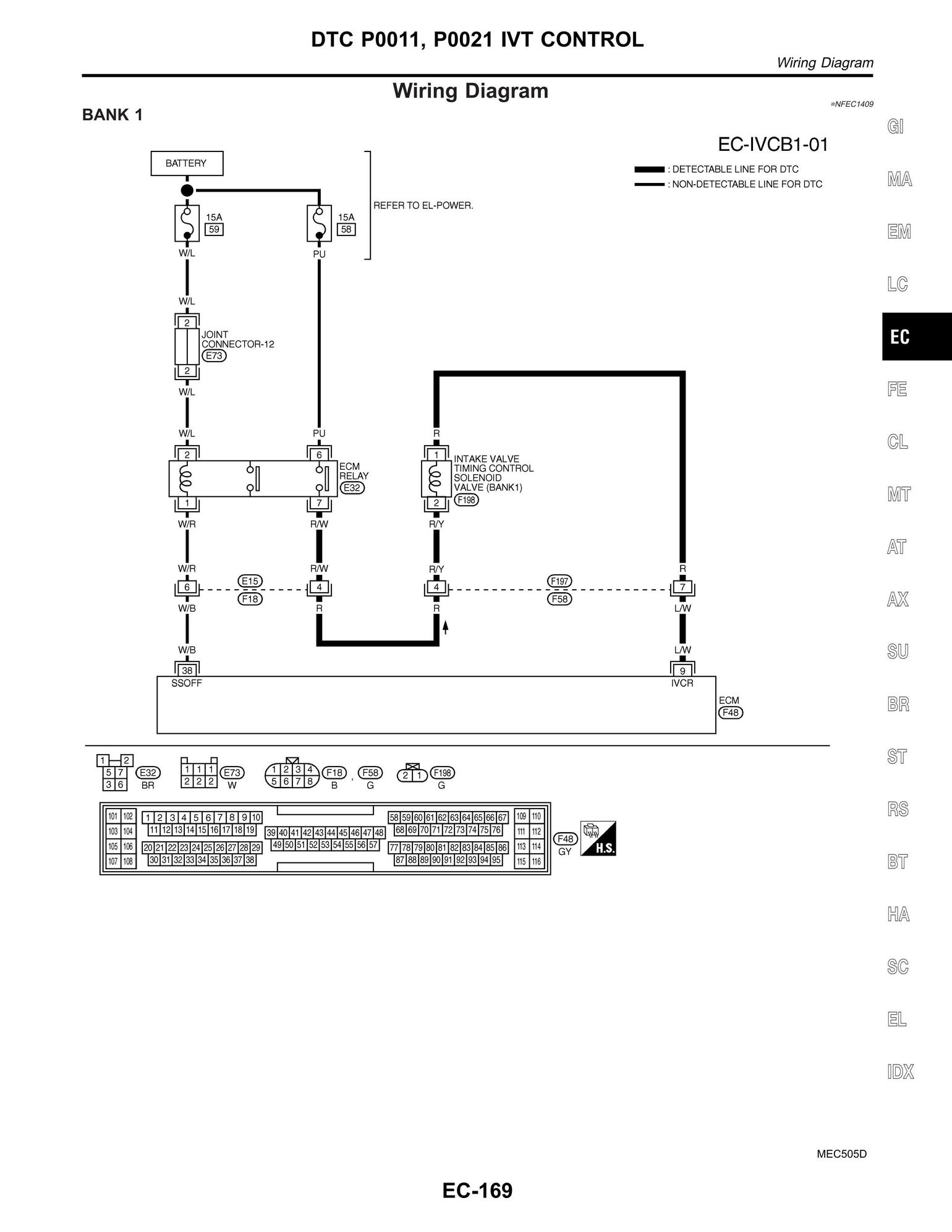

This is our 2002 Maxima FSM schematic. The striped, Red and Yellow is positive, the solid Red is negative. So I would presume that whatever wire is solid for either solenoid is your ground.

Thanks again. Annoyingly, the right side solenoid just has 2 solid black wires (both the original and aftermarket one). The Left side one has a diffrent colours but not he right side for some reason. Both the female and male plug are intact so its the polarity of the wires on the solenoid itself I need to figure out some how. Any suggestions for this?

Sure, here ya go
Old Jul 12, 2021 | 11:15 AM
User1's Avatar
Joined: Jun 2018
Posts: 2,493
You should have battery voltage when performing this test.

Thanks again! What Im trying to find out thought is which of the 2 wires on the solenoid itself is Live and which is ground. I have 2 solenoids, both with the plugs cut off and no way of knowing which wire is which as the wires are just black on both of them. So I need some way to find out which is live on the solenoid itself....

Positive voltage is terminal #2 in the image in post #12. So I would use that as the standard for orientation. The box thingy on top of the plug in the image is the clip.
