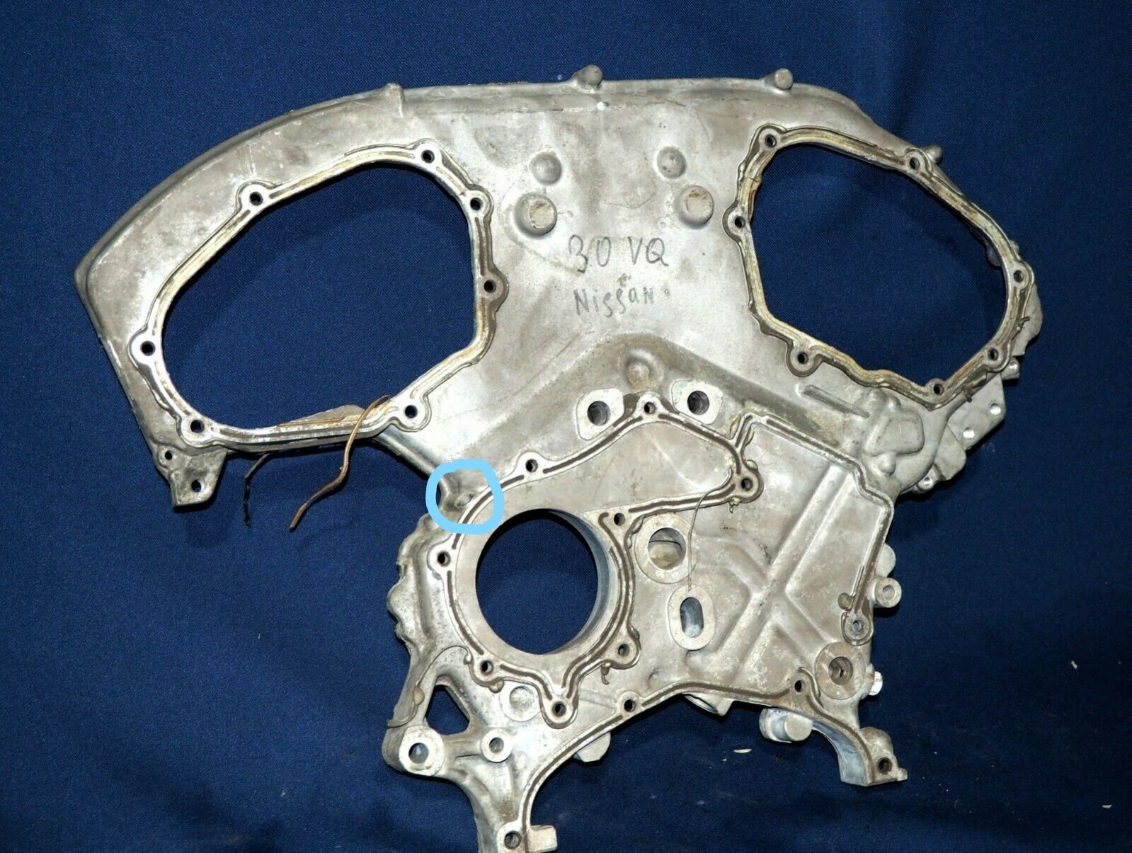

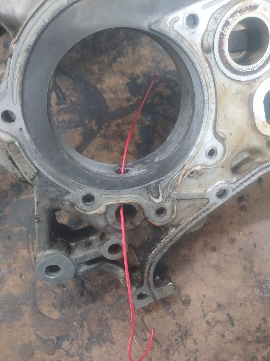

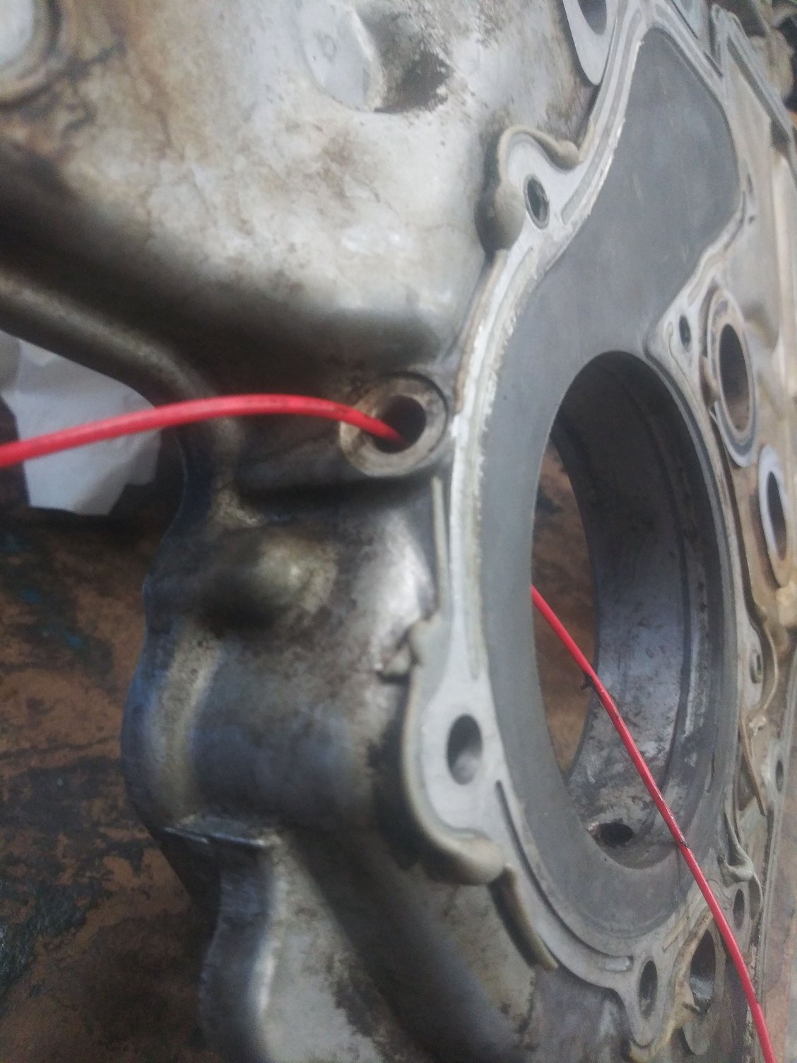

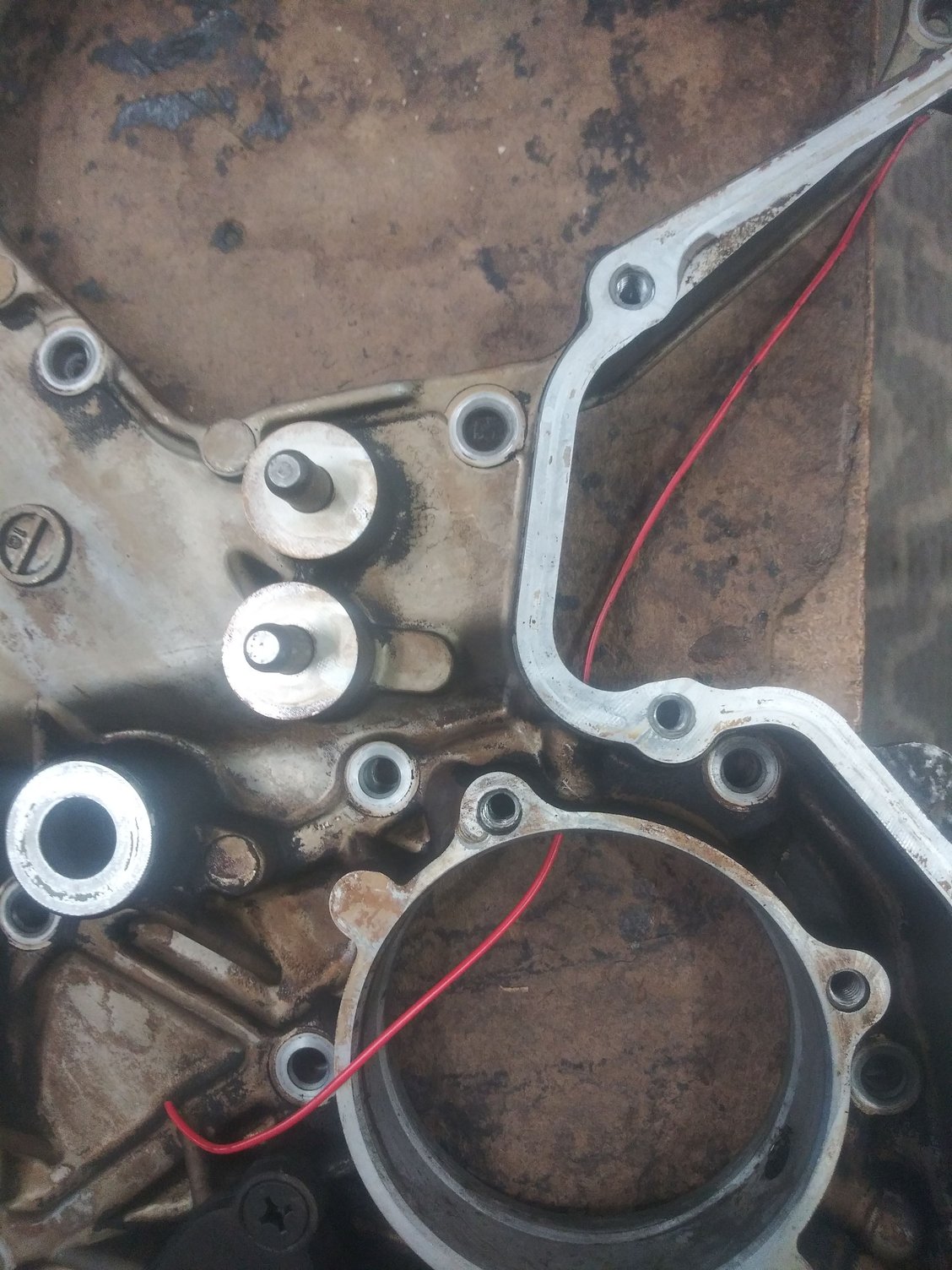

To clarify the above pics:
The lower hole, circled red in the 1st pic, is open to let any leaks drain freely.
The upper hole, circled blue in the last pic, should be sealed with some kind of plug.
Check the following,
Damaged O rings or they are mixed up, you changed these multiple times probably not the issue.
Pump shaft seal, could both pumps be defective?
Corrosion in the timing cover where the O rings seal, is there any damage to the hole where the pump fits?

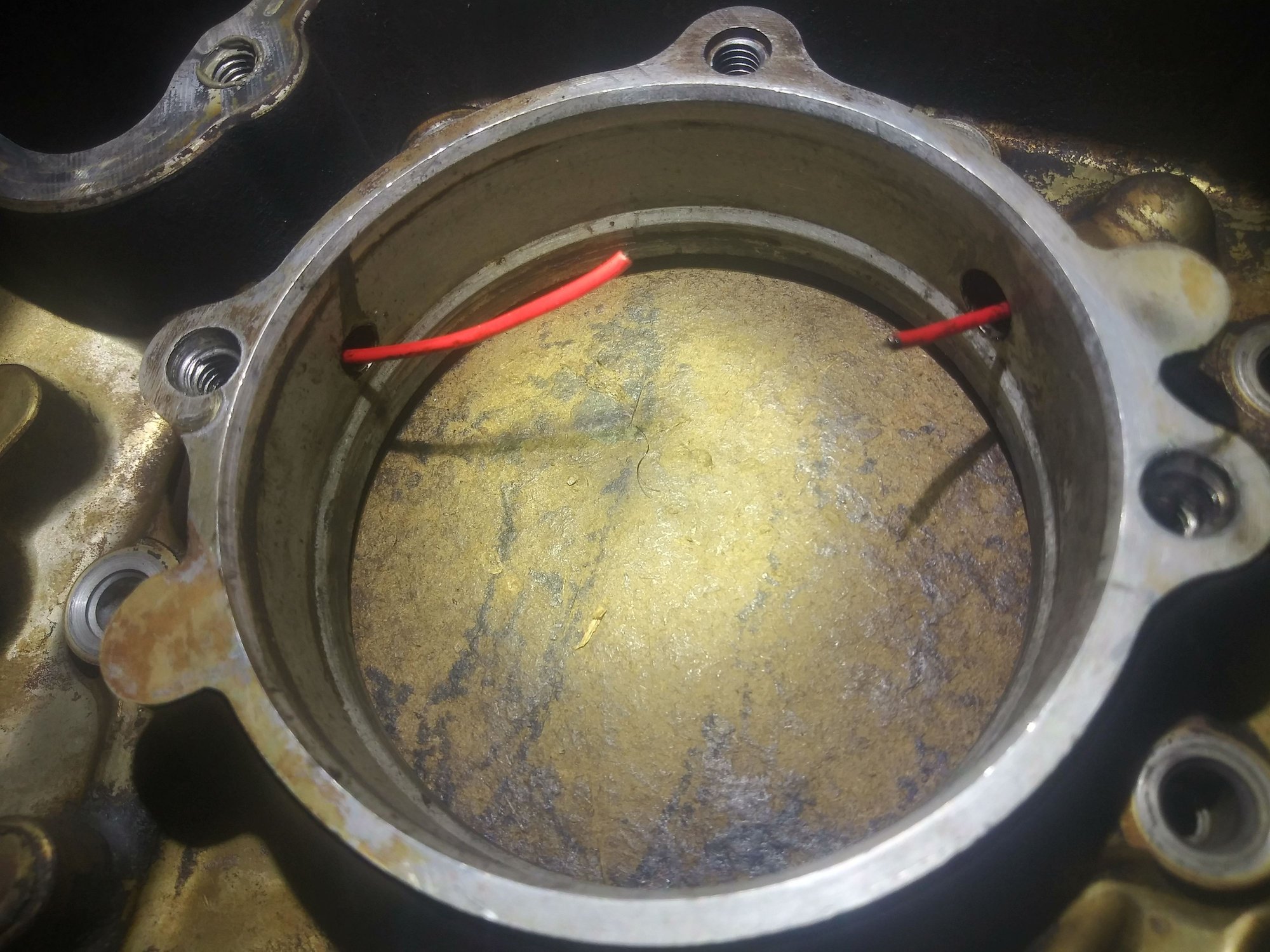

The upper Hole is open... Ive checked 2 other covers I have also. No plug. Are you sure water is infact coming out of this hole and not leaking down from the thermostat housing.? Or inlet.? The area between the seals is dry. Unless the inner seal is leaking.. .. Use the flat point end of a zip tie or something and with the pump removed see if you can clean the lower hole. push it down through the lower weep hole to make sure its clear..from top side down. There is just no way the top hole is leaking but not the bottom. lmk
