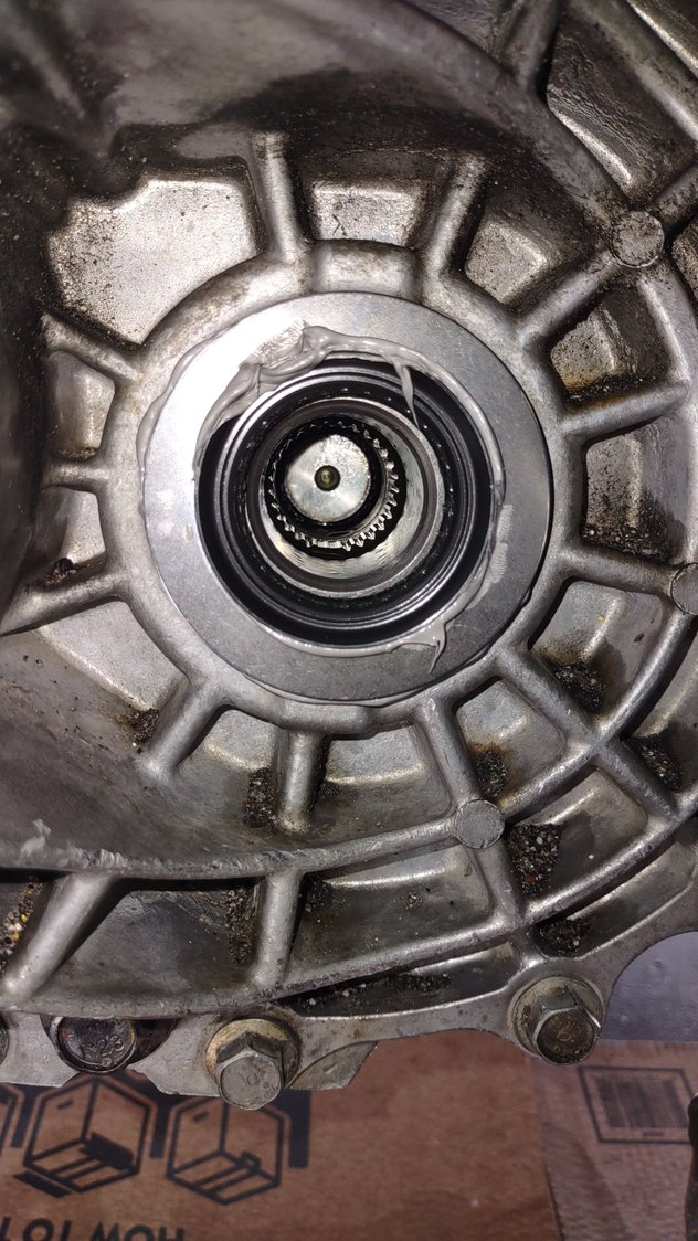

I'm thinking of sealing that out bore with RTV and 70mm washer with the inner bore machined to 54mm to seal the seal's outer bore from the outside...

so I went to Nissan and got another driver side axle seal for 6MT and the same thing happened. the seal fit in the bore so loose that i was able to fully insert it by hand. the passenger side one was really tight.
I ended up using a 2 1/8" (2.125") inner diameter washer and Ultra Gray RTV to seal the outer bore of the seal to the case. I'm going to give it a full 24 hours to cure before I fill the tranny and start up my 7th gen engine for the first time. I also still need a o ring for the power steering pump inlet. the one I got from Nissan is already leaking from just adding fluid. looked thinner than the brown o ring that came on the pump...

I put 70 miles on the car so far since completing the swap and no leaks whatsoever. but I'm not sure I really like this 6 puck clutch though...
