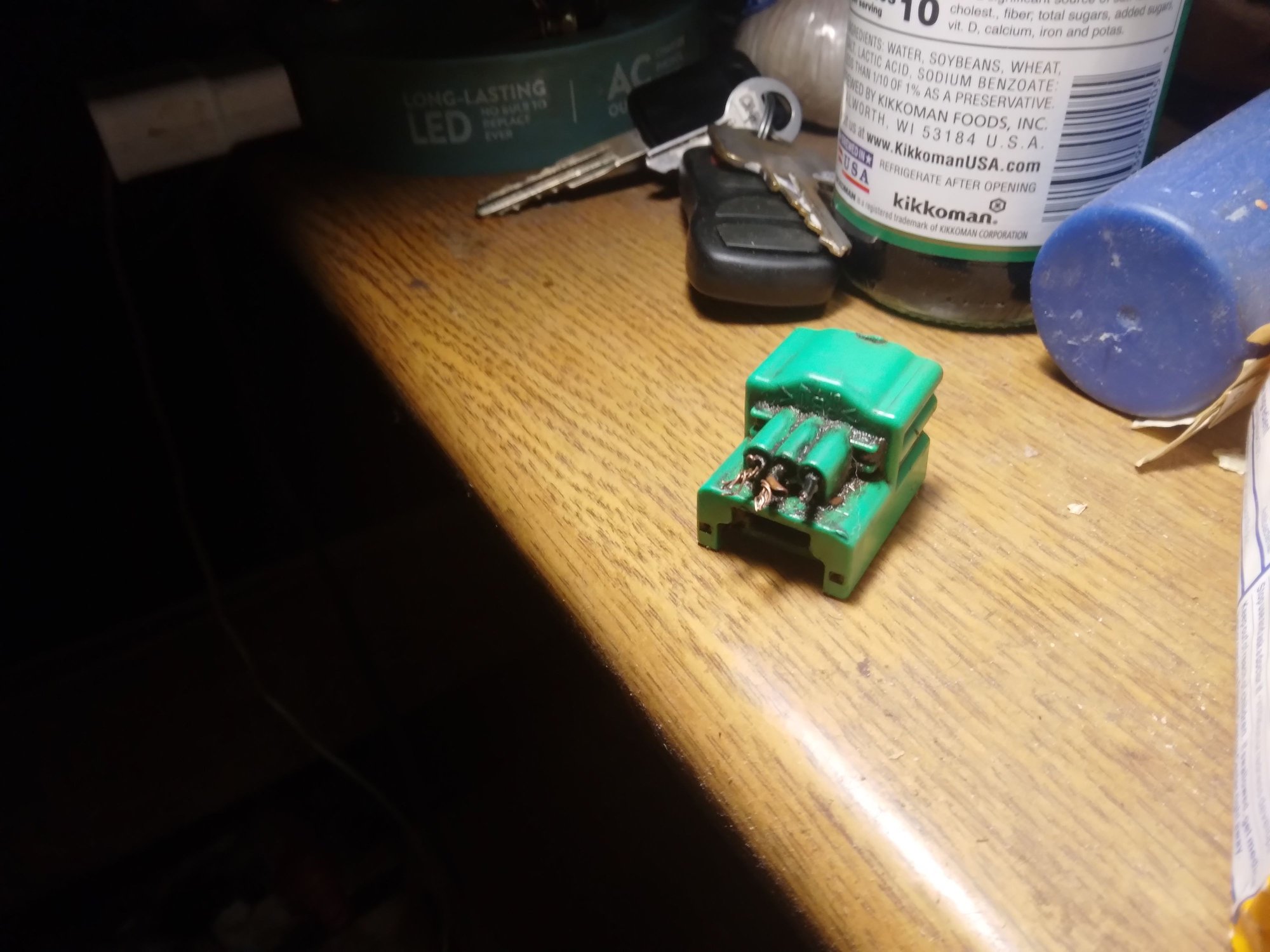

Old Jun 25, 2023 | 08:42 PM
maxipriest777's Avatar
Joined: Dec 2015
Posts: 84
Thanks for the reply.
I examined the wiring harness as you instructed. I found that the three wires that went into
the green connector that attaches to the crankshaft sensor bank(2) had broken away from the connector.
I have attached a photos to illustrate. My most concerning question is.
Where do I go from here to get my Maxima back on the road. At this point it's not even starting.
Any possible remedies are greatly appreciated,
Old Jun 25, 2023 | 10:06 PM

Old Jun 29, 2023 | 10:06 PM
Joined: Dec 2015
Posts: 84
Thanks man.
You rock. That did the trick.
My Maxima is back on the road.
