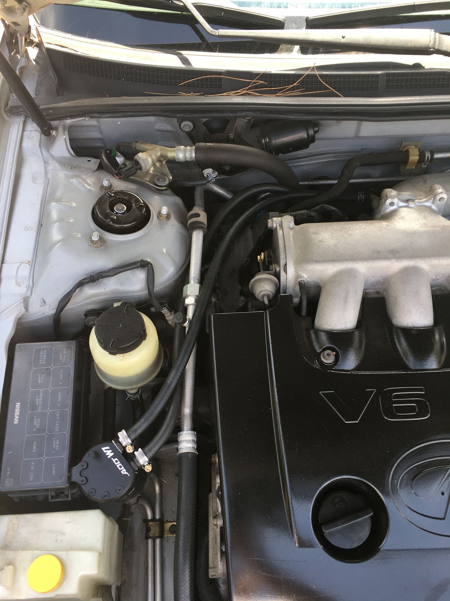

Recently picked up 03 I35 with 127K. No oil leaks top or bottom, however she would go through 1-1.5 QT of Castrol GTX 10W-30 dino oil in 250 miles or roughly one gas tank. Stock exhaust and I'm assuming that the pre-cats are original as well.
Installed new OEM PCV valve (The one on the engine was covered with oil, but not stuck), added an inline ADDW1 closed loop oil catch can, and poured 4-1/4QT of Penzoil 10W-40 dino oil into the motor and I'm happy to report that 250 miles later the dipstick still shows right under the high mark.
Not sure what type of oil was used by the previous owner, the car does have a pretty good CARFAX history of regular oil change. I'll keep an eye on the consumption and either stick with the dino Penzoil 10W-40 or try Rotella 5W-40.
Also, going to re-mount the catch can to a more suitable location.

Update,
At 340 miles the oil level has dropped slightly below the H mark. The oil consumption is still present, but at least it's little bit more manageable.
Curious if the consumption would be reduced even more with a vented catch can VS a closed loop.

Thanks for the info on the vented catch can set up. Right now, with a closed loop, it's catching about a 1/2 shot glass of nasty, oily blowby every 300 miles.
