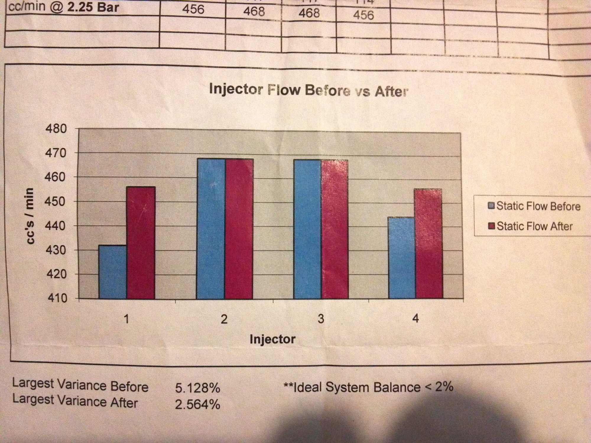

if your injectors worked fine just let them sit in some injector cleaner while doing all the work.
I've used injector rehab in the past when I turbocharged my CRX, they give you a print out like this with before and after in the graph..

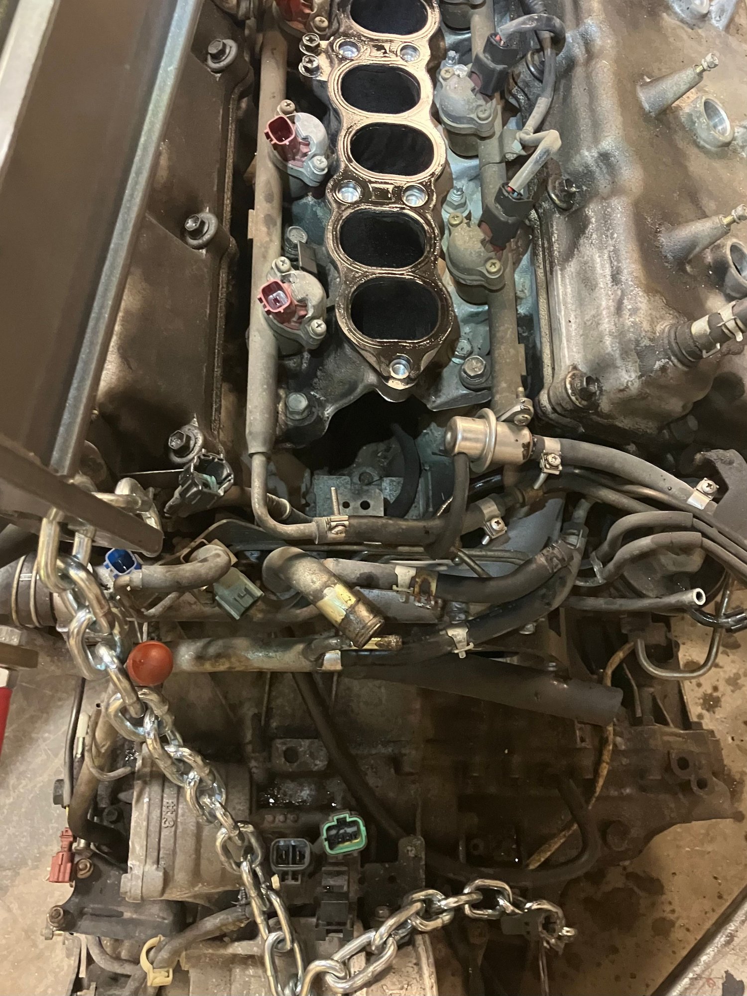

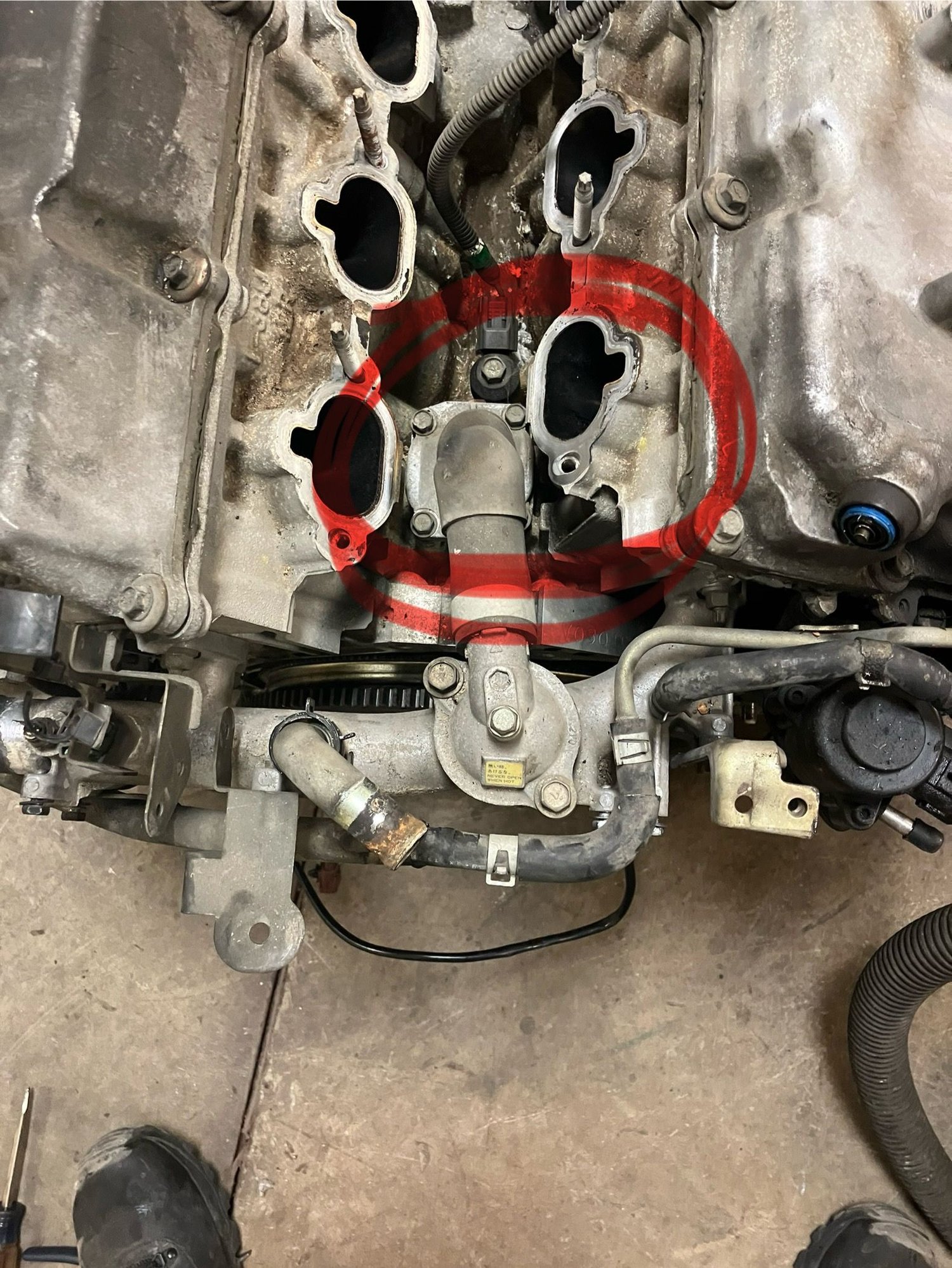

Uncle Ralphs Car's Avatar
Joined: Sep 2024
Posts: 11
Side by side, they look nearly the same. Research on this site indicates they are VQ30 motors.
What is bothering me is this, in my world this would tell me its a coolant passage from the top of the block on the donor motor vs the original one does not have this.
suggestions? Can I block it off or is this game over for this newer engine going in the car?
Thanks!
Uncle Ralphs Car

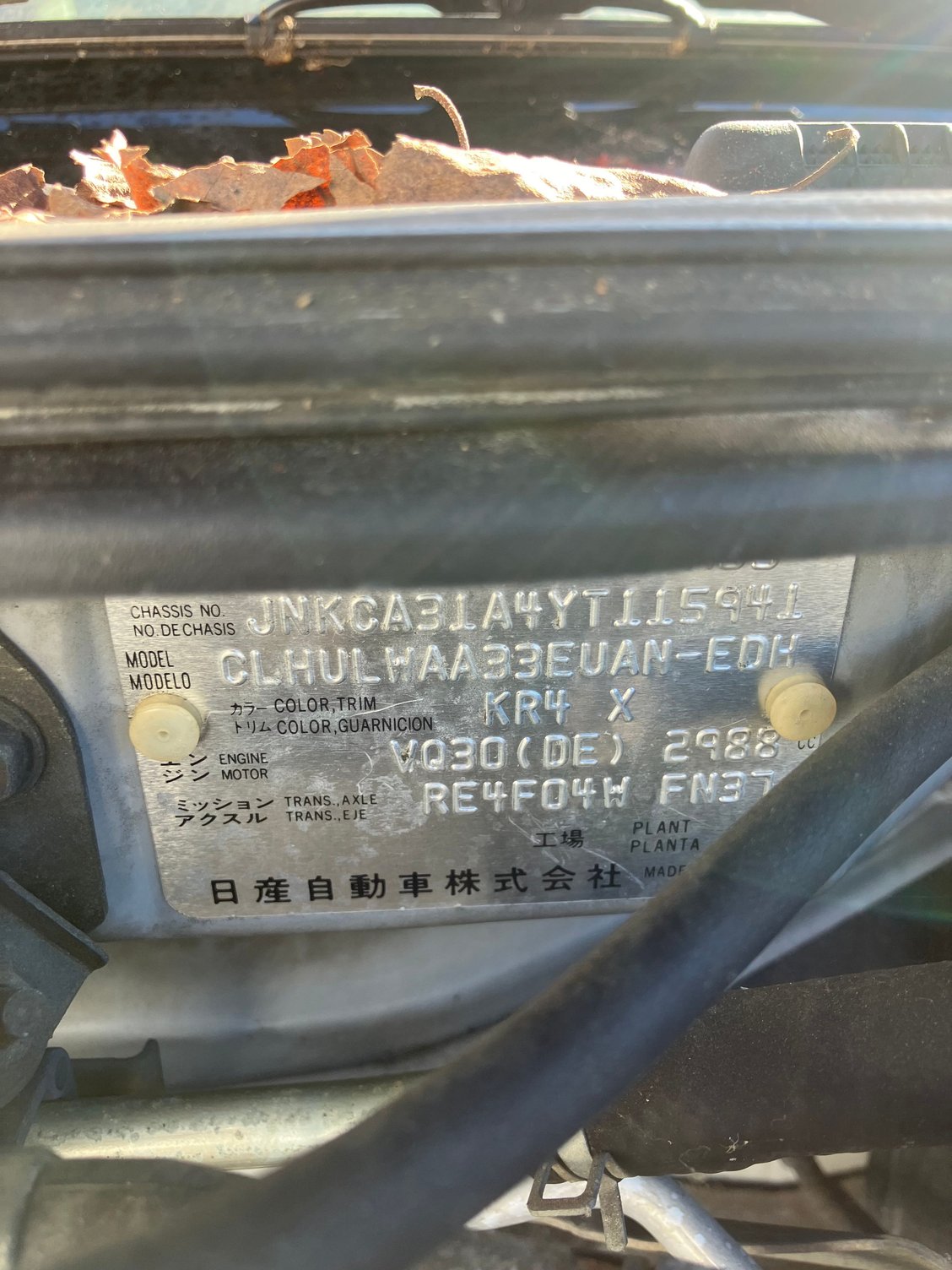

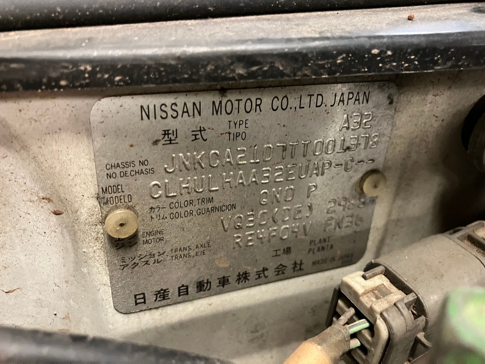

slvr2KSE5's Avatar
Joined: Sep 2000
Posts: 644
your original engine looks to be a 95-99. got a pic of your car or the VIN number?

Old Dec 6, 2024 | 09:13 AM
uptownsamcv's Avatar
Joined: Dec 2012
Posts: 1,345
From: Kissimmee FL
jus make sure all the coolant hoses on the car will be able to connect to something on the new engine.

this is the donor
and this is Uncle Ralphs
Since I am considering using this just as a long block, I don't know what to do with this fitting in the center of the valley pan. It appears to me that it won't work with the older throttle body.
Uncle Ralphs Car
Old Dec 6, 2024 | 10:53 AM
Joined: Sep 2024
Posts: 11
that is my situation, don't see how the donor will work with my car with this bypass (?) in the center of the valley.
Uncle Ralphs Car
Old Dec 6, 2024 | 12:06 PM
slvr2KSE5's Avatar
Joined: Sep 2000
Posts: 644
thats a 96. youre probably gonna be on your own with this one. there may be info out there on swapping a de-k into an older chassis but i dont know of anything.
if you want simple youre going to need the right engine.
