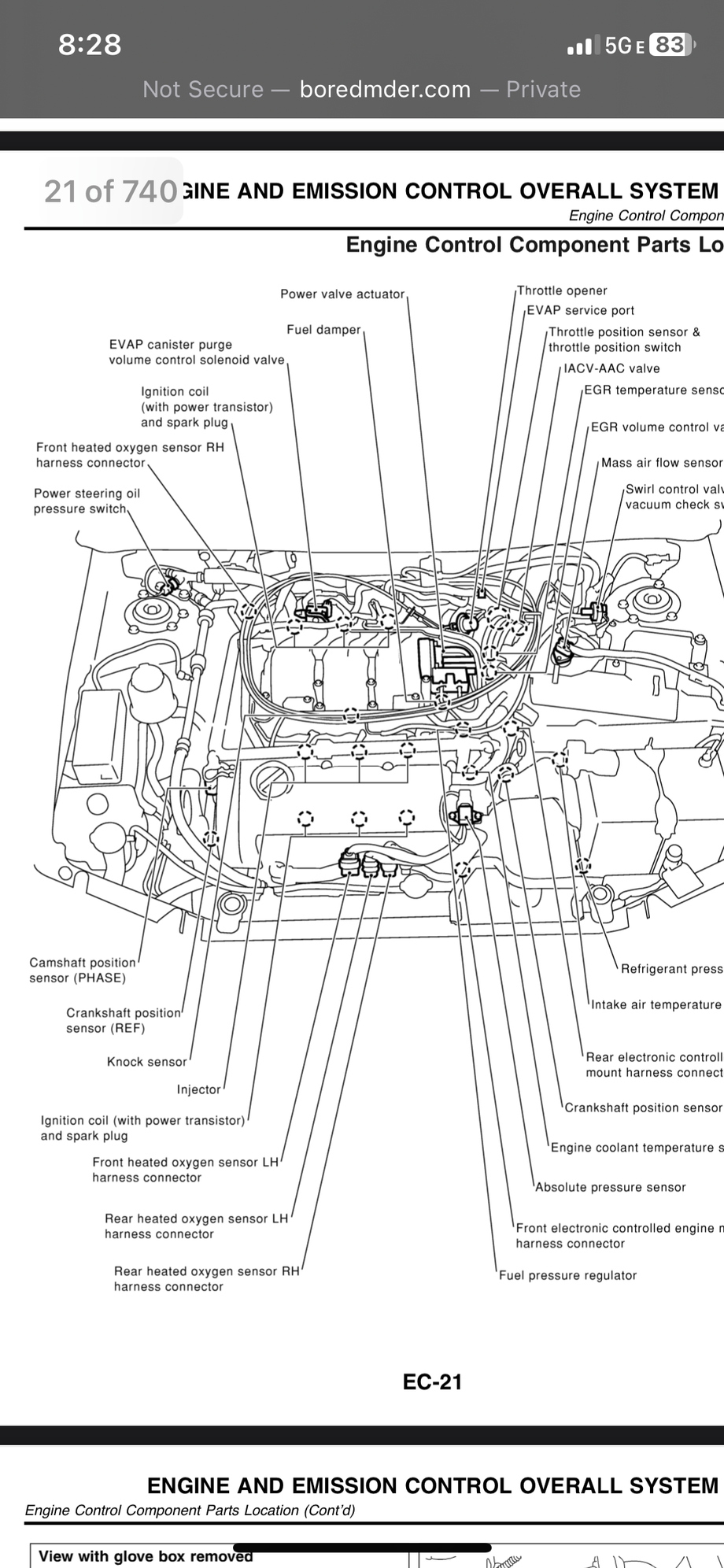

I have to replace oxygen sensor bank 2 sensor 2. Is this a hard job? It seems like it is without knowing. Though I thought it was going to be an easy job.
The oxygen sensor that I got sent to me is the same size and width as what you see in the first most left plug in the engine picture. As you know it will not fit because it is the exact same thing if you can understand what I am saying. I will include a stock picture of it. Also the oxygen sensor wire seems too short and does not look as long as the one in the picture. Not sure if that will actually make a difference in the final outcome.
Also I am including a picture of the oxygen sensor socket that I got. The one that seems like it will not fit on the pictured oxygen sensor because of being too cramped.
I am including pictures all with text on them because I think it will just be easier I feel:

Your side note question about the unplugged grey connector on the battery side of the engine bay. May have once been connected to an electronic motor mount underneath the front of the engine. If so, leave it alone, those are known to cause issues with the electronics.

That O2 sensor is in a tight spot. Cutting the wires and using a closed end 22mm wrench is your best bet. Otherwise take the catalytic converter off the car. On your car the upstream O2 (before the cat. con.) are 3 wire. Downstream O2 (after cat) are 4 wire.

Hi. In the two pictures I address asking if they are or if I have the catalytic converter, are those it? As stated previously, I do not want to cut any wires because I would be risking cutting something I need, I have not performed oxygen sensor removal ever that is why I am trying to get all the information I can. I guess I just do better understanding visually and hands on. Most of my exhaust and I know a catalytic converter is already gone, going towards the muffler. They fell off one day from being rusted.

I have an 02 with a 6 speed, not sure how different the wiring is but on the 02 and 03 the O2 sensor wires are pretty easy to follow when looking from under the car, just change them one at a time and unclip the wire from it's attachment points to make it easier to figure it out. if you remove the radiator fan you will have a better view of how the wiring is routed.
I know the oblong connector with the wires in a row is the upstream or main O2 sensor connector and the square ones are secondary but I'm not sure which is which since my ECU is flashed and I don't run them anymore. just do them one at a time so you don't mix them up, that's the easiest way to do it once you remove the sensor.
as for the sensor itself do not use a wrench for removal you will round out the hew on the sensor. I always use a 6 point 7/8 impact socket for removal and an open end of a 7/8 wrench to install them. they don't have to be super tight just good and snug so the seal doesn't leak which is why the open end of the wrench is good enough for installation.

I feel like there is some confusion here about the catalytic converters in general...
Yes, there are THREE total converters.
There is an O2 sensor before and after converters 1 and 2 (in the picture below) for a total of FOUR O2 sensors.
The sensor BEFORE the converter can be called (sensor 1) or (front)
The sensor AFTER the converter is called (sensor 2) or (rear)
Bank 1 is closest to the firewall, Bank 2 is toward the front of the car.
The drawing below does not show the Bank 2 front sensor, because it is included on the engine drawing, and NOT on the exhaust drawing.
From your earlier pictures and your comments, I'm thinking that if converter #3 FELL OFF and is currently missing, this might be priority no. 1 to replace.
Secondly, hopefully you removed the three bolts that are missing in your picture (notated with yellow Xs below) in an effort to get to the 02 sensor, but if not, this would be bad if they're missing.
You would not want to sit still in this car with the engine running for any length of time.
