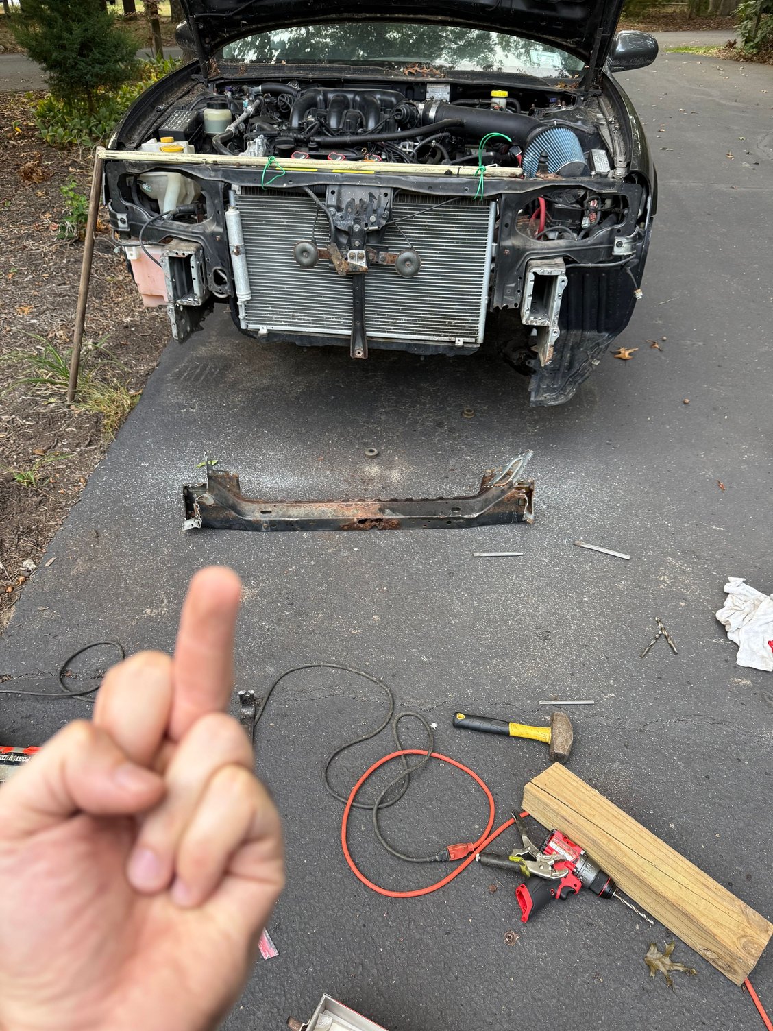

The beam that the radiator rests ontop of is notorious for rusting out due to a design flaw that allows water to collect there. The engine cradle that holds the motor via the front + rear motor mounts happens to bolt up to the radiator support exactly where the rust rot is, and what happens is eventually it breaks completely free and droops down and allows the motor to flop around.
Heres a pic taken just the other day for reference, it is not a fun job lol
