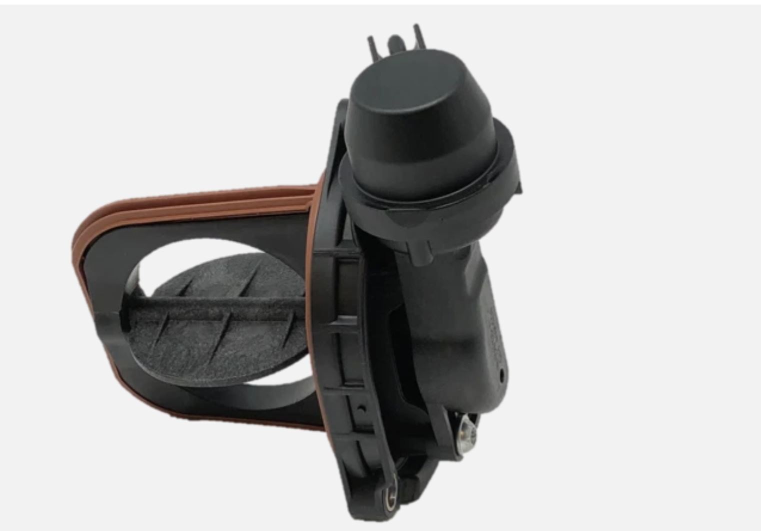

Anyone know if there's already an electric VIAS valve electric actuator to replace the awful vacuum-driven one on the VQ35DE? I was going to make my own, but if there's already something out there for, say, $80 or less, then I'll just buy it.

I know it's the popular mod, but I'd like to keep the full functionality of the VIAS. It's good in theory, but it's plagued with insufficient vacuum, slow actuation, and sticky pumps. It seems to me that a good electrical push-pull solenoid could give the best of all worlds.
I'll take a stab at making one and report back if it works.

Yes, new can, hoses, pump, and solenoid. It functions as designed, but the earlier design (02 and possibly 03) has a responsiveness problem where sudden WOT at low RPM causes it to have insufficient pressure differential to pull the door all the way, and it springs back. It often feels like the car "almost" gets power, then changes its mind. It's much more pronounced on manuals, because you might be cruising around town in 4th and feather the pedal a couple times while passing someone. The first time, you don't have power, the second time, you do.
The later system works much better. A number of components are different, and I don't know what part made it more reliable, but it's still not perfect. I think a solenoid would be appropriate here.
Unfortunately....I mis-measured, and my solenoids are 2mm too short to fully open and close the door. )-: However I realized I have some old 1980's door lock actuator solenoids that are longer AND stronger. They just don't have any attachment at the end. I might still be able to make it work.

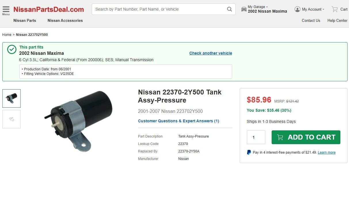

Try locating the plastic one, it seems to work better then the metal ones

Try your local junkyard
https://www.ebay.com/itm/23606559850...QaAnMMEALw_wcB

Hmm, that's interesting. I think I have at least one I can try. I'll bet the vacuum pump is internally half the size on the plastic one. That would give it a lot more cycles per vacuum tank.
