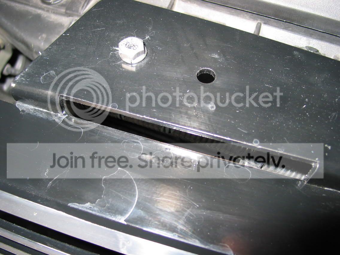

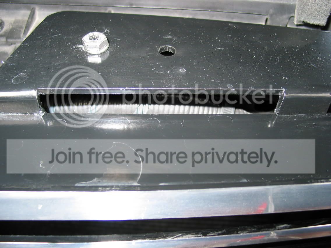

Not sure if this will help you ? but here's a few pics that i took last year of under my hood. You might see what you referring to (this is the closest to the centre on the driver's side pin):
He're a bit of info on my TRENZ install that might help you ???
Good luck with it.
Bob

That is much appreciated, but I need to know if there is a support of any kind under that clip which is near the left center of the vehicle. The one near the right center has it. It's almost as if I need pics from behind the grill facing to the front of the car.
Well I just took another look and I was intially mistaken about the center clip on the right attaching to a bracket. It does not. So then, the only 2 clips that hold the grill to the car are the outer 2. So I'm not missing anything structural (good news).
So how do you get those stubby little clips under the 'bumps' that appear to align with a couple of holes to snap in, they seem real short. And I also noticed that the tabs on the lower part of the grill are broken off of my grill. Are they supposed to insert downwards or towards the direction of the rear of the car?

and Bob, where are the 'custom' bolts you installed shown in the 3rd picture? I dont see them, so it's a little hard to tell where you put them in relation to the grill.
Doesn't the Trenz grill use the outer 2 supports? I see air between the central grill and those outer 2 holes...dont I?
If you look here at this pic of my grill you can see the 2 silver wings extend out to the outer holes, which I did not see on the 3rd pic you posted.

The TRENZ doesn't design doesn't have the farthest to the outside holes. It stops right after the second from the middle. So you do see air.
I replaced the clips for the bolt in the holes closest to the centre. You don't have to do this with the stock grille.
The tabs fit into the 4 holes on your bumper in the direction of the back of the car.
Let me know if you need more info.
Bob
