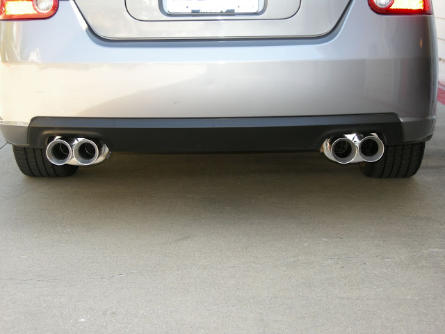

Looking sharp. That is my one complaint about the Nismo, it doesn't have dual tips.
Originally Posted by Gollum67
You are right Ill. The Magnaflow did kill some of drone but not enough. The cruise missile is back on.
So there you go kids. I went from a straight pipe to a small resonator and back to stock.

This clip is with the Magnaflow mufflers/resonator:
http://video.google.com/videoplay?do...15790029&hl=en
Since I tacked on the stock resonator back on, about 85% of that fabulous growl is gone. All you hear now is the Fujita CAI and a little bit of the muffler. That resonator is huge for a reason. My car sounds like this now. Very similar even with the Magnaflows (Not my vid).
http://www.youtube.com/watch?v=fYldqmlz-WQ
