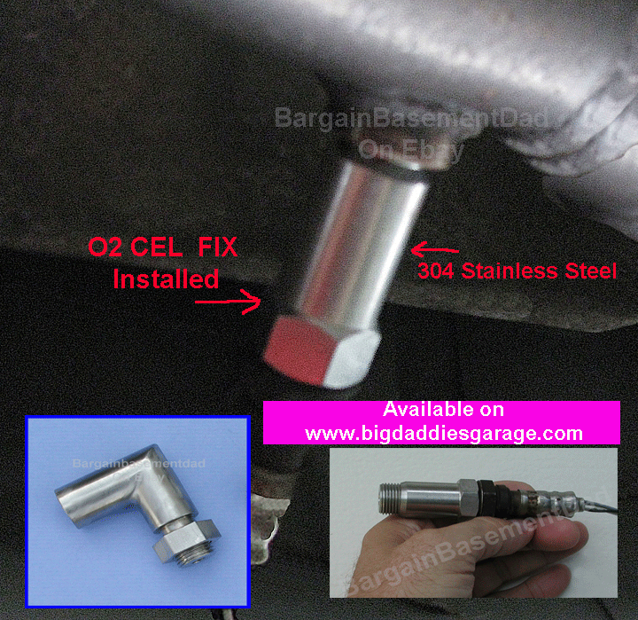

Ok. Don't get confused, but this is what the tech explained to me. The sensor on the rear header toward the firewall is triggering the front sensor to come on as well. However, my primary culprit is the rear one. These things are so dang sensitive. Here's a pic of the adapter off of ebay. It's like $15 shipped.
Old Jul 18, 2009 | 03:06 PM
Oolatec's Avatar
Joined: Feb 2007
Posts: 1,578
From: Chicago suburbs
Yeah I've seen those spacers before. I wonder if that would work on our cars.
Yes very sensitive. So did you order the adapter already?

The tech there's this place called Lightning Motorsports locally that may have them. They will call them on Monday since they were closed today. If that place doesn't carry them, I'll order a pair on Monday. The tech says I only need one but I rather be safe than sorry. It should work since these O2 sensors have a universal thread. I figured if I ordered them today, they probably wouldn't ship till Monday anyway.
Old Jul 18, 2009 | 08:29 PM
Oolatec's Avatar
Joined: Feb 2007
Posts: 1,578
Yeah they are pretty cheap too, so if it doesn't work, oh well... I'm interested to see what kind of shape your primaries are in as well. My front one was all covered in carbon and was totally trashed.

I ordered a pair. However, I got one which is the length of the one pictured and another one which was about half the size. I did this because I wasn't sure how much room there would be for the extended o2 sensor. The tech said I should order one of each size just to be on the safe side. I should get them before Friday. I hope to get one of them installed then. The reason I'm only planning on installing one on the rear primary sensor(by firewall) is because that's the sensor that is tripping both of my primaries. If I do end up installing both I will let you all know. The next update will be about late Friday afternoon. I'll be praying hard that it works.
Smart idea to get two sizes!
