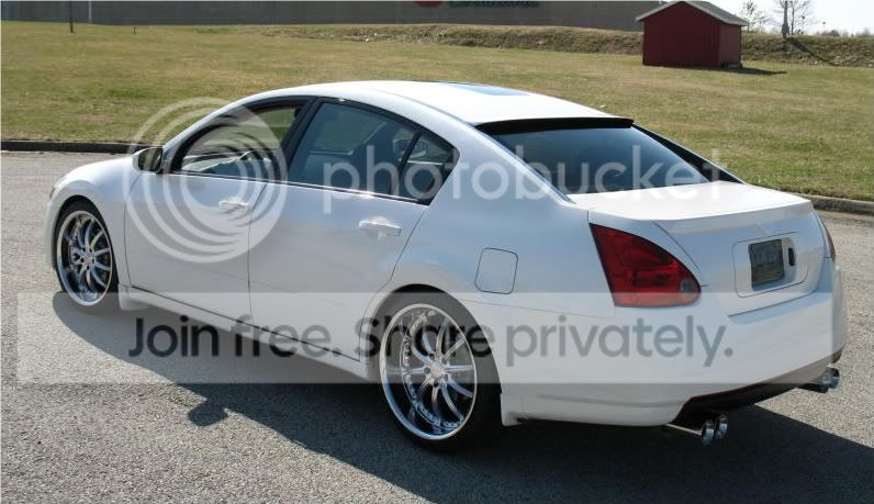

this is sort of what I'm going for, but with a lip and not the big price tag:
http://www.mcdesignwhips.com/apps/webstore/
Hero...what do you mean by offsets too low?

Most staggered setups are 20x8.5 and 20x10. If thats what you're planning on running, try and stay close to +40 with the offset. One of my staggered sets are +38 in front and +42 in the rear and I dont even come close to rubbing. Also, if you're going to buy wheels new go with a 66.2 center bore to eliminate the need for hub rings.

I run a 245/35/20 in front and a 255/35/20 in the rear.
A lot of other guys run a 275/30/20 in the rear but usually rub or have to roll the rear fenders.
I have had ZERO issues with my setup... (Im also dropped on Progress/Stock)
