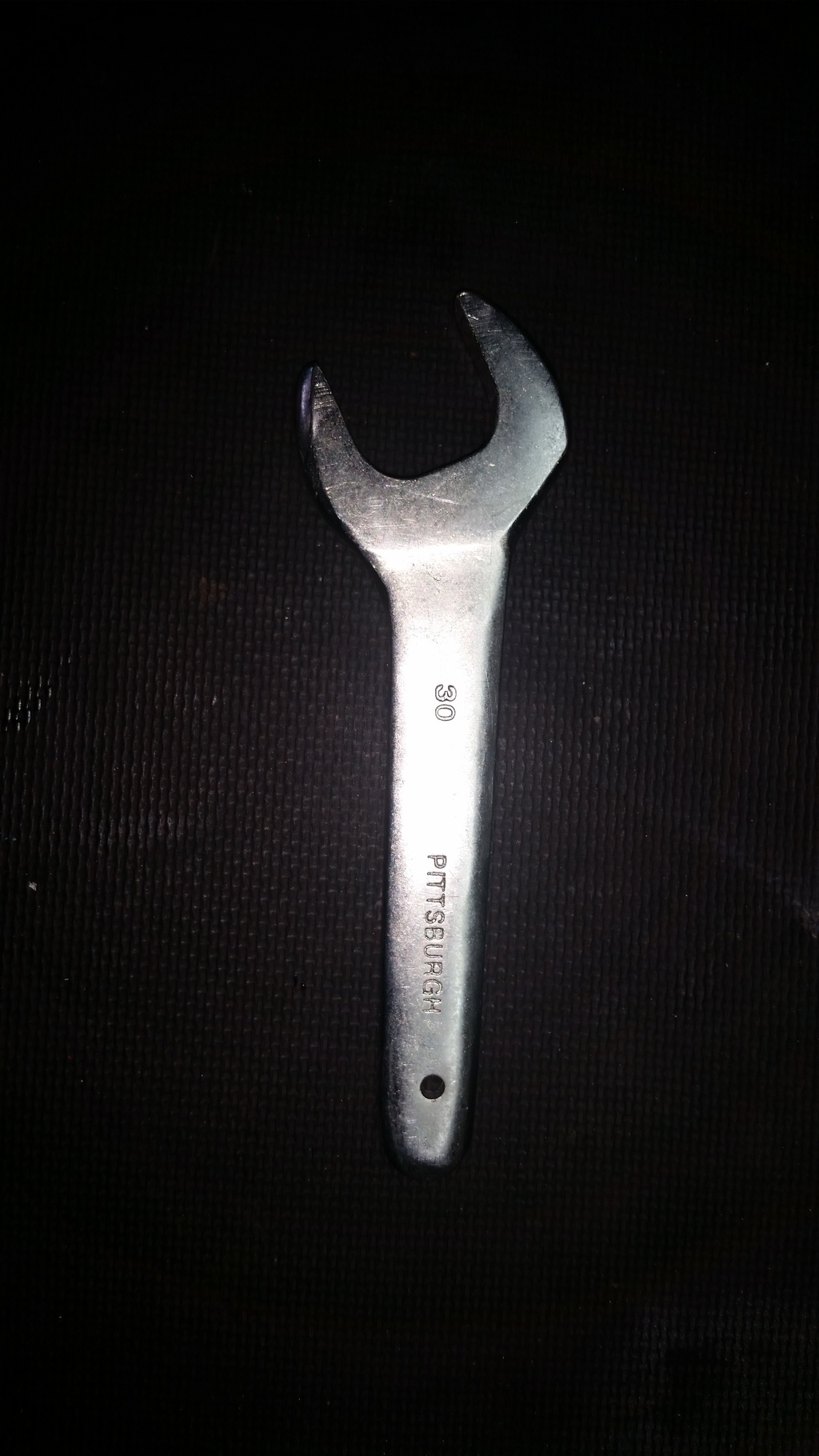

If anyone would like to know, the size of the large line at the rear of the EGR valve is 30mm. I found a wrench that worked on the line at Harbor Freight. See pic. So I got the valve off and it looked fine. Cleaned it anyway. I checked the resistance on the motor, all four coils have the same resistance so I assume it's good. I checked the resistance on the temp sensor and watched the resistance go down when I held the sensor end between my fingers. So I assume it's good as well. I didn't find and evidence of the cat braking up and getting caught up in the valve. So I cleaned the tube and the temp sensor and cleared the code. If the code comes back, I'm going to change the temp sensor even though it seems good.
