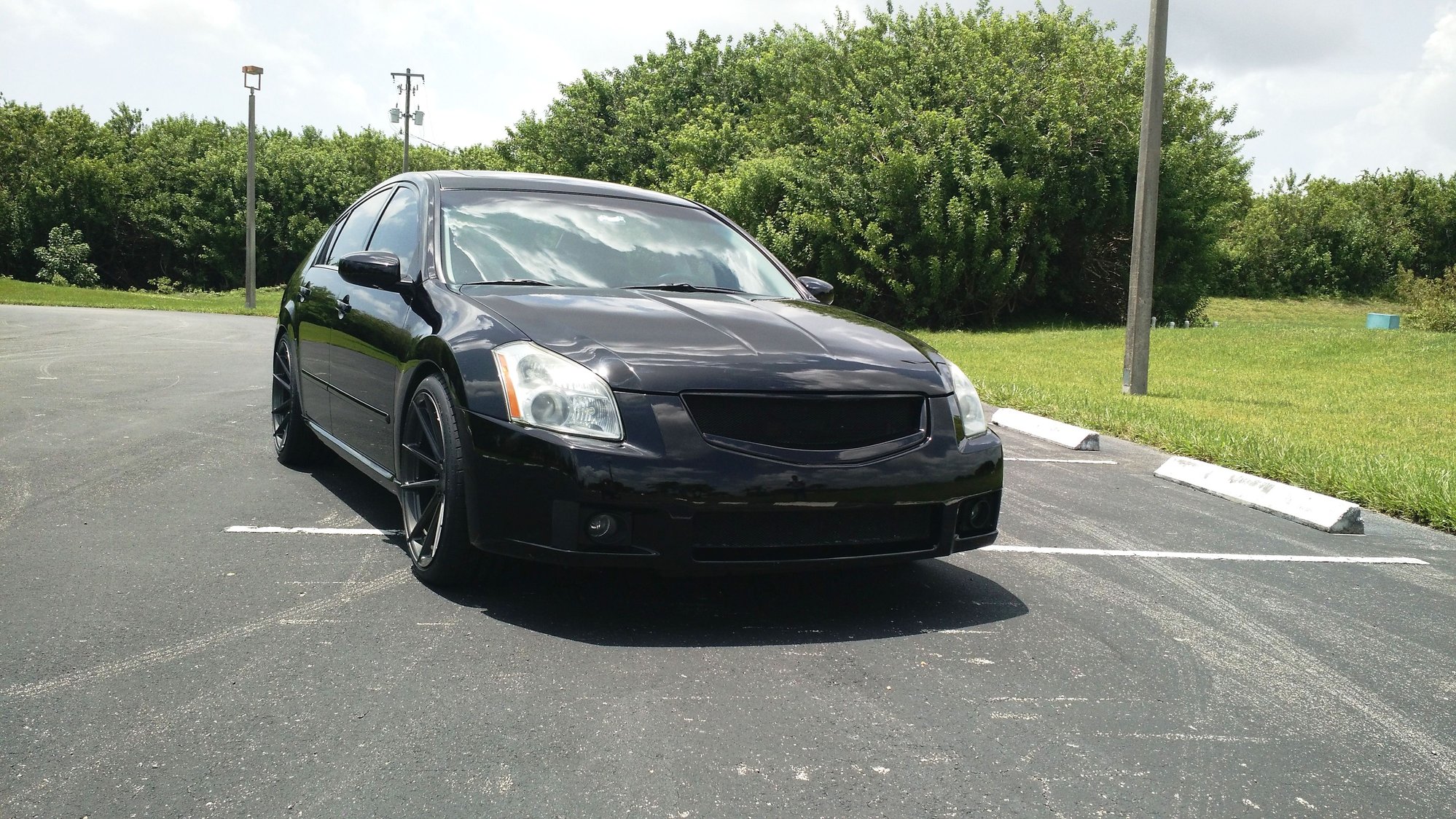

I have not posted on this site in a long while. Updated my wheels and had the car repainted.
Model: TSW Bathurst Gloss Gunmetal
Tire: 255/35/20 Falken 453
I got these wheels from Jason@getyourwheels.com great guy..He was very patient with all my questions. He was concerned about Front brake clearance because of the Concavity of these wheels and the offset so he sent me some free 5mm spacers with my order. I had to pre-order these because they were going like hot cakes..Wait was supposed to be 2-3 months but I got them in 1.5 months.
These TSW's are Rotary Forged and are light..TSW claims 24lbs for the 20X10 I measured them at 51.4lbs with tires and the old setup Concept One 18x9 with tires were 49.7lbs.
For the fitment I did end up needing spacers up front as the brake was less than 1mm from hitting the spokes, so I used the 5mm ones but will probably order some 3mm as there is a very slight poke up front with the 5mm..Also note that I did cut the axle down when I had my other wheels in order for the caps to fit so a 3mm might not work for those that have not done this.
For the rear my fenders were also rolled from a previous setup with 20's.
I have not experienced any rubbing in front or back..but I have not driven with a full load yet so rubbing in the back is still yet to be determined.
Well enough rambling..on to the pics..
