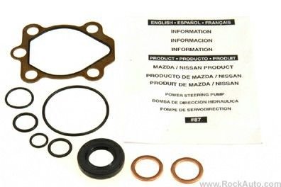

Has anyone found, that when the leaks have developed near the hi pressure fittings, the leak can be fixed by replacing the O rings and washer instead of the entire hose?
If I see no evidence of leakage at the rubber hose crimp connection, then could it be that the O ring and washer are all that's needed?
I've found that this is a common problem on the 6th gen (mine is an 06 SE w/ 118k mi) and I don't want to yank the entire hose when it is just the washer/ring that's bad. I haven't been able to crawl under and do a thorough leak investigation yet but want to understand where these things typically leak.

Hello if you make the time your ring kits only about 15.00 but if you do it wrong youll just end up going back in id just rplacee it with a new one heres a link
https://www.rockauto.com/en/catalog/...ring+pump,7380

Well I got a Gates hi pressure hose on eBay for ~$70 and had my local shop put it in for $200. Problem fixed.
