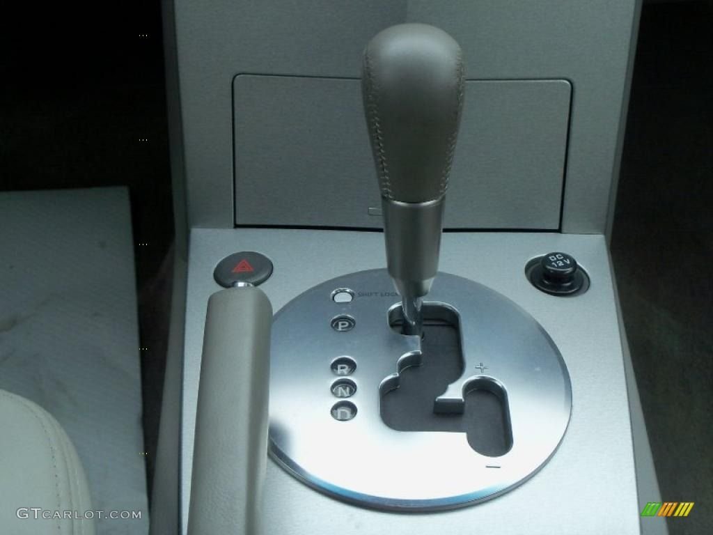

Old Feb 15, 2017 | 07:56 AM
myownworld's Avatar
Joined: Jun 2012
Posts: 56
From: Tennessee
Easy way tell to 4 spd vs 5 spd.
4 spd looks like this...
5 spd looks like this...
Old Feb 15, 2017 | 09:45 AM

Yep. He has a 5AT.
