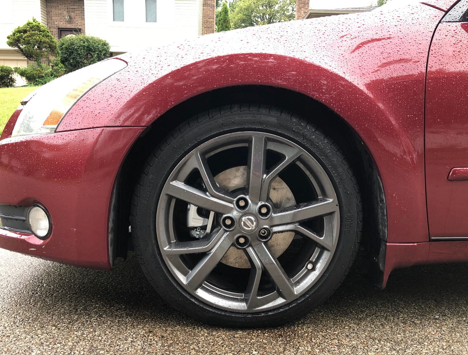

Old Feb 25, 2020 | 07:26 AM
RichardIV's Avatar
Joined: Dec 2019
Posts: 27
From: Cincinnati
I'm not the smartest when it comes to the specifics of wheel sizes, but its a positive offset from what I've found. They're relatively flush, but I was flirting with the idea of putting on some small spacers to get them perfect. Here's some pics from the front, back, and straight on.
