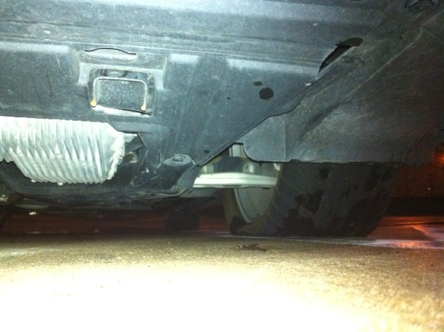

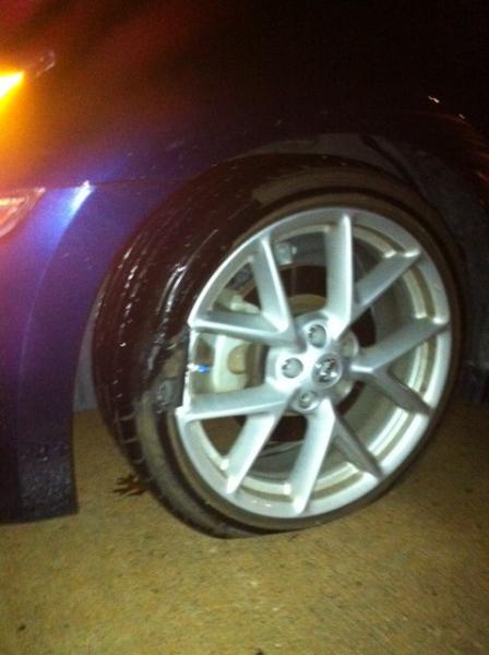

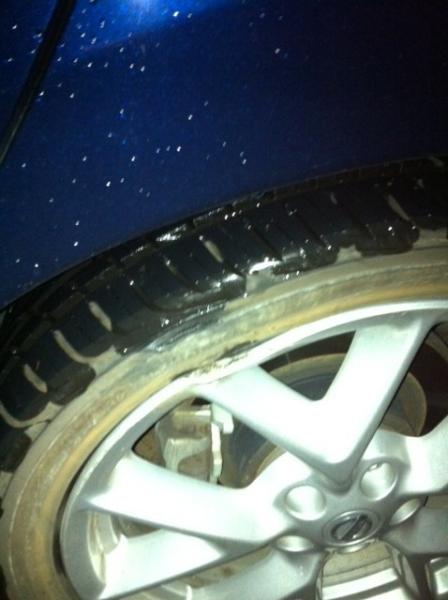

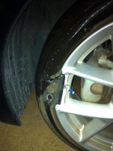

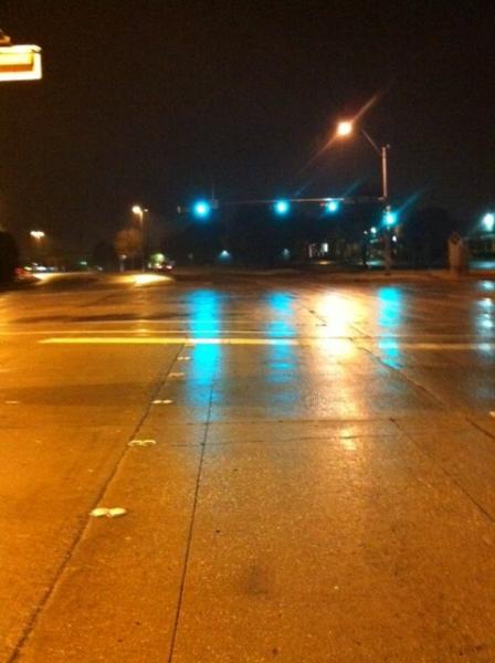

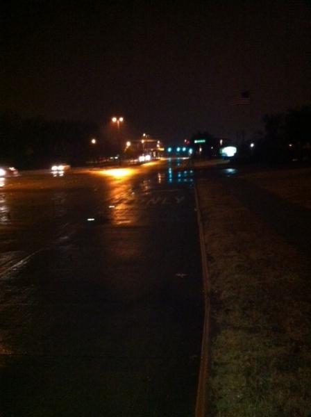

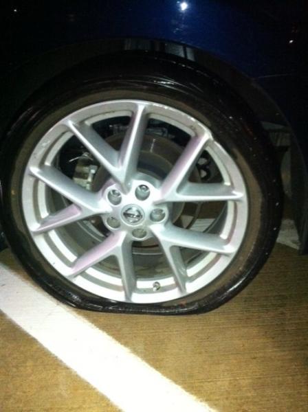

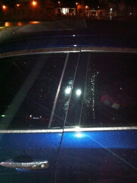

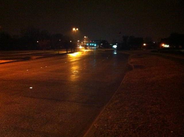

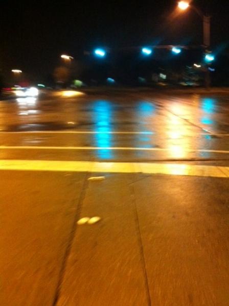

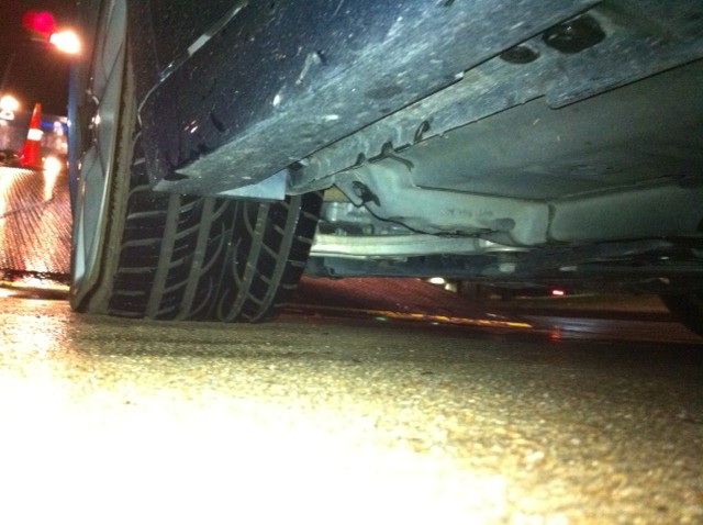

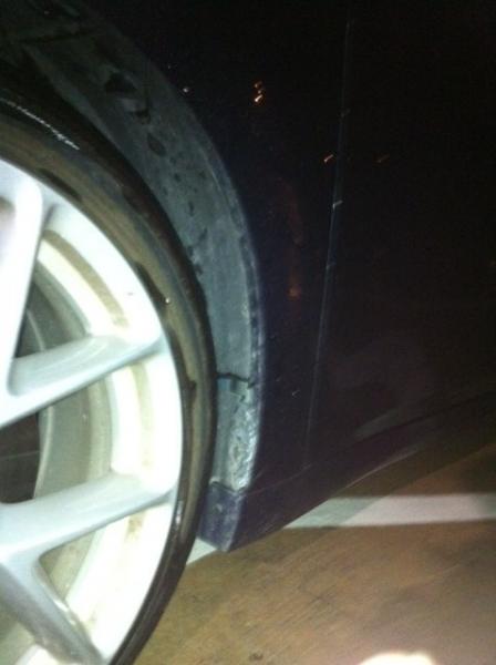

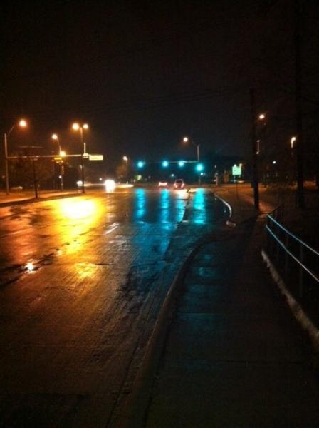

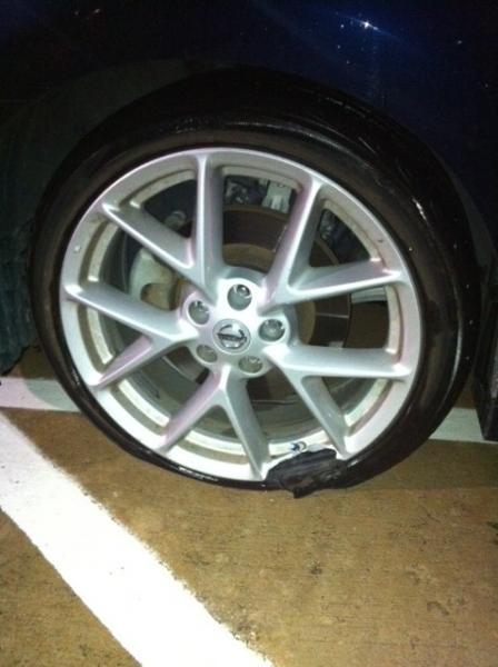

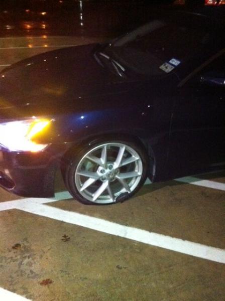

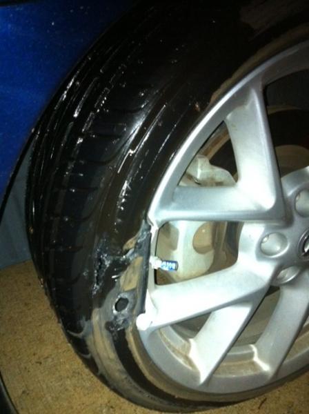

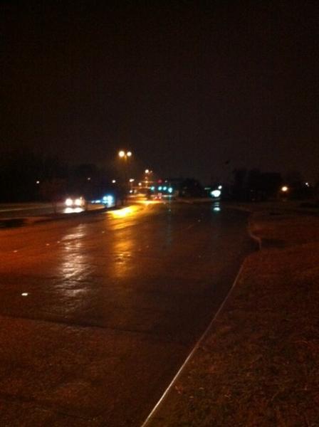

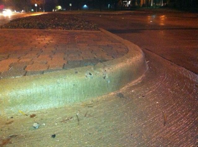

Had an unfortunate incident with a poorly placed median late on a wet Xmas eve this past holiday. Came through a kink in the road at a t intersection and the street light hid the location of the median until I was halfway through... ;( I wasn't able to avoid it and took out both left wheels, tires, and front left suspension. Now as soon as i got out, the exterior looked ok, but my door closed with an audible thud not present before the incident. In comparing panel gaps, the door is out of alignment, as is the fender (hood/fender is larger than it used to be, door/fender is off at a slant, and the doors' chrome trim no longer aligns). At first the shop didn't even notice, as when they called to give me a rough estimate of needed repairs, they only mentioned the wheels, tires and suspension. When i brought the thud up, they're comment was "oh... Really? We'll take another look in the morning". They didn't call back for 5 days (New Years weekend), and i had to call them. They said they were waiting on all the suspension parts before starting repairs. When i asked about the body panels, they said they just needed to be adjusted. They said they'd call if they ran into anything else... I'm expecting they're gonna be calling. Thoughts? Max is a lease... So if they repair it, I'll be going over it with a fine tooth comb, as there wasn't a thing wrong prior aside from a few door dings. First claim that was my fault in almost a decade... If not more. Insurance is covering most of it... I just don't want it back if she isn't right. ;(
I'll post shots tomorrow. FYI, the 19" sport wheels don't stand up to much. Hit the median at about 30-35... (road was 45). Ripped a 5"+ chunk out of the edge at the tpms sensor... ;(. Tires were only 5k miles old too! Yoko AVID Envigor AllSeasons...

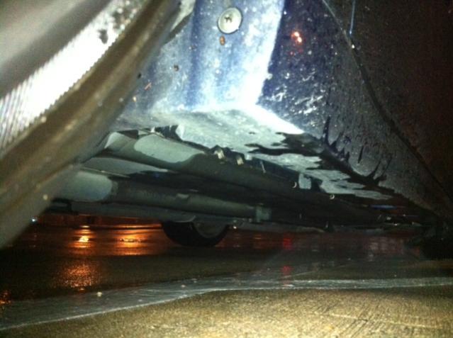

Well I'm a little irritated with the shop. They're of the opinion that its impossible to have damaged the unibody from the impact of the accident... with how far back it cocked the wheel and the chunk it took out of it... plus the door misalignment, I'd feel better it they at least checked it. I'm worried they'll get it repaired and then stick it on an alignment machine and it will be out of wack and I'll be waiting longer. I only have 30 days of rental car coverage, and I'm halfway through it already. Ugh. Anyway, on to the pictures...

They're probably right, don't forget they do this for a living. Not saying they are 100%, just saying give them some credit.
I can't tell from the pictures, did the area below the doors, commonly called the rocker panel, get hit? If the dogleg of the fender, (part between the wheel and door) got hit from underneath, that could cause some panel movement around the hood. The rocker being hit could actually move the middle hinge pillar, but it would have to be a good hit. You'd might actually see the roof ripple somewhere near the pillar...
All that said is just speculation. Without actually seeing the car and feeling it out, there's really no way anyone here could tell you more than what the body shop is telling you.
Again, as long as everything feels good, and they warrantee the work past the length of your lease, don't sweat it...
