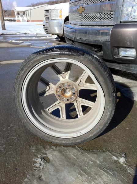

19" SV Sport wheels + pothole = pwned
It was already slightly bent... couldn't dodge a pothole and now this... won't even hold air. I also have another very minor bend in the rear. Hell I wouldn't be surprised if they are all bent!
Horrible choice in tires Nissan.... and it appears the wheels aren't really that strong. These potholes were huge or anything.
Finding a replacement was fun too... 300$ Looking for a new set of STRONG 19's or a set of 18's. Will go with a beefier tire as well.

Can't blame the tires here. I don't know of any 40 profile tire that should still be used after an impact like this, whether it held air or not.
A pothole does not have to be big to ruin tires and rims. When I hit the sharp edge of even a small (say 4 inches deep) pothole at forty miles an hour in a car with alloy rims and low profile tires, I expect I might lose the tire and/or wheel. Somtimes I am lucky, but sometimes I am not.
The bend in your rim would require a hole at least 4 inches deep, probably deeper. These 7th gen Maxima tires and rims are definitely not designed for bad roads.
With the weather showing in the background in your photo, 16" steel wheels and 65 profile winter tires might be a better bet until spring arrives. The higher the profile, the taller the sidewall is with respect to tire width. Taller sidewalls give more flex room when hitting bad spots in the road, which gives more protection for the tire and rim. A 40 profile tire has very little sidewall height, hence very little flex room and no protection.

Thanks for the comments guys. Normally I dodge any significant pothole I can... this one was on the interstate with heavy traffic... it was either the pothole, another car, or the wall
I kept higher pressure in the tire -- 40psi for this reason. The tire was damaged as well... I think after driving a couple feet and realizing the tire was flat did that.
I bought another stock wheel 100% straight and it should match up decent... I'm looking at getting some wheels tho. The 19's look great but I thinking about 18's which will give me a little more tire. No matter what I need more tire... and if I can get a cheap/ugly set of wheels with even more rubber it would help too... Lots of potholes here in the winter time.
I have the forms to file a claim against the state to have them pay for damages. I need to get estimates from a dealer for this wheel and the rear wheel (minor damage) before I can be prepared for court. I'm going to do this soon... and if I can win my case (I don't see I wouldn't) I will be getting all new wheel's and tires.
I don't have as much time as I used to... but I need to start searching around for wheels I like in 18" and lighter than stock (shouldn't be hard)... Looking for something gunmetal or darker... hoping to pick up some mpg and performance along with looks... not asking for much lol.
Bottom line. Avoid potholes at all costs if you have the SV Sport wheels!
