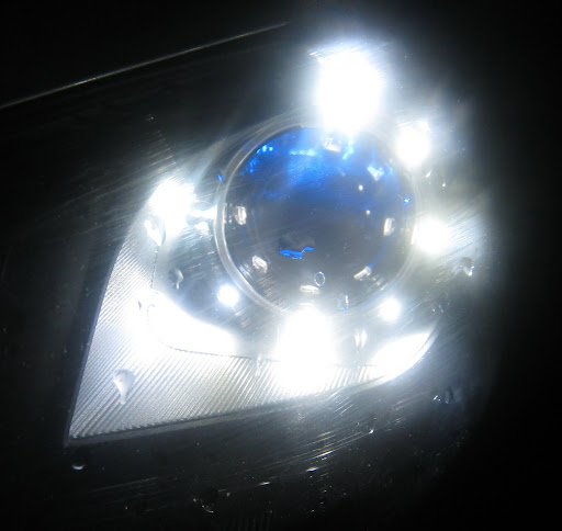

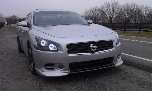

So to summarize, I cracked the housing and went to town. Sanded, primed, and painted the housing pieces matte black on the trim and radiant silver on the smaller pieces. Tinted the amber reflector with 1 coat of nightshade and a few coats of clear - still reflects perfect. My original light mods were a custom Iron Man using fabricated 6k white LED's, a CCFL halo on the projector, and a color changing demon eye.
I updated this mod by retrofitting the high beam with a projector shroud, painting both the low and high beam shrouds matte black and upgraded the CCFL halo to dual Umnitza Orion V2 LED halos.
I pre-wired everything with wireless remotes, went outside and put it all in my car. Here are the results...

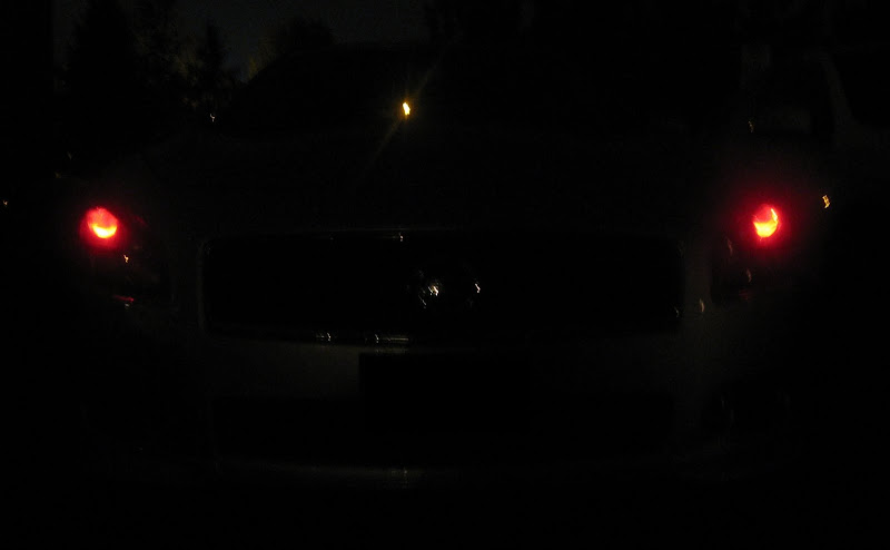

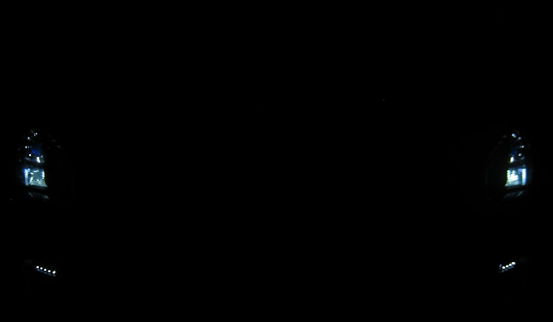

here are some night shots, i did the best i could with my terrible camera ill see if i can borrow a nice one with a tripod and take some properly. these just do NOT do it justice...
Angel eyes
Iron man
Iron man + angel eyes close up
Iron man + angel eyes + red demon eye
Iron man with blue demon eye
Angel eye with blue demon eye
Iron man with green demon eye
Iron man + purple demon eye
Iron man + green demon eye
Iron man + blue demon eyes far shot
Red demon eyes (TERMINATOR)
Blue demon eyes
Iron man + blue demon eye + LED strips + parking lights
Shot from above, right side only
And last but not least...everything...Iron man + angel eyes + 8k low beams + parking lights + 6k LED strips + 6k HID fogs

Quote: list of products used?
Awesome job btw.
Paint : dupli-color adhesion promoter, dupli-color high temp matte black, k12-radiant silver, VHT nightshades, dupli-color high temp clear, 3M scratch remover, microfiber rags for polishing
Lights : LEDs from Oznium, ordered the Superflux that were not pre-wired cause the pre-wired definitely do not fit, CCFL I got through a friend, resistors from Oznium
Wiring : soldering iron, solder, wires, heat shrink tubing, high temp epoxy
Quote: WRITE UP!!!!!.....PLEASE!!!!!!!!!
BTW....LOOKS SICCCCCK
thanks man, but honestly I don't think i can do a complete write-up it was an immense amount of work. most of it was just knowing how to solder and how to drill plastic without cracking which you can learn on Youtube or Google. the rest was just me messing around in MSPaint, seeing what looked good, and then test fitting everything on the shroud and seeing how it fit which I obviously needed the headlight cracked open for. I broke several LEDs in my test fitting and had to rework my project several times to get the wires/LEDs/resistors to fit, so it was definitely hard. if you dont know how to solder LED's and resistors then I'd stay away from this project until you learn - it was a ton of custom fabrication in regards to the lighting.
Quote: One word.......DAMN!!!!!! How did you figure out how to do that type of stuff man? All I can say is that you got it DOWN man. Truly a custom set of headlights.
well i talked to a few other members to figure out how to crack the headlights, and learned how to paint using Youtube and testing on my engine bay panels last month. the rest was just me knowing how to solder and doing my best to make stuff fit in the tiny little projector we have. couldnt do a complete iron man all the way around, but i like mine i think it looks like angry eyes. i should have installed the CCFL tilted too so the dark part would match up with the dark part of the iron man...but oh well. it's not perfect but i think it turned out good enough for my first headlight project.
Quote: holy ****? how did you do this? tell us now!!
lots and lots of planning, close to 3 months of gathering materials and planning how everything would come together. wish it was as easy as saying "just buy this LED ring and glue it to the back of the projector" but it wasnt...was lots of soldering and cussing when things broke and re-soldering. lets just say im lucky i bought a few extra LED's.
