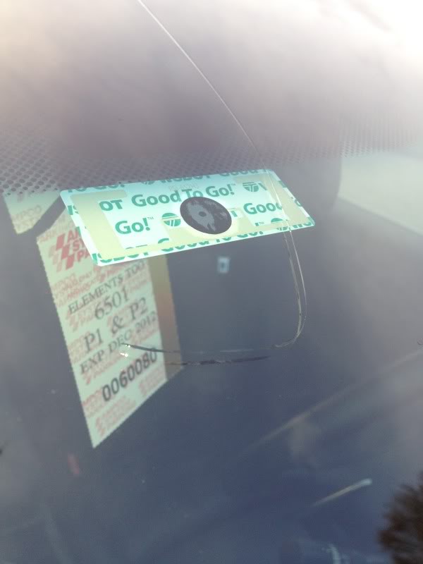

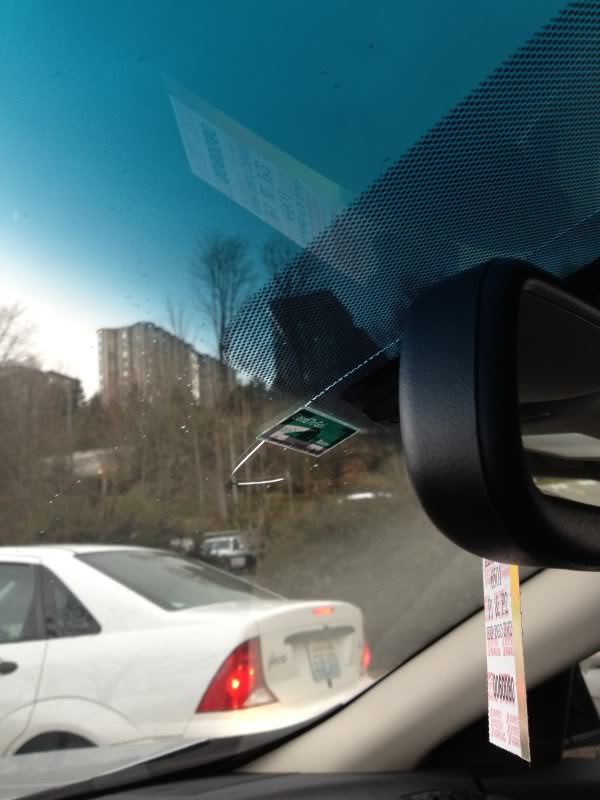

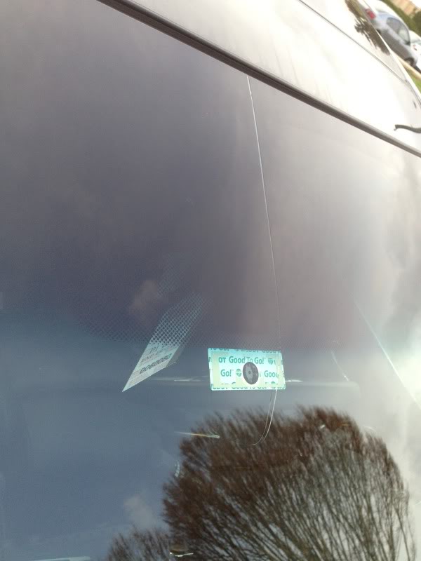

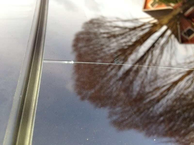

I got my 2011 Premium on 1/3/12, with no issues so far. Today that changed.. Parked the car, went shopping, and as I was walking towards my car, I noticed a footlong crack in the windshield, just to the left of the rear view mirror. It starts up at the top edge of the windshield. NOTHING HAPPENED!! I have no clue where this came from.
Im going to call me dealer tomorrow and see if they're any help at all.
Anyone else been there, done it??

Hey guys. Just come to post something else and figured ill give you the update for whoever this happens to next!
It turned out to be a miniscule rock chip that cracked a couple weeks after the impact. There's an easy way you can tell if it's stress or rock chip: Take a ballpoint pen to the crack. If the tip gets caught up, thats your damage. If it make the the pass cleanly, likely stress.
I got dealer price through a referral to a glass shop here in Seattle where they paid $100 of my deductible, and I used a non-incident claim with State Farm to end up only having to pay $150 out of pocket. Not too bad.
