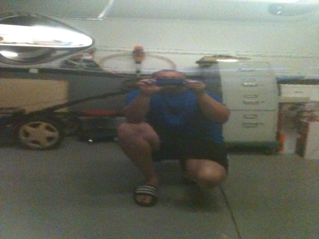

This is why I'm obsessed with black cars, it's so hard to beat the depth you get with black. The swirls left by the dealer's cleaning crew HAD to go. Everything but the wax was applied with a Porter Cable DA. Microfiber towels to remove.
It looks pretty good, but I'm going to have to put my back into the doors a little more.
Here's what I did:
1) Clay Bar all the way around.
2) Meguiar's 83 with Meguiar's yellow pad (WB8006) on the hood and deck lid where the swirls were the worst.
3) Meguiar's 80 with new WB8006 on the hood/deck lid/all other horizontal surfaces.
4) Meguiar's #9 with WB9204 pad all the way around.
5) Meguiar's #7 with new WB9204 pad all the way around.
6) Finally: Meguiar's NXT 2.0 all the way around.
Here's what I did:

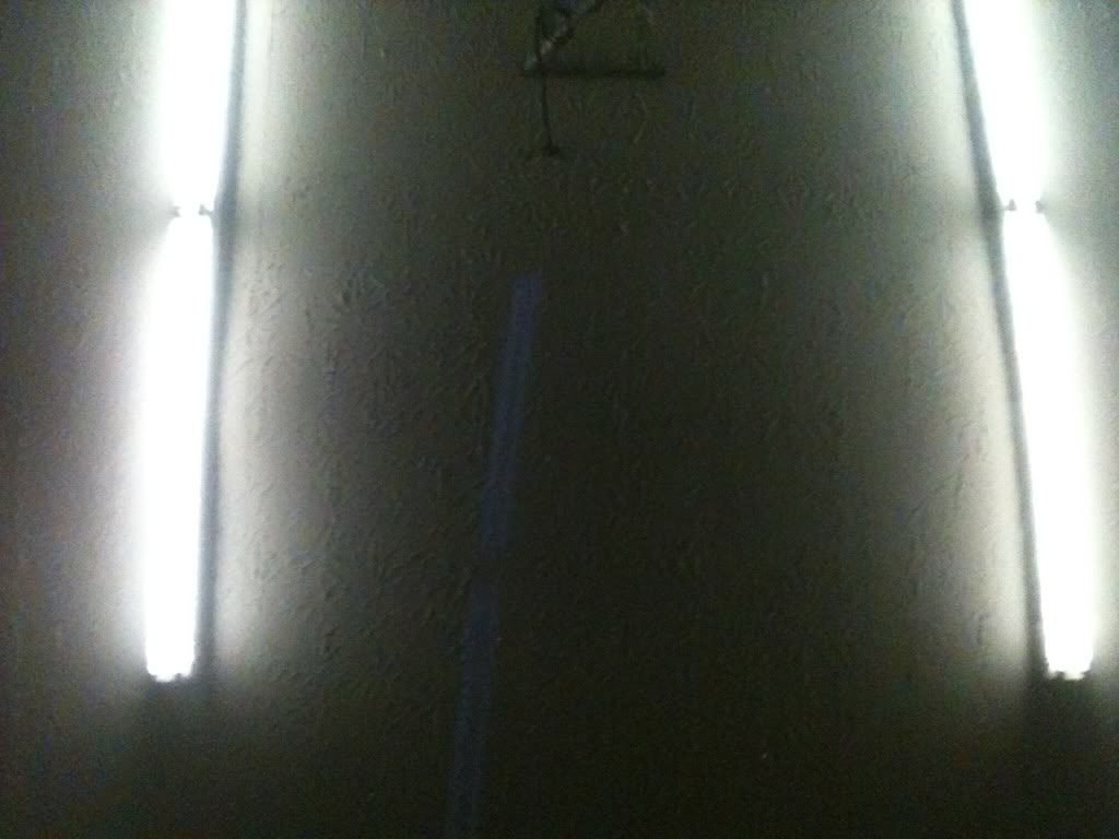

You could have skipped all that and just went with "ULTIMATE Line" from maguiars. Three steps and with the meguiars 6" polisher and your done. Not a scratch to be scene in sunlight or florescent light, or even under direct flash light either.
1. Ultimate Compound
2. Ultimate Polish
3. Ultimate Wax.
Even removes ectched in bird dropping and sap. Best stuff ive ever seen.
the Ultimate wax is way better than the NXT wax.
REFLECTION IN THE HOOD OF THE CEILING IN MY GARAGE.

On your advice, I stopped at Autozone on the way home and picked up Ultimate Compound/Polish/Wax/Detailer.
I think #83 and UC are virtually the same thing except UC doesn't seem to leave the haze you get with #83. I'm going to see what Mike has to say about it on the Meguiar's forum. I also think #9 and UP are close to the same thing. I think I'm going to use the ole' tape trick and compare them side-by-side. What I believe to be true at this point: If you use #83, you really should follow with #80 to remove haze. It looks like UC might be nearly as aggressive as #83 without leaving the haze thereby eliminating the need for #80. If my suspicions are true, I'll stick with this new method for sure, although I still think there's a place in the bucket for #83 to address tough spots. I really wish they'd use the cut meter on the ultimate bottles like they do on the professional line though.
NXT and UW on the other hand--big difference. Unfortunately, I finished working on it late, so I didn't get a chance to see the doors in the sunlight. I re-did the hood while it was still light out and the first thing that struck me was the consistency in color and the ease of removal. UW comes off almost as easily as it goes on. It doesn't stain trim, and the box says it can be applied in direct sunlight; however, I think I'll pass on that test.
Sometimes with NXT after removal, I see darker sections--like the wax bonded better in those sections than the lighter sections. Generally another coat fixes it. I definitely don't see that problem with UW. I did some reading on the Meguiar's forum and they do suggest UW over NXT for darker colors, so I think I'm a convert on the wax for sure. Thanks for the tip!
Sorry for the crappy phone pictures. I recently bought this house and haven't hung the requisite shop lights yet.
