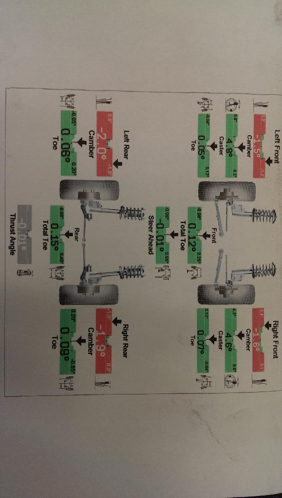

I figured I would try this because my rear diver camber is always -1 to -2. Just to make sure this part on EBay says G35/350z but it fits our car right? lol
Also How hard is this to install yourself or should I just get a shop to do it? I figured I might have to re-aline the suspension again...

My car is lower than Eibachs and I didn't need anything but 2 camber bolts for the front.
But as you can see my car is out of camber spec. Handling wise it's better this way and the wheels are flush.
Also Sorry for the noob question I cant really tell how its off...Are you talking about the front tires are crooked compared to the back wheels? lol

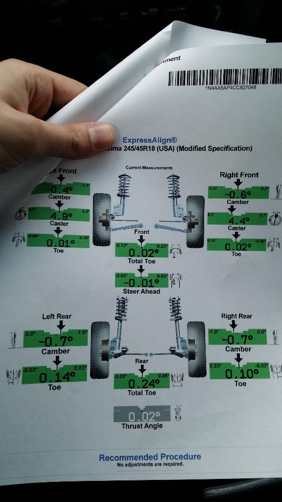

Yeah those will work. I went with ichiba be cause so many members had good results with them. I'm getting mine installed tomorrow!
Question how hard is this to install yourself?

Pretty easy to install but you will need to take a hacksaw and cut about a 1/2" from each threaded rod end or they they won't adjust "in" enough. Then after cutting I used the stock arms as reference for rough setting the new arms before installing.
Also don't forget the front camber bolts. From your readout (in red) you will need them before taking it back in for another alignment

That sounds somewhat difficult lol can I borrow hacksaw??
Got them installed for 100 but they didn't use any of hacksaw or anything?
*EDIT* so you were right lol we had to hacksaw the extra thread. Thanks again man.

2) Sencond the guy got both rear camber's to go 0.7 + on both sides which I didnt believe because I've never seen a perfect camber on my car ( even brand new!)
The car somewhat pulls the right on the highway but not enough to make that much concern. I just worried about my car too much and Im curious if using the stock REAR camber bolts are okay? I didnt touch the front cambers because ive never had an issue with them before.
Had to get that off my chest. Thoughts would be greatly appreciated
Old Apr 9, 2014 | 08:15 AM
Racerbox77's Avatar
Joined: Sep 2012
Posts: 467
I would guess your wheels were dirty in spots or the tread was dirtier in spots giving it the allusion they were warped. Because if you can see that a wheel is wobbly while on the car you would definitely feel it while driving.
Camber can be equaled out and that's always the goal. As far as a pull it most likely something up front that's causing it like camber or road crown.
As far as bolts, if the stock ones looked good it's probably best to reuse them.
