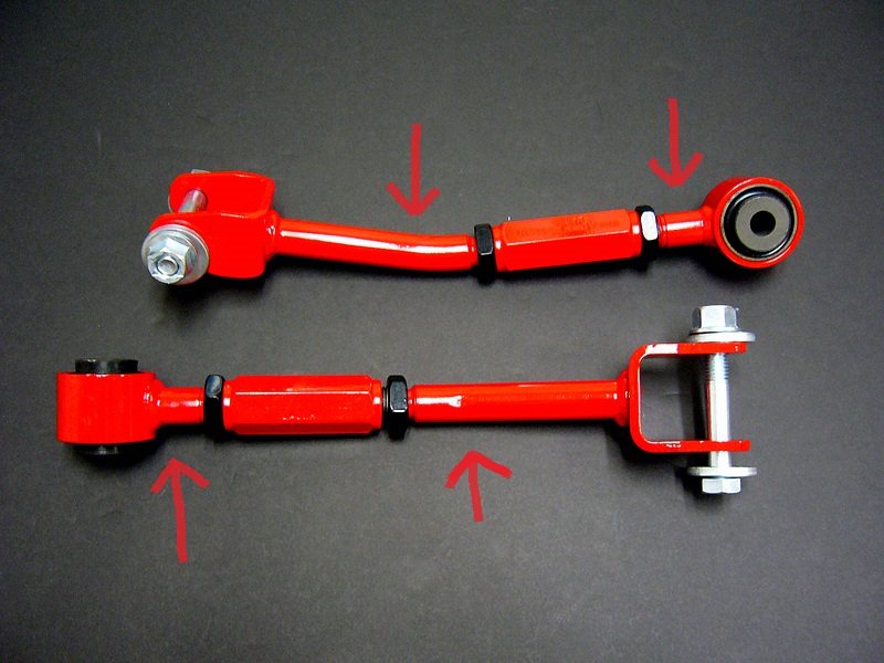

Ghozt, once you take it all apart yes there are 4 parts you take 1/4" off... make sure they rethread or you make sure the threads are still good to reassemble.
Thanks bro! Yeah I'm going to have the nut threaded on there, cut it, and then spin the nut off to clean the threads + file it a bit.

One other question - is it just the Ichiba ones that need to be modified? Do the SPC/Eibach ones need modification as well? They appear to be shorter than the Ichiba ones.

Stock toe's on the rears are the the same as the Ichiba's.....cam (lobe) adjustment dimensions likewise are the same.
I kept the stock because they are a beefier bolt.

Just ordered the SPC 350z Camber Arms. Do these need to be modified like the Ichibas? I understand the eyelet for the toe bolt will likely need to be widened using the provided template. Just not clear on the arms themselves, if they need to be cut or not, etc. Thanks!

They don't, just the toe bolt eyelet. I went with SPC in the end, read some crap about the Ichiba's breaking on the 350z forums.
Really? I haven't heard anything bad about them, I have no issues with mine the ones I got looks and felt really durable when I got them, got a link?

It's not just this specific unit either
http://my350z.com/forum/brakes-and-s...eck-yours.html
http://g35driver.com/forums/brakes-s...killed-me.html
http://www.myg37.com/forums/brakes-a...lly-break.html
The Ichiba control arms are poorly made. I had the front and rear Ichiba arms (with toe bolts) on my G35 coupe. The rear arms will seize after awhile and can't be adjusted. And the ball joint in the front arms will get stuck in the spindle upon removal. Which required me to use a blow torch and a lot of force to remove. They are also prone to rusting. When I lower my Max, I will be using SPC arms since I have nothing good to say about the Ichiba arms.
Yeah since the price difference is about $40 I figured this was an easy choice after I did more research. Kinda glad now that when I ordered the Ichiba's the dumb@sses sent me the wrong part so I just returned what they sent and got the SPC ones. I came across this info initially while looking on Youtube for install videos on the camber arms and came across one where a guy was replacing his Ichiba's with the SPC's due to greater adjustability + as he also mentioned the Ichiba's were known to break. That's when I dug in deeper and found lots of threads about it.

Not sure if I completely understand the issue with Ichiba. The wheel spacers they sell seem to be of very high quality yet the reported front and rear arm failures are disturbing to say the least.
Does anyone know if Ichiba ever responded publicly about these issues?
I was under the car today while doing a complete brake fluid change and did the normal look around at the underside of the car including the rear arms and all looks well.
After reading these reported failures I will be removing the arms to do a full inspection.

+alignment, the owner of the shop said they'd just charge me the hourly rate. Took two hours. $270 total.
But you know. They say everything's cheaper on the mainland.
So I'd expect about $150-200. They didn't have to cut the two bolt eyelet though, so if your car is lower than eibachs, it'll take longer and likely cost you more as they'd need to cut them to get the camber in spec.

People need to realize that camber doesn't shred tires, does it affect the way the tire wears? Yes! Does it wear your tires more? if its a minor camber its barely noticeable, an extreme camber will wear tires more and so on and so on.
TOE <--- This will kill tires!!! Get your toe adjusted within spec and you should be good with a minor camber issue, but me? I am picky and rather have everything within spec...
