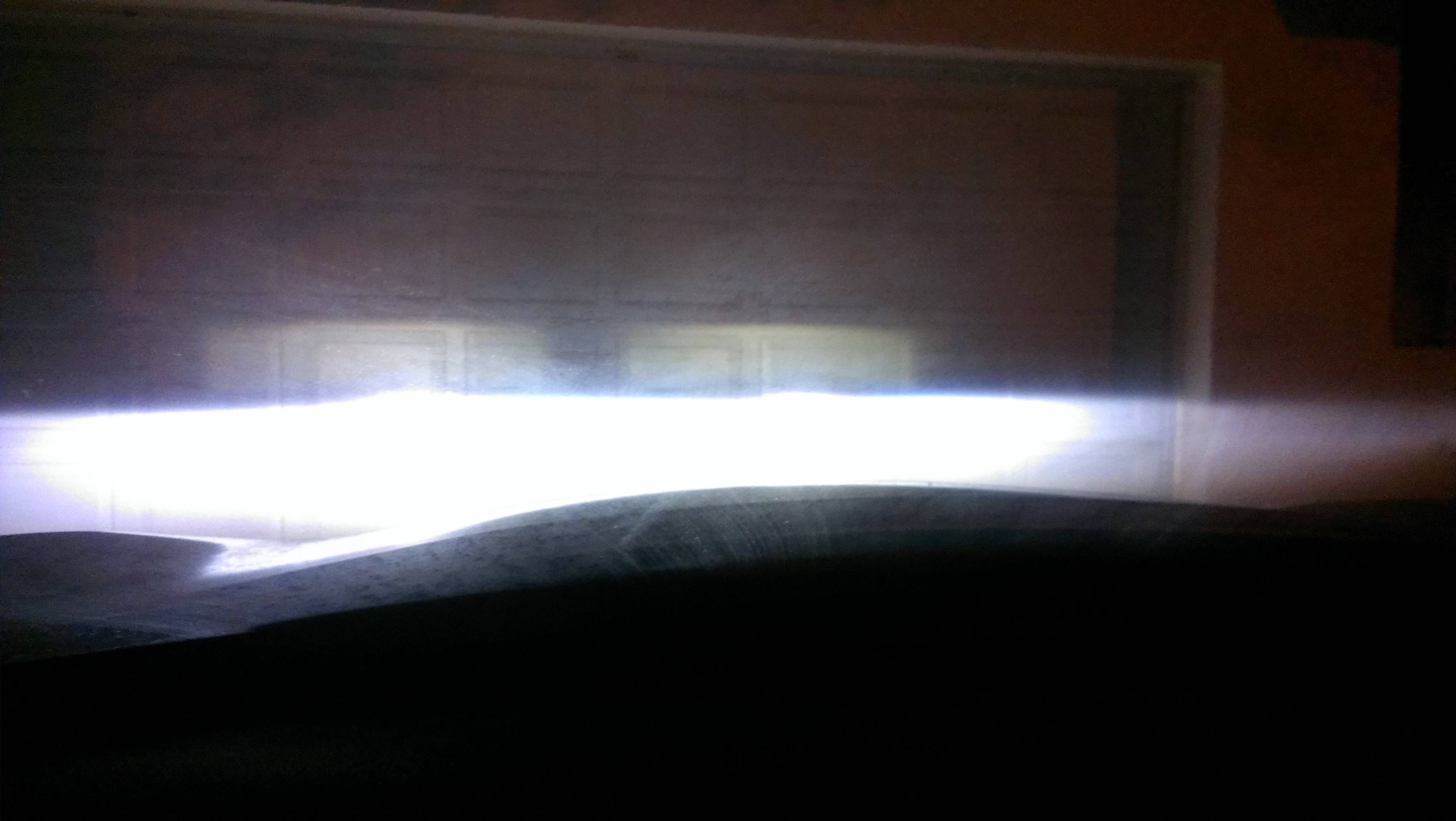

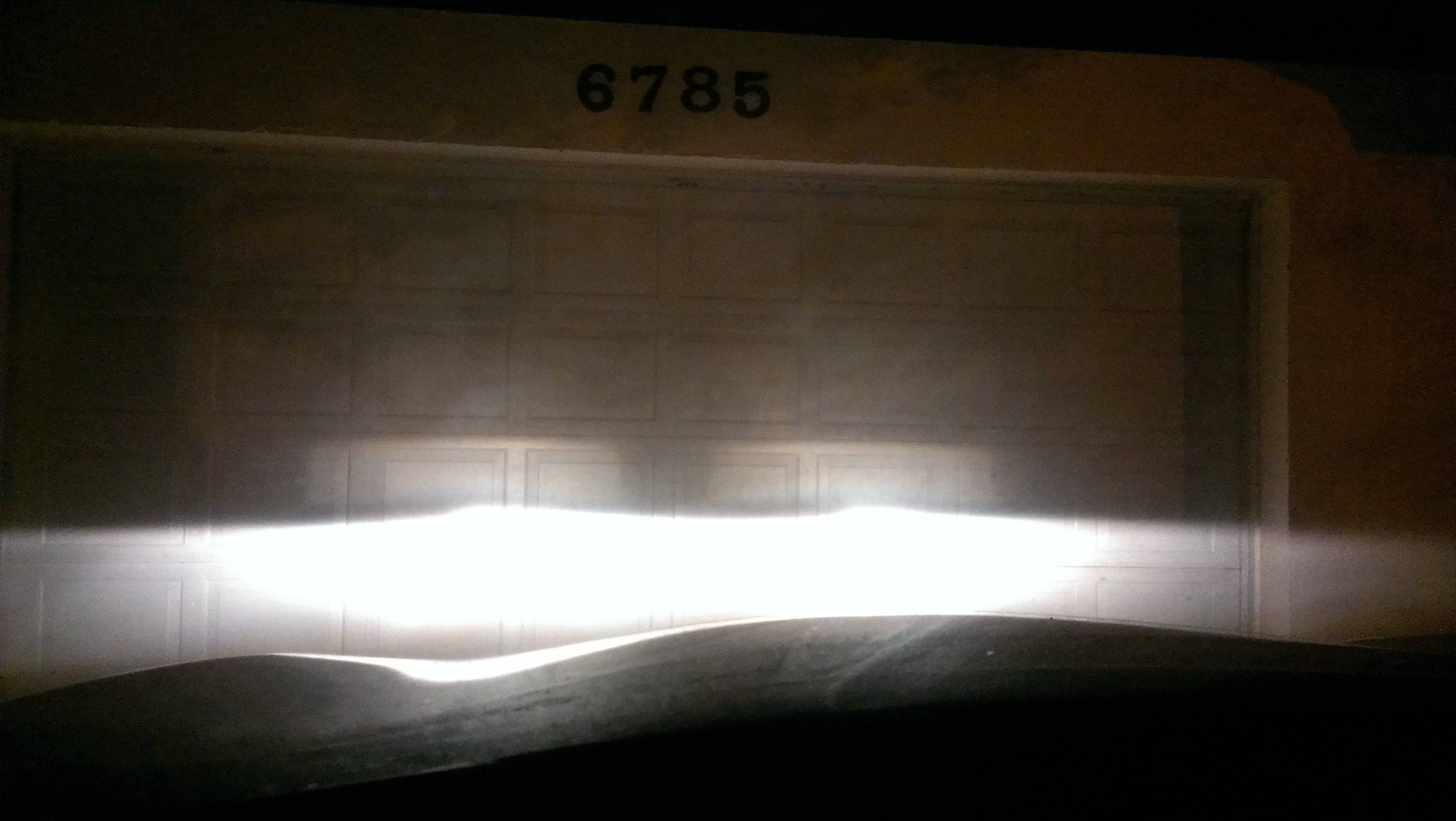

Did the install by popping open the fender liner, but not completely removing it. Mounted the ballasts and relays up top and hid the cables under the panels that the maxima has in the engine bay. I ended up buying the Morimoto H11 kit with 5000k bulbs. The relay was kinda confusing, but the image here cleared it up: http://www.mydepots.com/ebay_images/...ay-harness.jpg
BEFORE:
AFTER:

Wow man just posted to see what I would get told also, I like the way they came out!! NICE, so was it hard? Where do you mount the ballast? Does it look blue like the Infiniti lights?

If you open your hood and try to look at where your headlights are, there is a bar that goes down the side of your engine bay that your headlights sit behind. I mounted the ballasts on this rail. I had the help of a friend, and it wasn't so bad. Just popped open the fender liner (all held by those plastic push screws) and reached in and did it. My friend has experience doing it so he could take out/put in the bulbs without looking.
