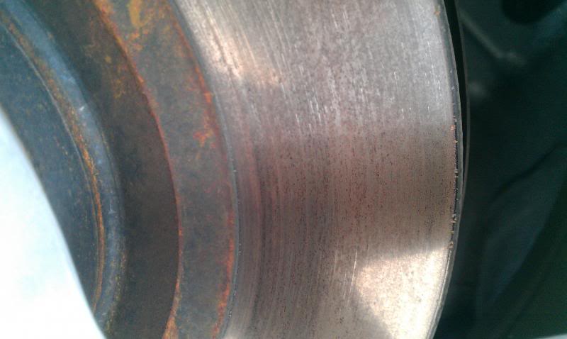

2011, I notice today that the brake pads are only making contact with about 80% of the usable surface area.
Is this normal for other max or do I have an issue?
I will take a pic in the morning.

If a little rust is showing in the inner area of the rotor, then that sounds about right.

samething mine does seems normal

Just trying to figure out why the brakes sometimes seem to wobble/pulse but not consistent.

The inconsistency you describe is unusual. The more normal situation is either smooth braking or a consistent wobble/pulsing.
It has been my experience that the most common cause of the wobble/pulse syndrome during braking is a slight (or worse) warping of the rotor(s).
If the rotors on your car have never been 'turned' (put through a machine that removes any portion of the rotor surface sticking out above other areas), then a simple turning of the rotors often eliminates this wobble/pulse.
But rotors can only be turned a few times (sometimes only once) before the thickness of the rotor drops below the minimum allowed, and the rotors must be replaced.
But if your wobble/pulsing is not consistent, it may be time to have your dealer check your system and rotors before doing any 'turning' of the rotors. Let us know if you find the cause of this inconsistency.
HERE IS A THOUGHT:
Contrary to normal assumption, during any particular stop, the pads in Nissan's braking system do NOT cover the entire 80% of the rotor that looks used. The pads actually shift to a different portion of the rotor each time we brake.
This pad-shifting process has resulted in a popping noise in some 7th gens here when inadequate lubrication resulted in the pads having difficulty moving to a different area of the rotor for this paticular braking application.
Could it be possible that this problem is a result of Nissan's braking system where the pads are shifted during each braking application, resulting in coming into contact with a different portion of the rotors during subsequent braking applications?
Maybe only a portion of your rotor is warped, and that portion gets used only part of the time?
