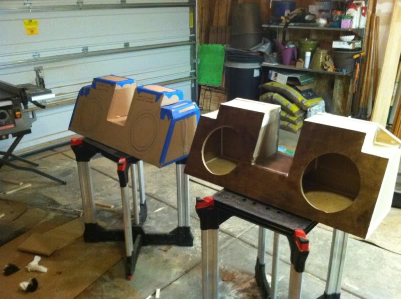

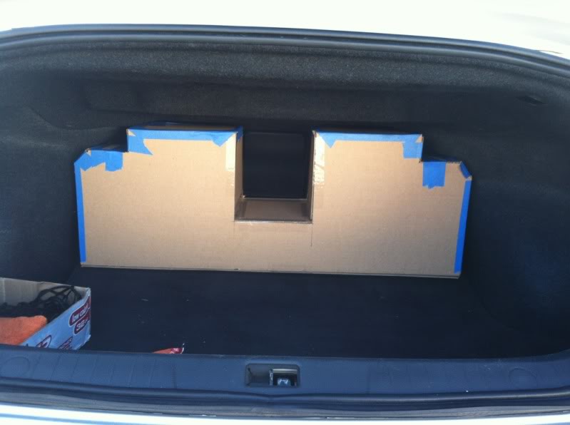

First, I built a sub box out of cardboard in order to get sizes worked out.

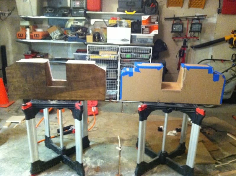

Then, I used the cardboard as a basic template for my measurements.
I designed the box so that it is only 12" deep, and sits on the raised portion at the rear of the trunk. It has the 'U' so that the pass through is still usable for long items.
The subs actually face the rear seat. There is a chance that I will lose a little output, but the subs won't get damaged by hauling crap around in the trunk.
I built this box out of birch ply, and stained it to match the wood trim in the cabin instead of carpeting the whole thing.

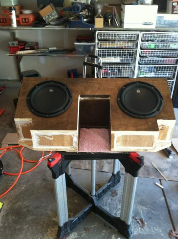

So, I finished the box with two coats of stain, then 4 coats of clear with sanding in between each coat.

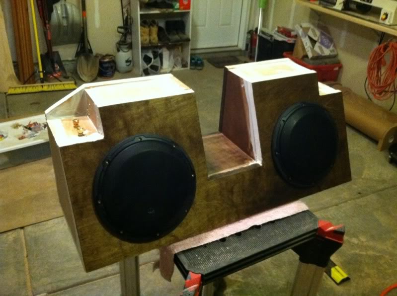

I mocked the subs:

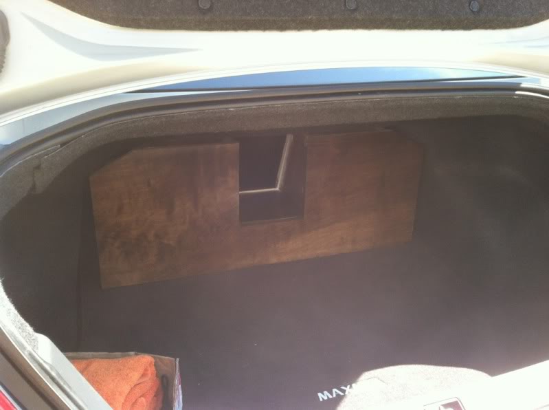

And this is what the box looks like in the car: I will be painting the sealer that is visible a brown color. Next time I'll use a brown caulk on all the edges for a stained box.
