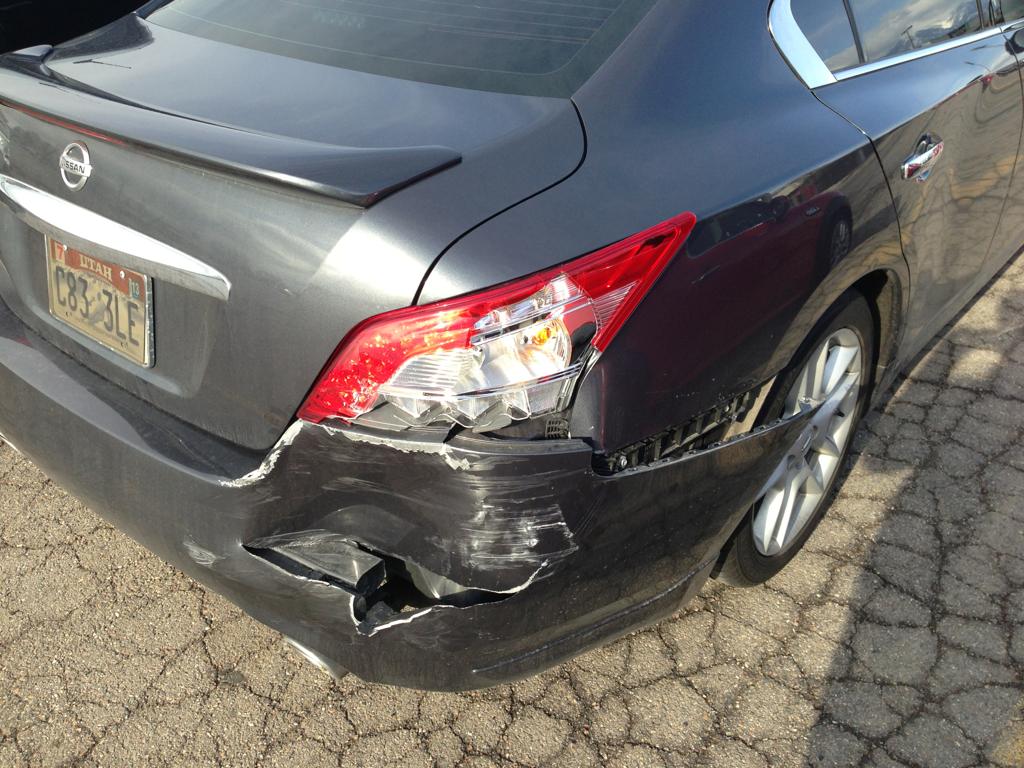

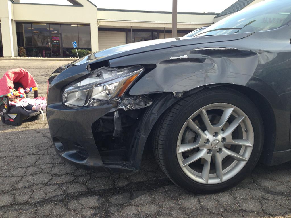

It's been a little while now, but I want to share the story of my accident. 4/16/2013 I was rear ended on my way to work. Big full size Chevy one ton (with a full bed, and a roof rack overloaded to boot) couldn't slow down in time. We were on the freeway, all cars slowing down (it was rush hour), but this Chevy couldn't stop fast enough. I watched it all happen. People sometimes say that accidents happen so fast that they don't know what hit them, but for me it was like slow motion. Problem was that there was nowhere for me to go to avoid being hit. I was boxed in by the other cars. At the last moment I cut my wheel left and rolled forward a bit so the impact wouldn't sandwich me between the Chevy and the other full size truck in front of me. So, he hit me in the right rear corner, and pushed my front left corner into another car. Here's the damage:
I was glad I turned my car away in the manner I did, it definitely lessened the impact and damage. No injuries to any of the passengers in any of the 3 cars, so things could've been a lot worse. Almost one month later, and I should finally have my car back on Monday. Been hating my rental car (Ford Edge). I called my dealership and asked where they get body work done, and so that's where I ended up taking my car. Was pretty excited to see some elite cars there being worked on like a Ferrari, a couple Porsches, a GTR, and a few others. I feel Iike they've been slow as molasses, but I'm crossing my fingers that they were thorough and did everything right. Luckily the other guys' insurance is covering everything. The quote they gave me was almost $8k. Wish me luck on Monday! I'm gonna cry if it doesn't feel as good as it was before!

I don't see anything that should affect your tires, wheels, alignment, etc ,so your car should ride exactly the same as before.. The trunk lid still lines up nicely with the rear window and the side panel.
Be sure to check every single electrical function on both the front left and right right. High beam, low beam, fogs, turn signals, brake lights (including the high mounted one), parking lights, etc.
Open and close the hood and trunk several times, making sure they work exactly right, and are in perfect alignment. Check the right rear and driver's doors carefully. Look at the alignment between the bottom edge of the trunk lid and the top of the rear bumper. This has been a problem area for several here who had repairs made.
Make sure all dash warning lights work properly at startup, and all go off fairly quickly.
Pick the car up on a bright day, in order to confirm all paintwork is smooth and even and matches exactly.
You may end up with a car just as good as you had before the accident.

Thanks guys. Light--there were some marks on the front left rim that weren't there before, so I'm having them check the alignment to be sure it's ok. And thanks for the list of areas to pay special attention to.
