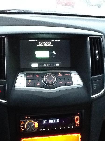

Old Jun 3, 2013 | 02:28 PM
Big$am's Avatar
Joined: Mar 2013
7" display swap out
Attachment 4171My add on, I moved my ax display to under my head unit didn't want to play the guessing game with air temp or put it in the glove box like some ppl< 😰
Big$am, what method did you use to attach the tablet to the console? Also, how did you align it?
Thanks.
Old Jun 4, 2013 | 11:33 AM
Quinn'sMax's Avatar
Joined: Aug 2009
Posts: 179
From: Houston
Just use double sided tape. You can simply take the top piece in one hand and take the screen in the other and align it up until it looks centered.
Old Jun 4, 2013 | 07:33 PM
tiger2380's Avatar
Posts: 78
Cool, I didn't think of that. I used the blue tape that use for painting and crazy glue. I taped the blue tape onto my tablet, put crazy glue on it and glued the tablet to the back on the console. I was just wondering how other people did it.
Thanks.
