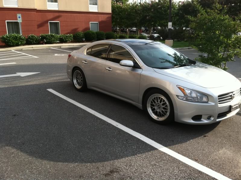

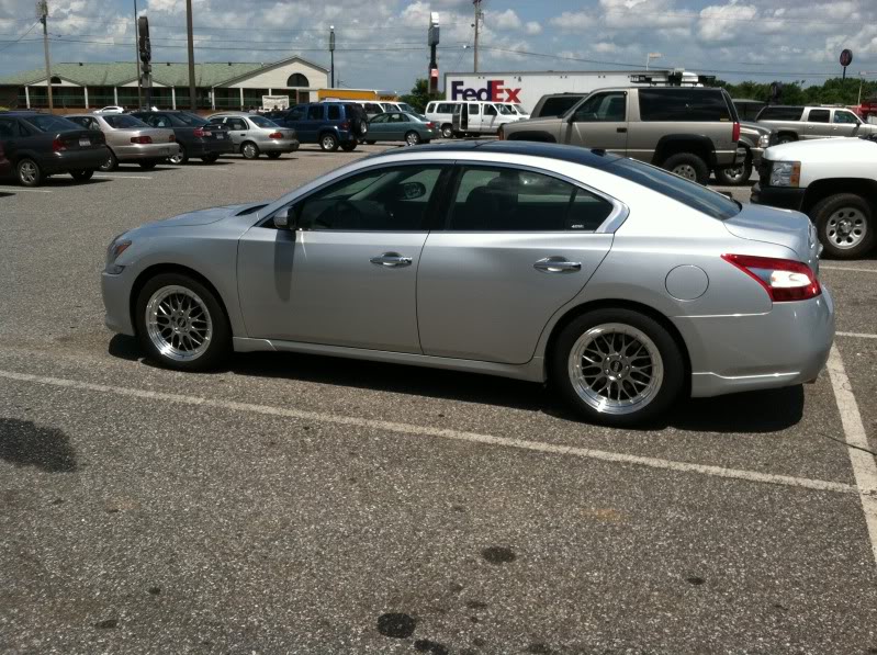

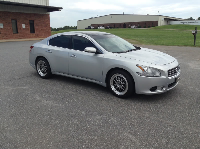

I finally got around to doing a few modifications to the car. I drive 45k miles or more each year for work, so I won't do anything major.
A couple weeks ago I put on a home brew exhaust. Magnaflow mufflers and a 2.5" high flow resonator.
This week I put the new wheels on. They are BBS LM replicas w/ hyper silver faces, and DWS tires. The rears are a stepped lip.
18x8 et35 front w/ 245/45/18 tire (factory size)
18x9 et35 rear w/ 275/40/18 tire (same diameter)
The fronts are 21lbs per wheel, and the rears are 24lbs each. The factory wheel is ~21lbs.
They sit absolutely flush in the rear. The sidewall of the tire might stick out about 2mm from the fender when looking for plumb.

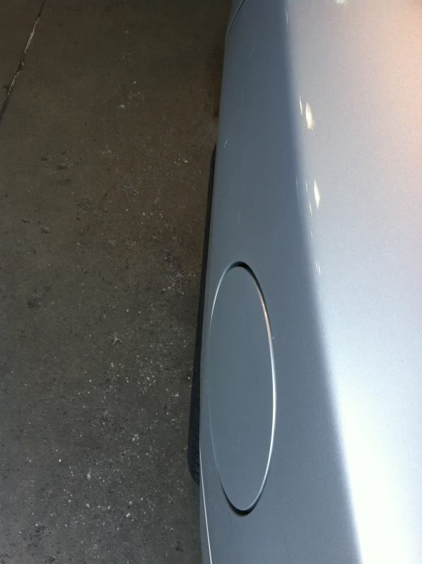

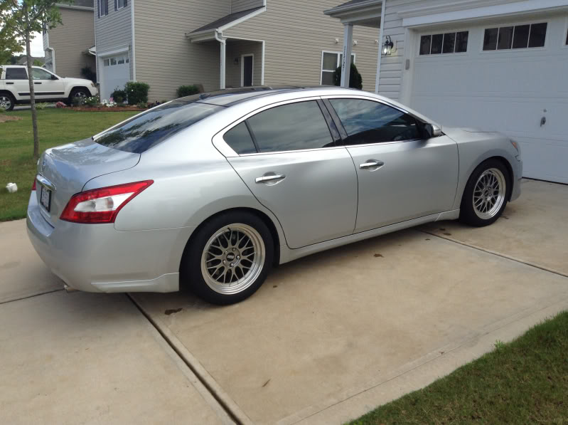

I had to lean out a little for the sidewall to actually show up.

For 18's they look good, color matches the car great and you have the flush fit.
You also got a low weight wheels which is a plus. I see a lot of people that will go with 20's (which do look great on this car) but they are often adding another 10+ pounds of unsprung weight to each wheel.
Once you drop it you'll like the look....they will also look better in person than when posting pic's. The main reason I kept my 18's was because they do look pretty good on the Eibach drop plus I'm still wearing out the stock RSA's. I'm planning to go to 19's sometime in the near future.

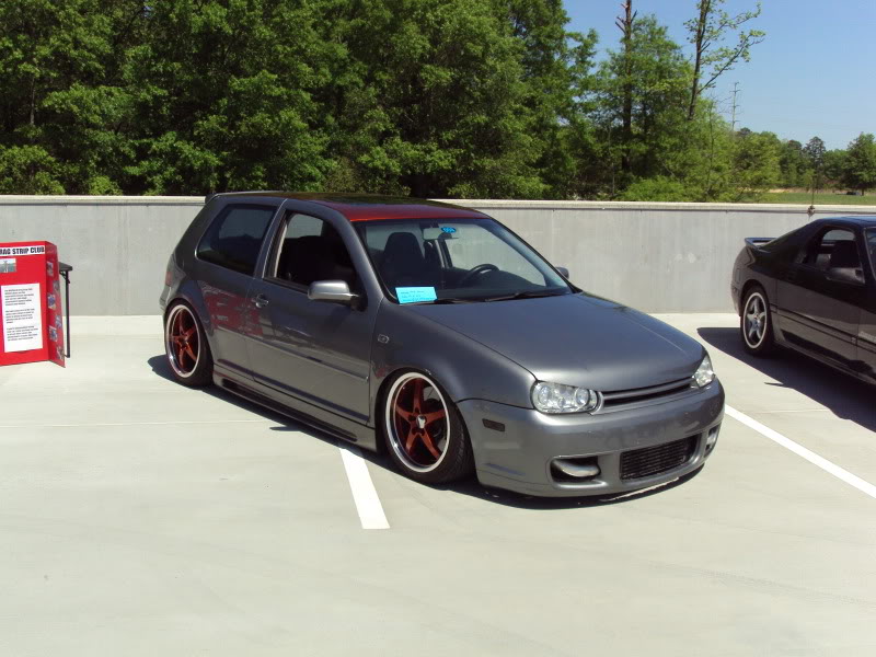

I'm not new to wheels and the auto world. Had a twin turbo 91 Maxima, and one of the most modified VW GTIs in the country.

I raced a modded GTI just a day or two ago. He had me on the jump but I was ahead of him immediately after. He must have been a touch slow shifting to second. I held him off by 1-2 car lengths all the way up to 90 mph, then he slowly crept up till about 105 where we were even, then we both let off.
Pretty sure he wasn't expecting that as his car was (at least on the exterior) heavily modded. I had a little bit of a proud smirk on my face as we gave each other a thumbs up afterwards.
Can those GTI's be pretty quick when done right? I wasn't sure who was gonna come out ahead when we raced.

Haha, mine was a built motor, built trans w/ limited slip, big turbo, and bagged.
0-60 in 5 seconds, 1/4 in 12.x, and would spin tires through 3rd gear.
I would break traction at 90mph. The top speed was 175. (On street tires)
I would take corvettes on occasion, drag strip of course.
This is a commuter car. I can't, and don't want to modify it that much.
Y-pipe and Eibachs and I will be done.

That looks really good! Shoot a couple more close ups of the wheels and especially the back lips.

Those tires look extra thick.. is the ride softer?

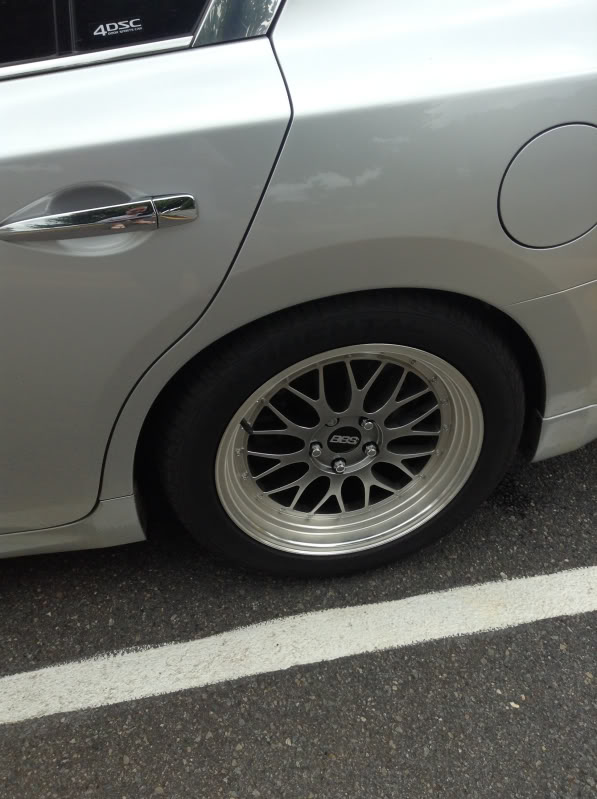

The tires are factory sizes in the front, and plus sized in width, but keep the factory sidewall height.
245 x .45 = 110.25mm
275 x .40 = 110 mm
The ride is the exact same as before.
The wheels look smaller because the face is only 15", and the lip makes up the other 3". This also makes the tires look bigger.

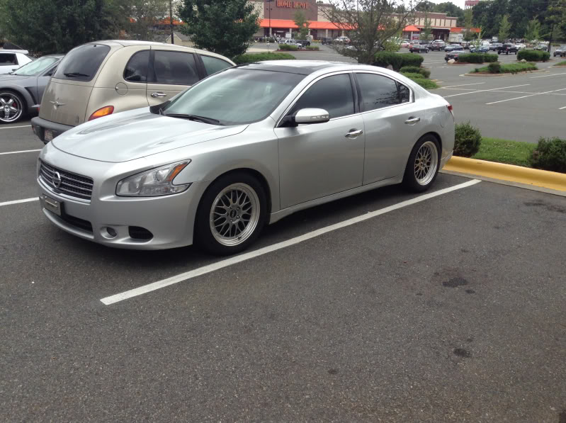

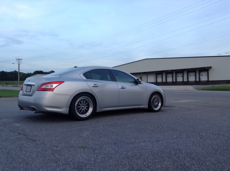

Lowered it today. Took about 3.5 hours with basic hand tools. The crappy rented spring compressors is what took all the time. Went from a 3.5 finger gap to a 1.5 finger gap.
I had called a couple shops around me for price quotes, and they were all around $300.
For that money, time to do it myself. I have an alignment in the morning, though based on my test drive, I don't need it. The ride is stiffer, but more toward the sports car side, not race car.
I'll get another picture tomorrow, on level ground.

Looking good! Lowering makes it look so much better.

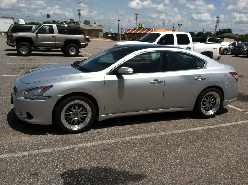

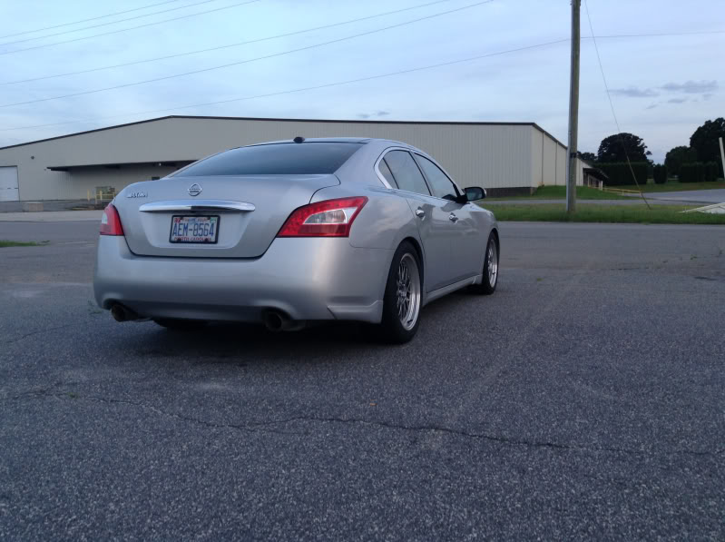

I'm getting a clunk now. Checked all the top bolts, will check the lower later. I'm thinking that it is the away bar bolts.

Bumps, turning between 5 and 20mph.
I know the lower strut tower bolts are tight, as well as the top bolts. The only other bolts are the sway bar end links. These are non-captured, and difficult to tighten up.

-2 degrees in the back will rub the insides out in due time. I recommend installing the camber arms with toe bolts to get everything back in perfect spec

You may need to roll your rear fenders a bit to get rid of that bump.

The noise has nothing to do with the fenders.

Unfortunately I agree with BBMax. These 18's look smaller than the stock 18's and if ur having any rubbing issues requiring fender rolling u ha e either bought the wrong offset and/or tire size. I'm lowered on 22's with eibach springs, camber and toe bolts and I have no rub at all! To each their own but u posted so u can expect opinions from both sides of the fence.

How many times do I have to say that I AM NOT RUBBING. FENDER ROLLING is NOT needed.
They look smaller than stock 18s because of the way proportion of the face to the lip of the wheel.
