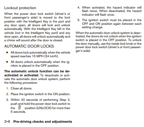

Originally Posted by dr_2010SV
Yes, it's in your owners manual. Take some time and look it up.
The owner's manual makes no mention of how to get the vehicle to unlock the vehicle when the transmission is put into Park. It only mentions that the doors can be unlocked when the ignition is in the OFF position, and how to deactivate or (re)activate this feature.
Playing devil's advocate here and I have found that this feature is safer despite my previous car unlocking automatically when put into Park. You never know who was scoping you out after you've parked or while you were distracted.

Originally Posted by xbenbendx
Well I got a 2013 Maxima S and I love it but I hate what when my car goes over about 20mph and locks I cant shift my car to park for it to unlock. Is there a way I can program it to unlock when I shift to park rather than turning my ignition off? Thanks guys!
There is a way to program the Park to unlock feature but it has to be done at the dealer with a laptop.

As Johnnyru mentioned, you have to go to the dealer and ask them to change this setting using their Consult 3. I did it a while back and the dealership didn't give me any problems. After the reprogram, i also noticed that i only needed to press the unlock button on the door handle once to unlock all doors... i believe the default setting is once to unlock that door and again to unlock all doors.
