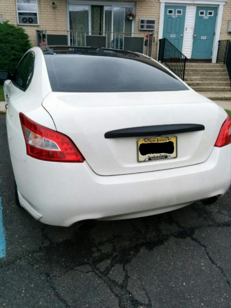

In the end, flat/satin black seems to look really nice on the chrome window trim and trunk trim. Originally I had wanted a black chrome/polished gunmetal look, but it seems that's almost too hard to obtain/do. I decided I wanted something more permanent and less sticky than plastidip, and vinyl isn't my favorite either, so I ended up using SEM trim black on everything. Loving it.
I have a winter frost white. It'd look good on yours too. I just hate the look of chrome lately. Debating getting my door handles color-matched, but I'll probably leave them for now.
