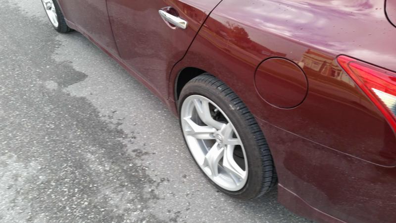

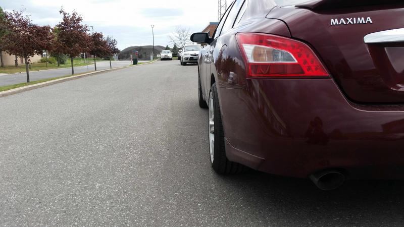

I like the way it looks. I bought a set of 370z rims and put them on earlier this year. I kept the spacing stock. When I have time I will post a pic.

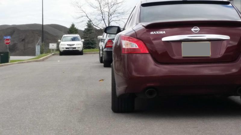

can you post a low rear ground shot, so we can see from the back end. what size tires are you running as well. would be great to get some 275-295 on the rear with the wide fenders.

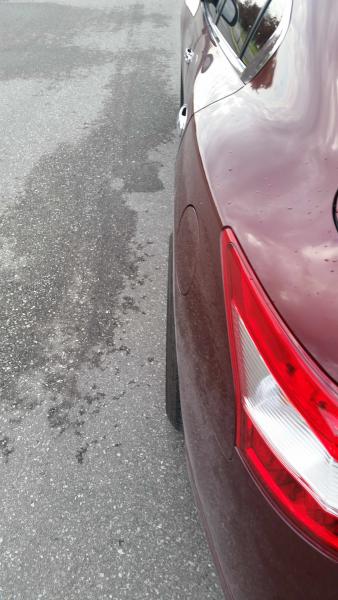

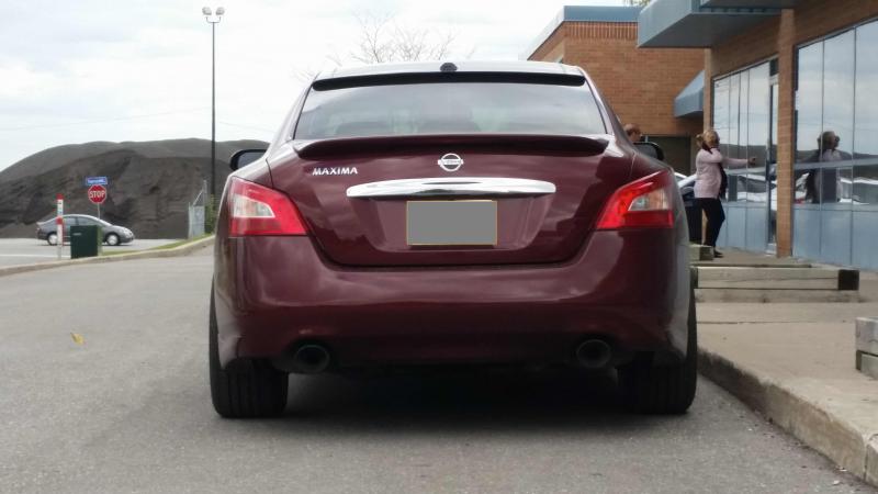

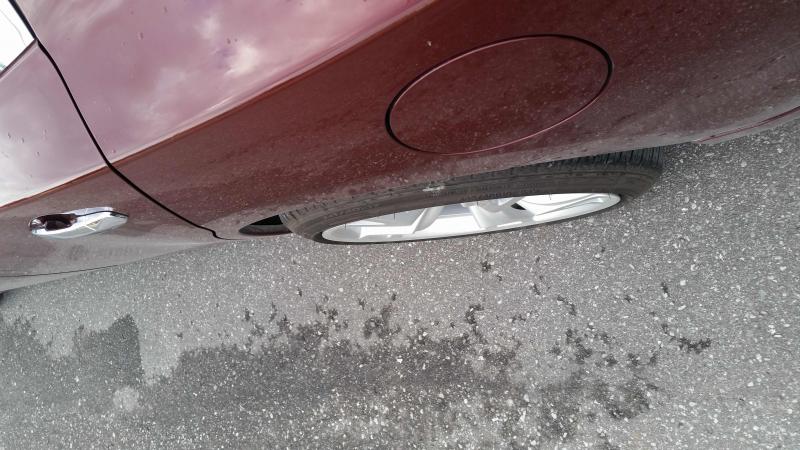

I am running Michelin MXM4 245/45/19s all around. The rears are stretched a little and no one really notices or cares. The only deals I found were for a set of four and finding tires of the same brand with different widths for these rims was impossible. Tires are expensive in Canada so I took whatever deal I could find.
You will have to check other threads but anything wider than 255 will rub if I'm not mistaken.

thanks for the pics. just what I wanted to see. looks good , would look even better with a wider tire. understand the cost issue. I have not researched the wider tire yet. but do not want any rubbing.
